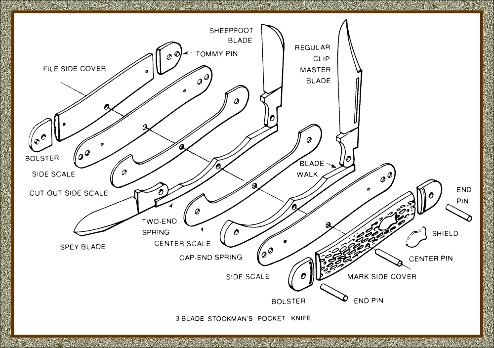

Some explanations from Eric at CSC.
Just an FYI, when I referred to "scale" I was referring to the liners. Scales and liners mean basically the same thing in the knife industry, handles are generally referred to as covers. I think at some point in the past there was a bit of a mix-up in collector terminology due to the fact that you can also put it another way by saying that the scales are what binds either side of the knife tang. This is why the covers on fixed blade hunting knives that are actually pinned to the tang (such as stag) are also referred to as scales. Nowadays many folks refer to pocket knife covers as scales, but if you were to go into any knife factory and ask what kind of "scales" they put on their trappers, you'd likely be met with a puzzled look and handed a pair of trapper liners :)
I hope I didn't just make things more confusing.
Eric
....Those are fantastic covers (not scales, scales are the liners, I REALLY wish people would stop calling the covers "scales" ;))
