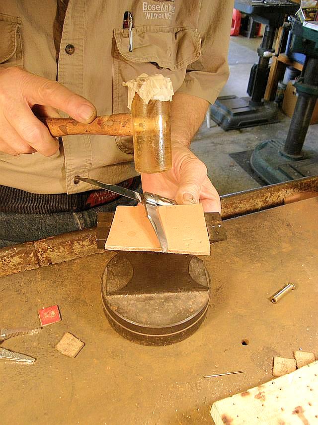

Enaray got it right, wrap the bolster in rags, set it on an anvil and give the bolster a few wangos with the hammer. I've done this several times and it works great.

I tried this once on a boker that has excess play, just light taps but the pin started coming through the bolster. It was visibly noticeable and I could feel it sticking up with my hand, pretty much ruined that knife for me. I would be cautious about doing this on a knife that holds value in its appearance.

That happened with me once on a German Eye stockman with a sloppy main blade. Even worse was that it was only a temporary solution. After a while the knife developed play again.

If it has play. Set the back bolster on a block of wood and lightly peen the top bolster until you get it like you want it; flipping it ever couple of taps. Taps may need to get heavier if required. Once you get it the way you want it; re-peen any pin that is showing and get it back semi-smooth with the cratex wheel. Then put the factory shine back on it with the buffing wheel.
If it is tight. Open the slow blade all the way and put the butter knife blade between the blade and liner wherein it (the butter knife) will be pinched at the base of the blade when you attempt to close the blade. Then slowly, and with constant checking, force the blade toward the closed position. This will pinch the butter knife and force space into the joint itself. Once you get it the way you want it; semi-smooth with the cratex wheel. Then put the factory shine back on it with the buffing wheel.

PS. I thought you all might like to see how to introduce blade play into your very own slip joint. If it seems to be going a little slow....use a bigger hammer. :D This is actually one way to slacken the liner pressure against the tang.

Kerry, That pic explains it perfectly. But why the tape on the other end of the mallet ?

That's a bubba tape dispenser :D Honestly I have no idea.

The tape on the other end on the mallet, is there so when the mallet after several blows and nothings happening, it get one helluva blow and bounces" b-o-i-n-g" you guessed it right between the eyes...:eek::D

Great Photo and explanation.! Hmmm by looking at the left thumb of ..whoever is in that picture... It looks like maybe that left thumb nail felt the benefits of a "little tap"! :D If I keep yabbing, I'll Never get one of those things from Tony! ;)
