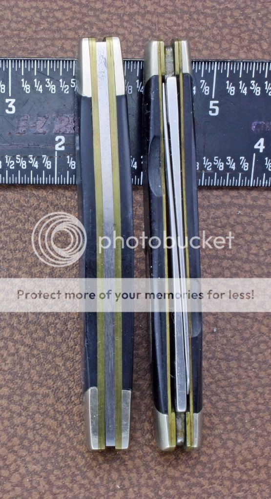

Here are a couple more pictures to help illustrate the cut out of the side center scale.
- Christian

Thank you Christian!
I think I would rather have a custom made by a pro like Ken or just stick with a 3 spring stockman.
Roland, a catch bit is a whole different animal from a cut scale. A catch bit is a small wedge shaped piece whose thickness, along with the thickness of the corresponding blade tang next to it, match the thickness of the spring. A catch piece needs the spring to catch on to to prevent it from spinning when the blade next to it is open. The purpose of this piece is to allow, as Christian stated, the blades to be longer. The tips can drop in along side the opposite blade's tang. In the case of a muskrat, with one on either end, it also allows for a thinner knife than one with two springs since the catch piece is much thinner than the blade tangs. The beauty of a catch piece is that it only affects one end of the knife, where a cut scale adds the same thickness all the way through. A great example of this is the Ken Erickson knife posted by Jake on page 1. Youv'e got a fat tanged master blade on one end with a thin tanged pen on the other, with the catch piece making up the difference in thickness, AND allowing for a longer master. Man I hope THAT makes sense, my head's spinning just typing it! All the cut scale does is allow more room for normal length blades to drop in while making for a wider knife. This was pretty popular with the later scout knives since they had all those bulky screwdrivers, etc to fit into knives whose center cut scales were growing thinner by the year. For a stockman it just seems like the lazy way out. You can gain just as much room by properly swedging the blades and offsetting the shoulders, but of course that takes extra time. Here are a few pictures to go along with Christian's excellent shots:

Well, This is one of those details we love to discuss. I am sure a industry wide committee was formed in the early 1800s to clarify the nomeclature. BUT, I don't think so.......You guys have covered the subject well with the available info. I will not argue with the call of the cut-out metal liner being called the 'side center scale'. BUT AGAIN, When I write about it I call it a 'secondary spacer' or a 'cut-out liner'. To me a scale is the outside of a folder, something bone, stag, wood or other substance. The metal is the 'liner'. A piece of metal without a scale attached is a 'cut-out liner' or a 'spacer'. So you will see me use spacer or cut-out liner or even just plain 'double liners' and you can figure out if they are cut-out. Usually or likely I would call it a spacer, because thats what it does, it give space to fit two or more blades into a spot thats too small. The scale is always gonna be what touches my flesh.....as far as Buck folders of my world go the discussion is limited to the older knives. The ones in the center are 'center spacers'. Later two spring models eliminated the 'spacer' by making one spring wider than the other increasing blade well space. Then the center liner was the 'cut-out spacer'.
Begining in 1990ish the Buck factory eliminated the worry of the description when they went to three springs and straight un-crinked blades........300
Camillus contract made Buck 313 Muskrat, one spring, two liners and two spacers. (my definitions). And two scales, the black stuff on the outside of the brass.. (Discontinued in late 80s)
