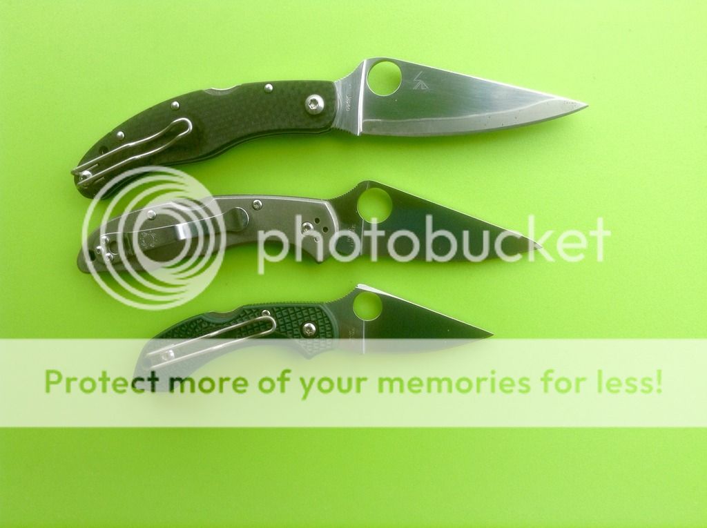

I don't like finger choils , and even went to the extent of altering my Caly 3.5 to get rid of the finger choil lump on the handles scales .
Finger choils on smaller handled knives lock you into how you grasp the knife and are often uncomfortable when holding and using the knife in any way other than the traditional grip .
Leave the Delica alone to grow old gracefully :)
Here is a pic of my altered Caly beside my Delica , you can see how removing the finger lump has opened up the size of the handle and allows much greater options of how it is grasped .
Ken

Does my photo not prove that loss of cutting edge is not required for all designs?
