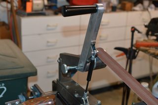

JG, You may to try to install a gas piston for tension on your KMG and buy a 4 inch tracking (idler wheel) wheel from Jackstraw on Ebay. These two things smoothed out my KMG . I use a 40 pound gas piston. My Kmg now runs smooth and with little vibration. I also have a direct drive grinder that is smooth an quiet but I prefer to work with my KMG. Just my opinion. Larry P.S. The first photo here shows the grinder with a stock tracking wheel and not the new 4 inch tracking wheel. LL
mg]http://i.imgur.com/ghDPcl6m.jpg[/img]
