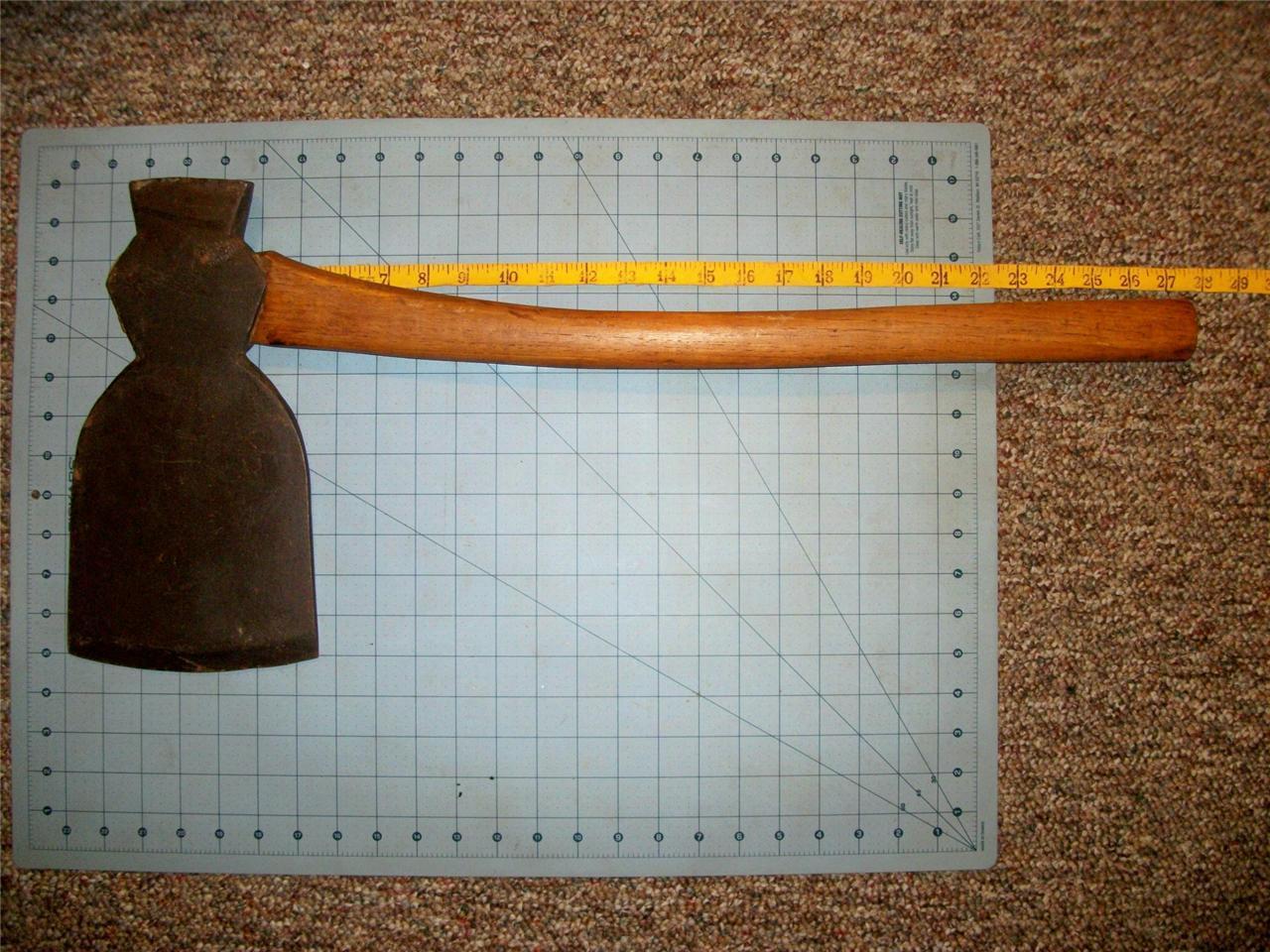

You can see hammer marks around the bevels on the sides of the bit. I think it’s hand forged. Would I be right in this assumption?
That's a sweet broad axe there. Probably a forge welded hardened poll.
Those look like the same style of stamps and the same random placement. I bet yours is a Douglas too.
It could have started with a pre-form shaped like this.
The inner dashed lines represent the poll. The lugs are drawn up as you suggest. The outer dashed lines indicate the start of forge welded section. After welding this section would be drawn out flat.
I have to preface this by admitting that I'm not familiar with early forging work. I don't doubt there's a simpler way than I just described. I'd like to hear more about the way you think this was created.
