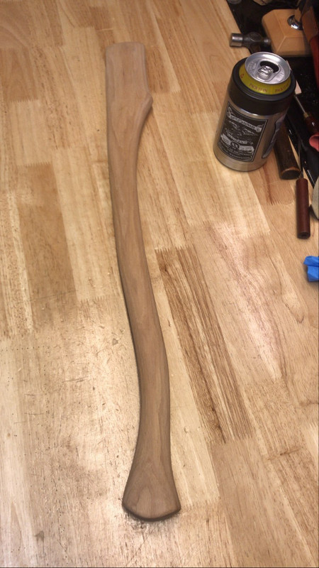

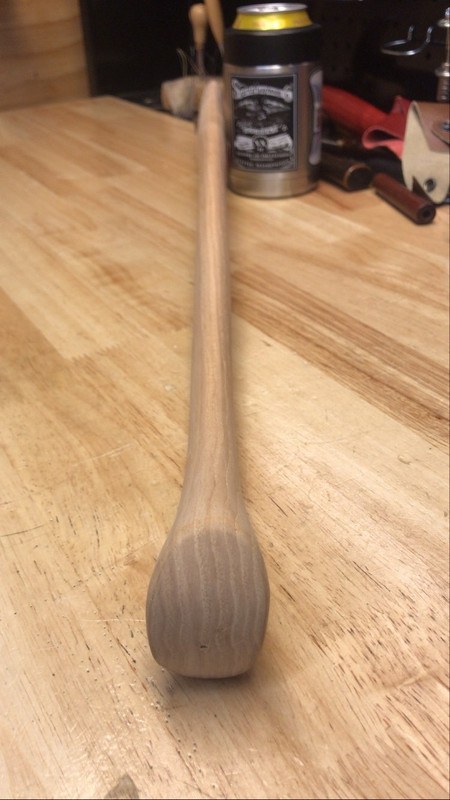

Just got this 24” of sexiness from Owen’s axe and handle via Lamaca via Bushcrastsisyphus... I’m not sure exactly what happened but it’s bad ass! (Hope I don’t screw it up.)
It’s their elite grade handle.

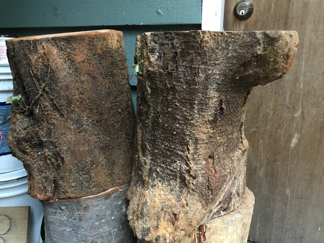

Actually I got some cool burled up stumps of a plumb tree that have nice character. I also picked up a WWI leather strap and some rusty 1” tacks to make hammer/tool loops around it.

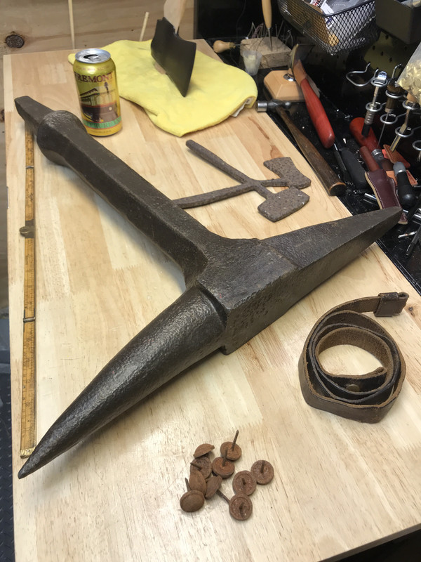

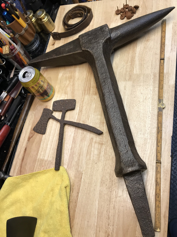

Well this thing is useless, it has no base at all?
Good for you!This thing is Very useful!:)
It isn't an "anvil"(pedantry!I know you love it:),although it is called a "stake-anvil"(or more commonly a "beak"or "bick").
As it's name implies it is an anvil-shaped stake,a bottom-tool.
It used to be a very important tool in any shop.The "beak",or rounded side is for welding and shaping sockets of all sorts,without it any socket work is a pain.

The square-section counter is for shaping and truing-up of assorted square-ish recesses,like hinge-joints(where i at times sorely missed something very like it).
If of good quality,the top face of it will be at slightly under 90 degrees to the sides,so that you Can shape an accurate 90...
This tool has a very good base.Of course it's not meant to go into a "stump",it is sized and shaped to fit into a special recess in a swage block,or an iron-man...Sometimes in a hardy hole of an anvil,tho' it'd then have to be a dedicated anvil and set up lower than usual.
But the germane thing about it's general arrangement is that it's "body"'s Mass is arranged directly under where you'd be likely to strike it-the small flat face-and is about equal in section.That will make the energy transmit all the way through the tool,giving you the most return on your energy invested.

That's great info! I think sunk in a stump it could be a great utility item, like the railroad sections. Perhaps not really for dedicated forging, but for the odd job I've wanted something like that a million times. I do need to pick up some RR for banging on, just need the right source. Was hoping to find some free.
