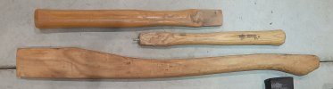

Followup on the axes/hatchets: boy's ax haft was pretty dry-rotted.More time spent junquing:

I have a Everkeen Hammond side hatchet, not as nice as that one. It's the only one I have seen that has an overlaid bit rather than just forge welding the steel to the flat side. Maybe it's just a Hammond thing not sure.Followup on the axes/hatchets: boy's ax haft was pretty dry-rotted.

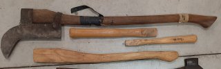

Head has eye ridges, a hint of red paint, and a rough finish, suggesting it's a TT Woodslasher. It's unbranded, bearing only the mark "D2". What's that mean?

Nice amazing haulA lady I met at a garage sale invited me to look through her late husband's garage full of treasures. I came home with these goodies:
My favorite is the Kent pattern/masting axe. The marking, DOUGLAS AXE MFG/CAST STEEL WARRANTED/MGF BY W. HUNT, dates it to the second half of the nineteenth century. Other markings on other hatchets include EVERKEEN and VAUGHAN. The boy's axe haft appears to be hand-made, but while it has great grain, it's a bit on the chunky side. Thanks for watching! T-A
That’s an amazing haul! Love the Douglas/Hunt.A lady I met at a garage sale invited me to look through her late husband's garage full of treasures. I came home with these goodies:
The lady from whom I acquired the lot said her late husband was a pack rat who brought home stuff he liked. These tools were still hanging in their garage such that they were not easily accessible. He just liked looking at them. T-AGreat haul there.
I wonder what he was upto with them axes, wood carver maybe working with logs? Open hangs mostly and even the boys axe handle is slanted open.
