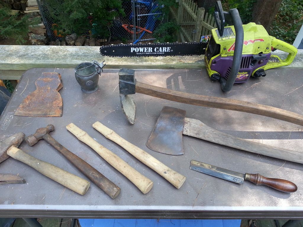

Had a little more luck today. Stopped at a Buddy's looking for some weathered wood for a project. He and his wife run an auction online selling various old things that he "picks". He is always trying to sell me axes but he never has anything that im interested in. For the last while they have been cleaning/organizing two large out buildings and a barn. I thought I would poke around as ive never actually seen 90% of the stuff due to the chaos. First I spotted this fawns foot poking out of a pile
I got pretty excited when I saw the big round knob.
There's no way that's a particularly new handle and check out that grain orientation. Cool handle regardless IMO.
I have not been going crazy buying as much lately as I have been feeling a bit burned out by it. I'm not giving it a break exactly, but a breather. A slower pace. I forgot what got me into this in the beginning, what I find to be enjoyable and that is the fixing and making things nice again. I've been carving handles. I haven't posted many of those as they are mostly hammers lately.
Anyway, I picked this stuff up today, $30 total for everything, including $10 for that 18" chainsaw. I am most thrilled about that.
My thought exactly City, I knew it was old and hoping for some good steel on the end of it. Unfortunately the handle is unsalvageable, regardless of grain orientation. Betweeen the uncut fawns foot and the knob being twice as wide as the rest of the handle it would have been a special piece
Don't toss it. With handles being oversized and thick these days you can use the old haft as a template or model while you rasp away the excess.
