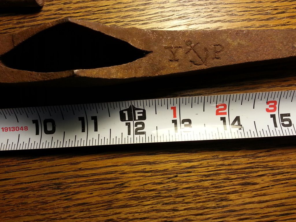

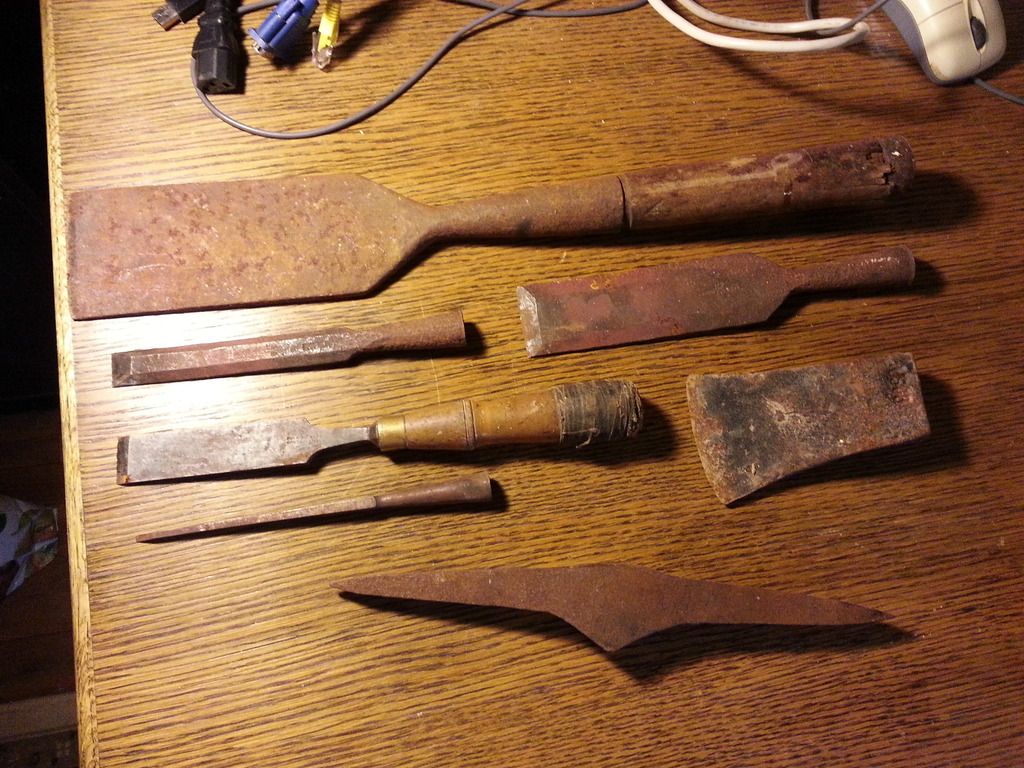

Another group rescued from the scrap yard for $20. That is a 3 inch framing slick, it's huge, and a 1.75lb 12" long hand made Yerkes & Plumb pick head...how cool is that? I think it was made between 1869-1879. I'm keeping that one.
Wow! I love that pick. House Handle sells drift pick handles for that thing.
Nice slick, too. Check the price of a new one and you'll see what a great deal you got.

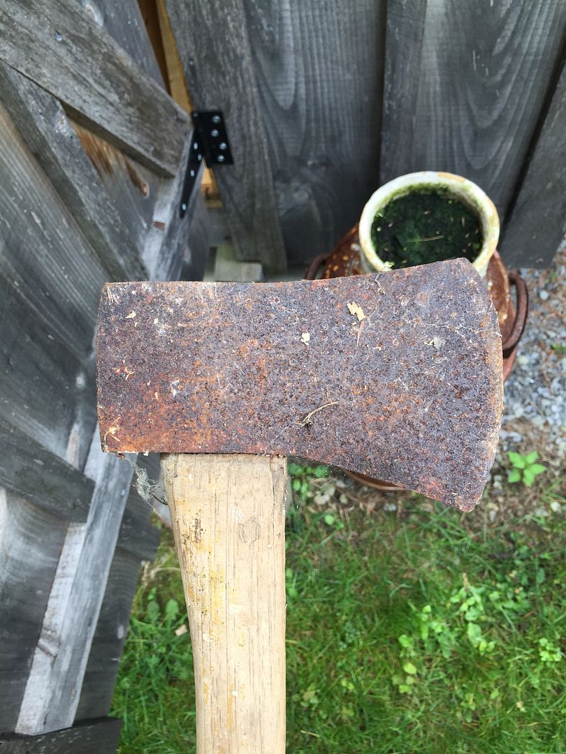

This kind of followed me home via mail.
Appears to have original handle which I will try to reuse.
Unclipped foot (namely an older handle) and undecipherable (at the moment) head has me intrigued. Let us know what you find under the aluminum railing paint.

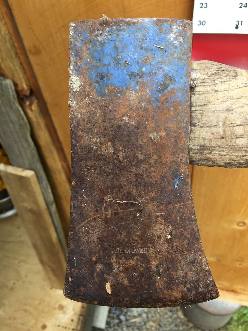

For now it says, Made In Sweden. Got to love the suspense.
Took a wire brush and wheel to it, has traces of red paint on it. I can't quite make out the stamping above made in sweden but it might be a Gransfor.
Maybe after it has finish it's bath then hopefully see things better but... red paint.

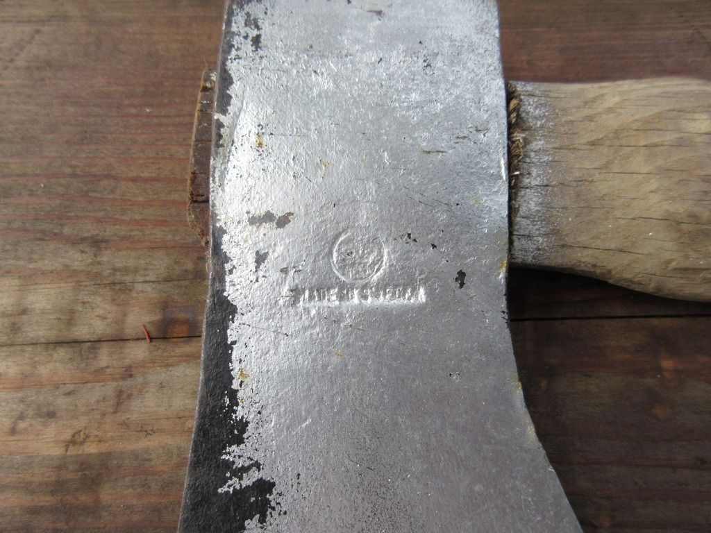

Looks like the Gransfors stamp on an axe of mine. GBA below a crown, with MADE IN SWEDEN directly below.

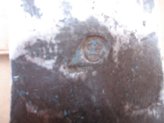

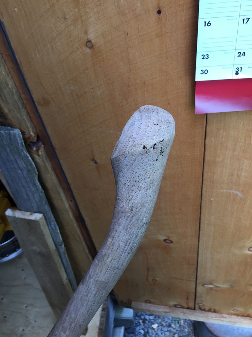

Had a little more luck today. Stopped at a Buddy's looking for some weathered wood for a project. He and his wife run an auction online selling various old things that he "picks". He is always trying to sell me axes but he never has anything that im interested in. For the last while they have been cleaning/organizing two large out buildings and a barn. I thought I would poke around as ive never actually seen 90% of the stuff due to the chaos. First I spotted this fawns foot poking out of a pile
I got pretty excited when I saw the big round knob. The other end looks like this

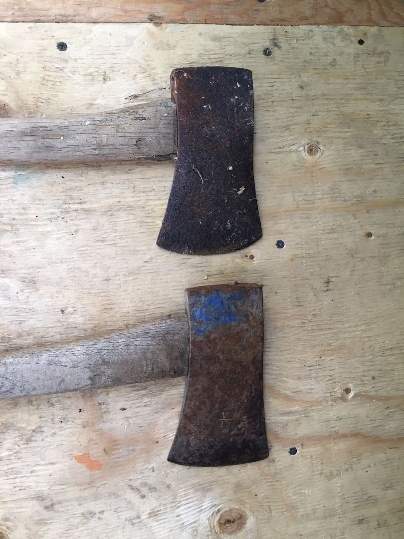

Pretty rusty with no visible stamp, we shall see. I haven't weighed it yet but id say boys axe. Next was this beauty GB with blue paint still visible clean poll and very little sharpening
Its marked 2 1/2, here it is with the other. They look about the same weight, different profiles. Im hoping American vs Swedish
I more and more figured that flea market/garage sale-savvy tool shoppers carried steel scouring pads or wire wheel-armed cordless drills with them. I know $4-5 is no real risk regardless of whether a paint or rust buried stamp turns out to say 'Sweden' or 'China' but still who wants to come home with another piece of junk. 'Got to love the suspense' is not prominent in a frugal library, unless spent lottery tickets similarly litter the floors.
Guess you didn't read my posting after that cause you would see that it is a Gransfor which I don't consider it as a piece of junk.
Maybe I'm just not reading your posting correctly or misinterpreting it...got to love forums for that LOL.

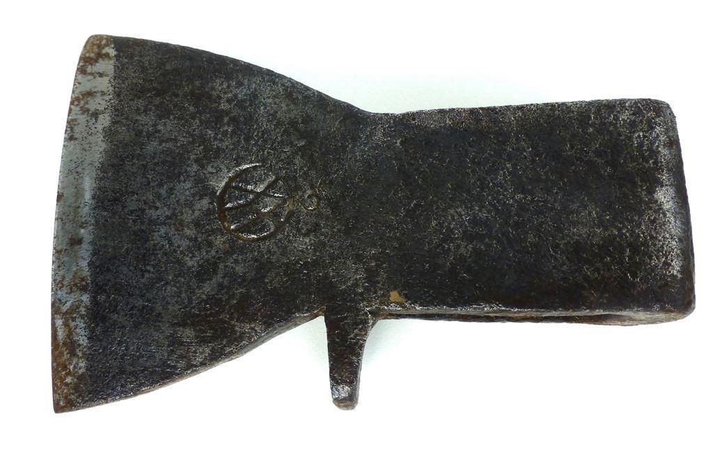

This beautiful axe followed me home today, I believe it's some sort of hewing axe. Not a single clue on who the maker is.
I will carve a "russian style" handle in birch, for it.
