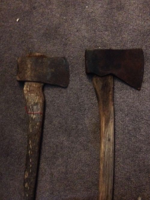

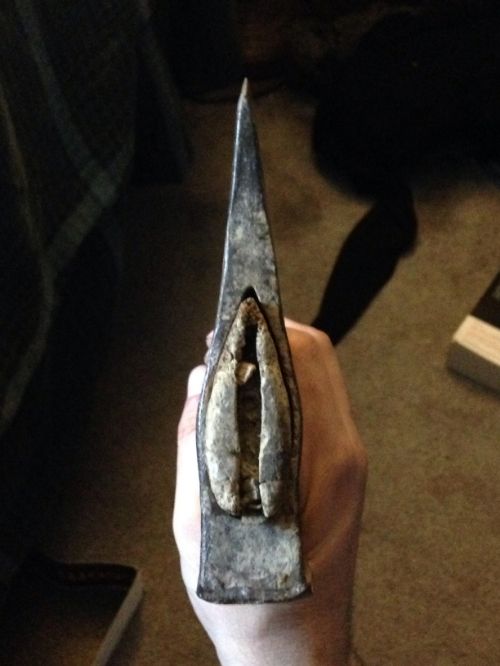

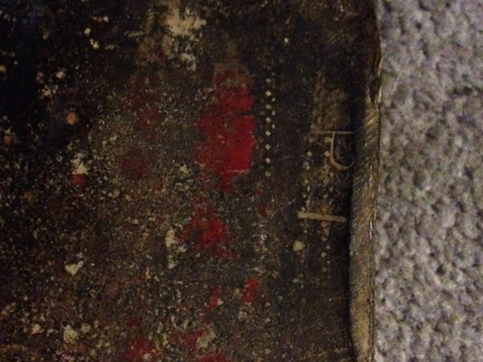

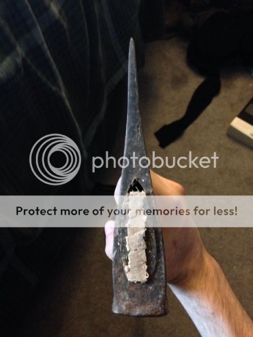

Never put it on a scale but I'd have to say it's 3-3.5lbs. I noticed the eye size is a good bit smaller as compared to other axes of the same weight. Pretty sure I'll be doing a good bit of shaping to get it hung properly on a modern handle
A 3-pound goes nicely on a 30"-32" handle. For me a 3-1/2 pound axe feels clunky on a 30". So if it's 3-1/2 or heavier I'd go 32"-36". I prefer a curved handle unless I'm going to be using the poll a lot.
The eye size is puzzling. Standard boy's axe handle size is 3/4" x 2-3/16". Standard full size is 13/16" x 2-7/16". If it has a boy's axe eye then it's probably no larger than 2.75 pounds.
Awesome, Thanks!
Will do more research into the exact weight and get the dims on the eye before making an order. I have some really nice pieces of Hickory I can make some custom handles from. I need to get a nice draw knife....
I'll also be hanging a Plumb 3.5lb single bit and a vintage Craftsman 4lb double bit...

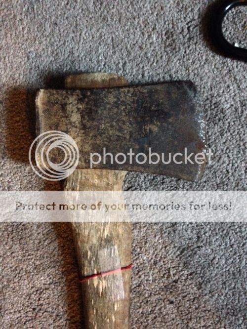

The first is a Maine pattern, work in the toe pretty bad but it looked fairly old and the wedge shape kind of gave that away. Marked BAR on one side, P I on the other, with the weight stamped what looks to be twice at 3 1/4 Pounds.

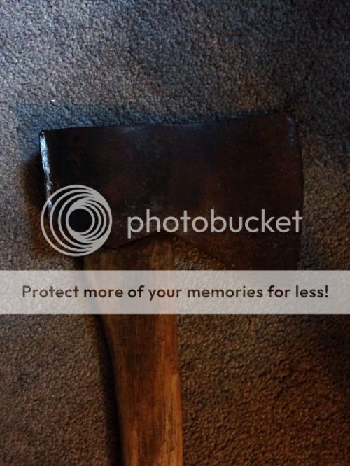

This one was SOLD as a Collins, but I don't see Collins anywhere on the damned beastie. No idea what to call this pattern, maybe a Rockaway or Jersey. The only markings are 3 1/2 with an M stamped underneath.
Both interesting axes. I like the old Maine pattern, though you might try to close the eye a little when you re-hang it.

The Maine pattern is going to need rehanging, and some love on the edge but I'm waiting to do anything like that until I get a bit more info on the axe itself. The Collins may be an aussie export Plumb, but the markings are swapped from what would be a aussie export.

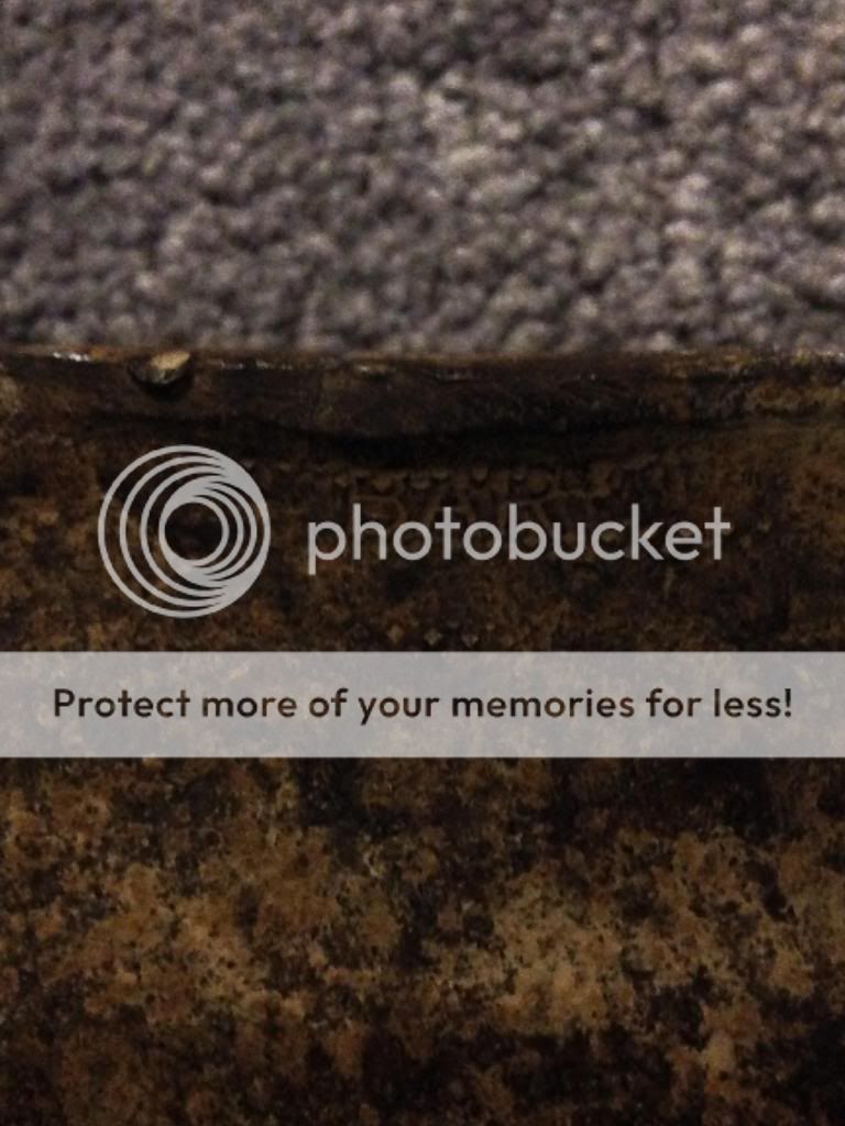

Here is a update on the Kelly Registered. Before and after pictures.
[/URL][/IMG]
The other side from the Registered stamp. The ither side has more rust and dirt than this side, but I can clearly see a rectangular stamp. That has to mean a Kelly registered.
[/URL][/IMG]
[/URL][/IMG]
Yep, the stamp is completely trashed. I can make out 'Kell" that's about it. Win some you loose some.
