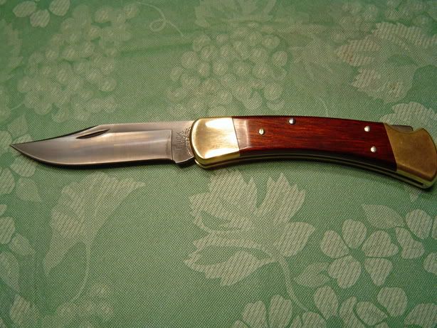

I decide that I was not going to enjoy the Cabela's logo on the Alaskan Guide 110 and I wanted it gone. My first thought was to send it off to Leroy and have him make it like Mikey's(Mike K) then I thought, no I like the dark blade, why not see what will take it off. I can always send it later if I mess it up...others may want to know;). I had a can of paint stripper and tested it on a small part of the blade, nothing happened to the coating. I put it on the logo let it sit about 5 minutes, the directions said 20-30, and started to rub gently with a stiff bristle brush. About three minutes later it was gone:D.
There was a little after image on the blade but Flitz gently rubbed on took care of that, I like it...

:thumbup: ...Looks pretty darn good to me Preston. I really like a "kine" clean blade. If it had a nice small Cabella stamp or something it would be fine as long as it wasn't on the "meat" of the blade. I prefer Mike's and your's way over the "stock" Cabella model. That BOS logo just has to stay tho...LOL...:eek: :D :eek:
Nice work. Really looks better without teh logo.
Good thing I've got some paint stripper in the garage!
Sheath doesn't bother me.
Now where did I put that paint stripper?

Mine's gone now thanks pjsjr.Took 10 min......bigfish

One other suggestion... the TiN coatng has a high RC rating and you can easily use a razor blade and scape it off without scratching the coating.
Did this about a year ago and it worked fine.
