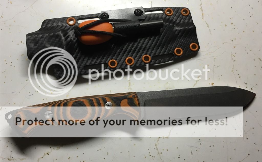

Comparison tip pics FK , SK!
As Nathan stated the FK was designed to be a slicer , which it slices and does finer tasks much better than either of these two . But the SK! can sure take a beating . I am totally confident the CPK FK can do any task I could throw at it .

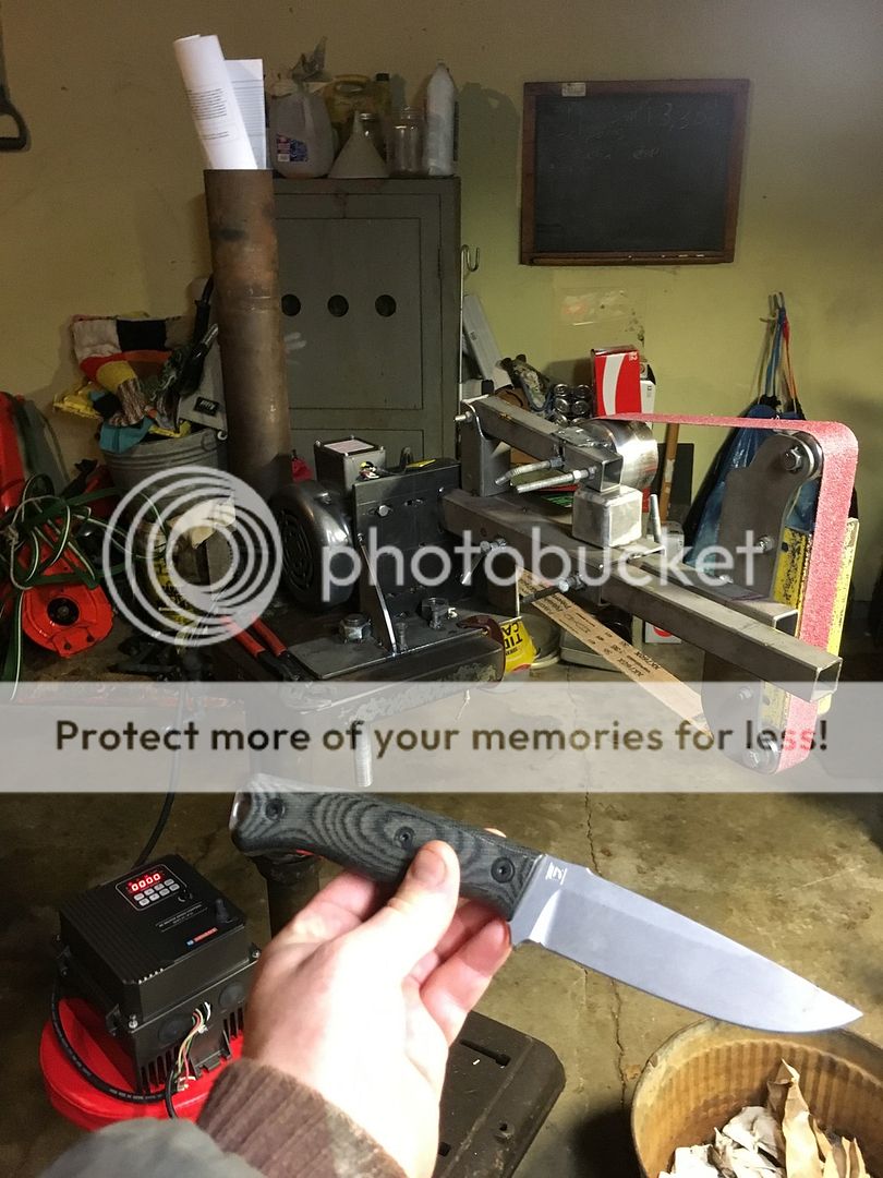

Bringing this back around to CPK: my field knife literally just showed up an hour ago, and it's a really interesting contrast. In a lot of ways they're pretty similar but the FK puts similar ergos (the handle profile is very similar) and ostensibly comparable (actually more) functionality into a more refined and considered and compact package. I haven't had the opportunity to use it yet, but I can assert that the Field Knife seems like what you'd get if you put the alpha on a diet and a strict martial arts training regimen: it's trimmer, slimmer, and more focused in all the right places, while in all likelihood being equally tough in all the ways that matter.
Anyways, I'll refrain from saying more until I've had an actual chance to use the thing, but man I'm impressed so far.
