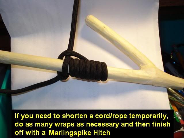

·does some jobs better than existing knots ( I have a challenge for you...... :D - show me a knot that does a quicker, more secure job of shortening a cord for temporary use than the extended Marlinspike Hitch) :
·or hanging a bear bag over an existing high branch:
^in the above diagram, a Marlinspike Hitch would replace a Clove Hitch
Anyway, that's all I can think of for the moment. Your thoughts?

It was worth the effort: i didn't know the adjustable toggled loop. Very interesting, i have to play with it but i do think i will find some useful applications to it.
I note the challenge about the shortening knot, it won't be easy without the use of a toggle so, be patient, i need time.
And while i'm at i will try to work on a trucker's hitch without toggle but still convenient.
