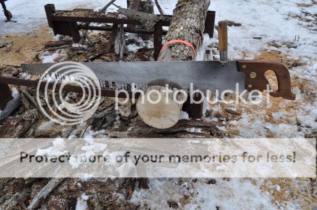

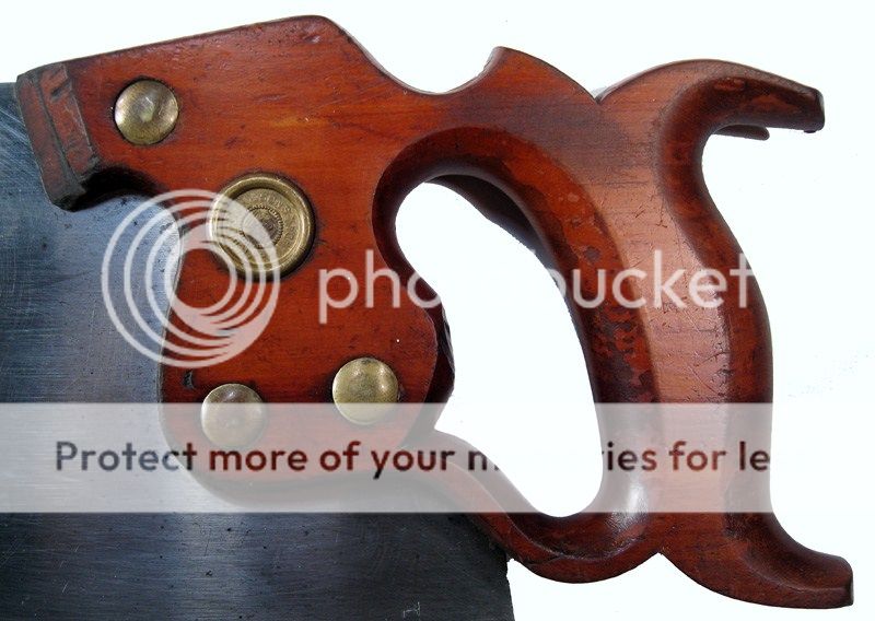

Do you want your saw to look like this one when your done?
Wish I could say this is my saw. I don't remember where the picture came from. Compliments to the owner. It's a Henry Disston & Sons Perforated No. 514 Spring Steel. A perforated lance tooth design. 3.5 Ft.
That saw looks like a good goal to shoot for. I missed what you were saying in your post above...had to go back up and re-read it. I will get on ebay and see what I can find as soon as i get back from trying to get these other saws. Thank you.

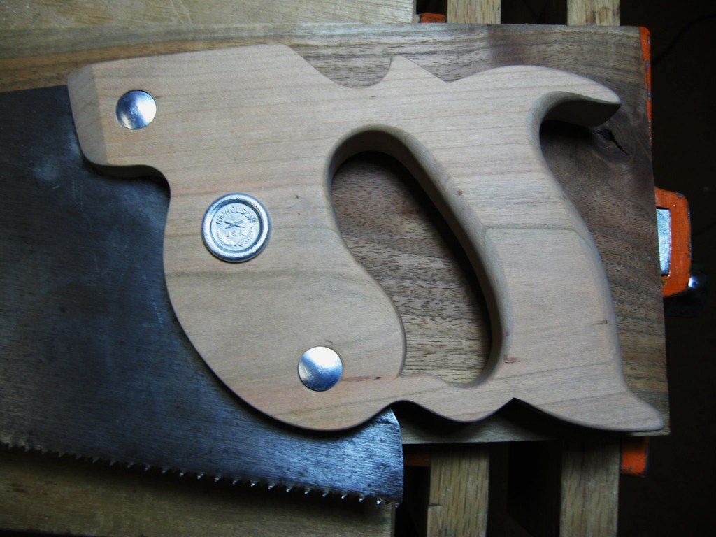

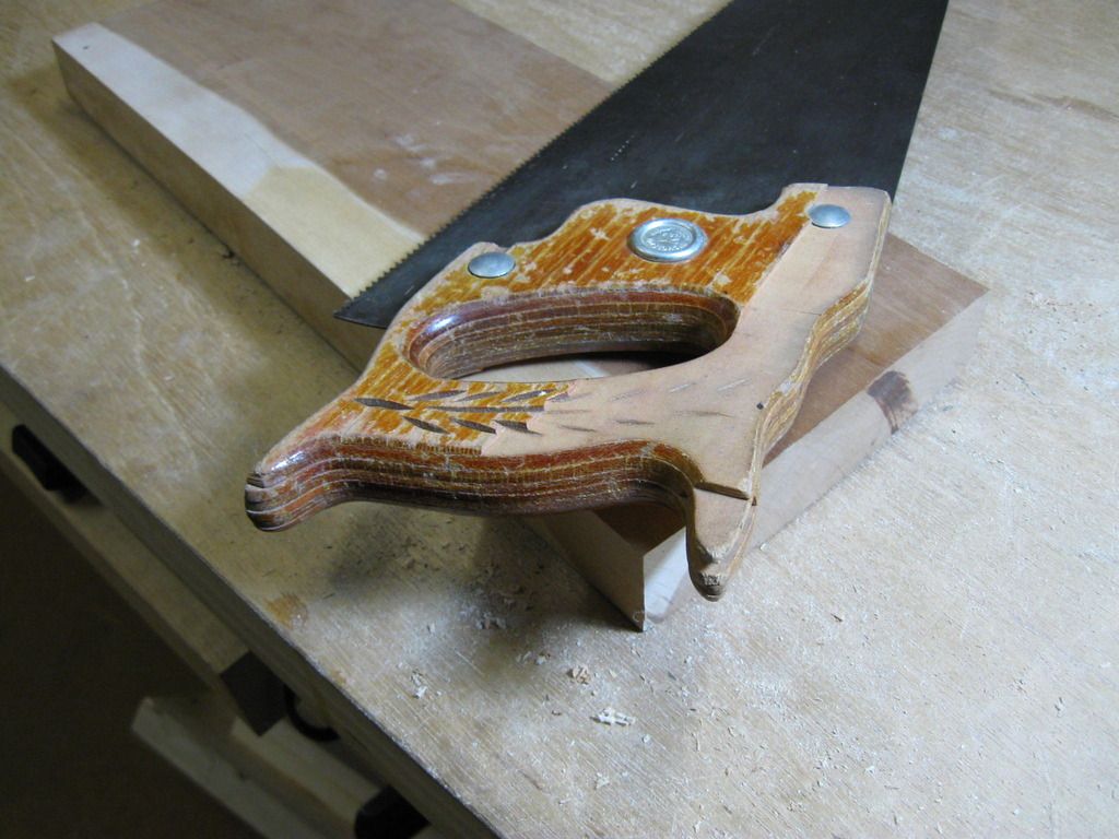

A friend had this in his shop.
I got tired of seeing it and took it home with me one day.
Found a picture of the shape I wanted on the web.
Scaled it and made a pattern.
Used the saw plate and transfer punch to locate the holes for the saw nuts.
I marked the outline of where the saw plate would sit in the handle.
I don't remember what kind of saw (power or hand) I used to cut the kerf in the handle.
Here is the end result.
I didn't put a finish on it as I didn't want to embarrass myself. My friend has refinished furniture for 30+ years. :D
Amazing handle, BLO on it would be good enough i would think! you ought to be proud of your job, mate!~

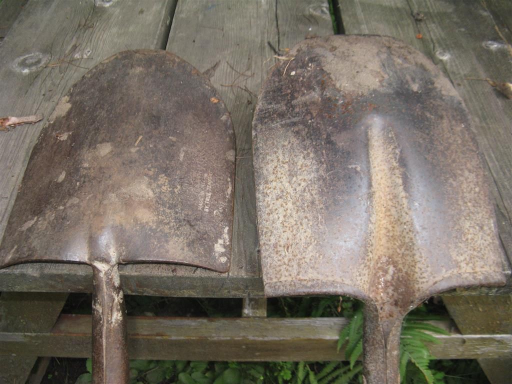

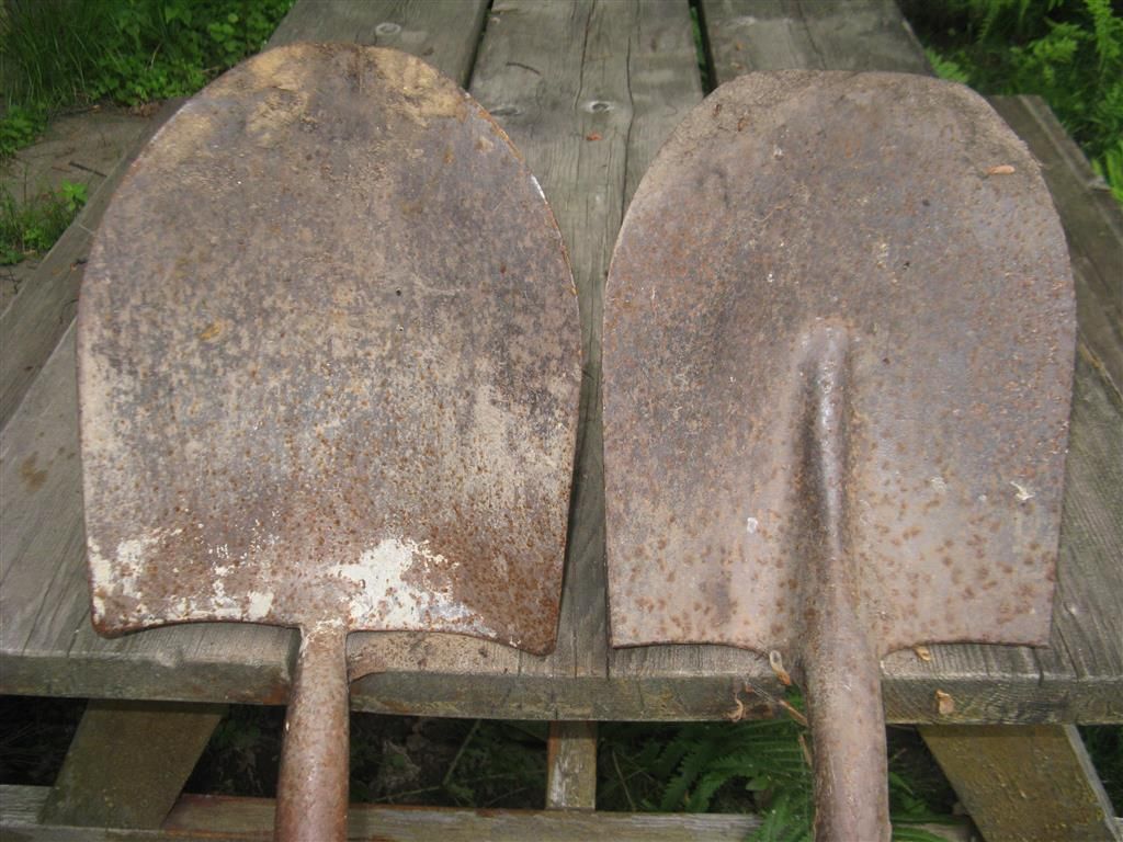

I dragged these out from behind my shed; to illustrate the difference between a forged shovel and a pressed steel version. From blade wear on them you can readily tell which ones are preferred by hourly workers by virtue of being lighter in weight and having a shallower scoop. The forged one happens to be a TruTemper that I would have bought new in the mid to late 80s. Forged blades are considerably more sturdy (metal is thicker and likely better steel) and are well worth seeking out if you want a shovel blade that lasts a lifetime.
I should have taken better care of these but hourly-paid 'skins' that don't/won't clean fresh concrete off shovels (and hoes and rakes and...) was a constant battle for 25 years.
