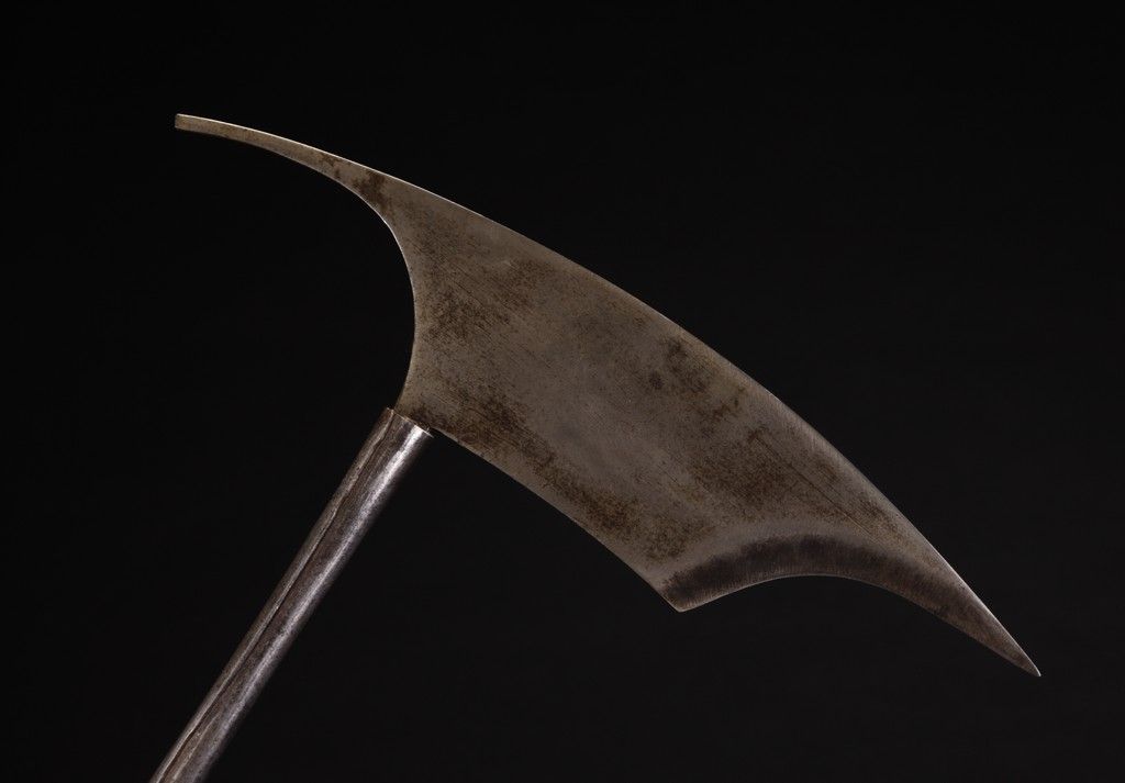

to continue my head hunter saga-- this is from luzon phillipines its called a Kalinga --just finished payments on this should arrive next week :D
lol ndog, erik is the best , honestly if you ever want to buy a high quality antique, he will work with you and give good terms, many things totally out of my reach he made possible for me to own, I have paid on this kalinga since january---and yes blue those are hands down best mandau I have gotten opportunity on.
Those Igorot axed are what my 'hawks are based on-missed a chance on a real one a couple years ago-for $25... Who's a dummy??

Gehazi, that is truely strange looking. Sort of a pickaxe but melded together in a vision that seems wrong to those of us who didn't grow up speaking tagalog eh?
I thought Kalinga was the name of a region in North East India. Wonder if there is any relationship with this weapon/tool. btw I just saw something interesting. THe one of these I saw for sale says it was "collected by a Missionary in 1800s" I guess that is one Missionary who is glad the collecting went that direction instead of the Headhunter using the Kalinga to "collect" the Missionary's head LOL.
most of the stuff I collect ( the best stuff) was collected by missionaries-- or at least thats what all the antique dealers say :D, hmmm the names do get funky--it is definitely a igorot axe from luzon, perhaps kalinga means axe in india? dunno really , but I want to get the other one from the same dealer, he has one of very high quality but without any brasswork-- so if anyone is looking for one you better go over the summer as my funds recover , otherwise its mine!
I cant remember if it was a salesman or my old man who told me to try and buy the best I could when I could :D-- above axe , the kora sword and all the 3 mandau are from same dealer, who has been very generous with me by letting me pay over time.
