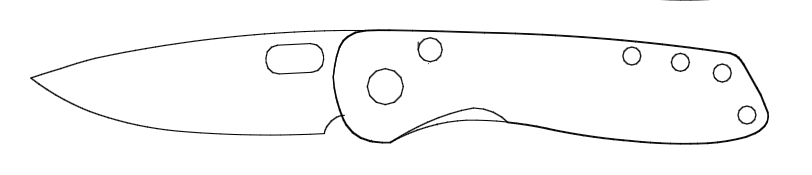

Here's where I'm at so far! I'm going for a few things... super heavy duty construction and a clean look.
Full sized handle, great sized blade, still fits in the pocket and carries well - heavy duty as can be yet fast and light for the size
Random details...
7.7" total length - 4.5" handle
tip up carry
.25" thick blade? I want input on this please.
Steel type - not sure yet, want input... S7, D2, 3V, Elmax, S30V or S35VN and more are being considered; lots of great options here
.155 mega thick Ti frames - I may do a later option with scales or insets
super heavy duty construction - multiple extra heavy standoffs, huge heat treated stop pin and pivot

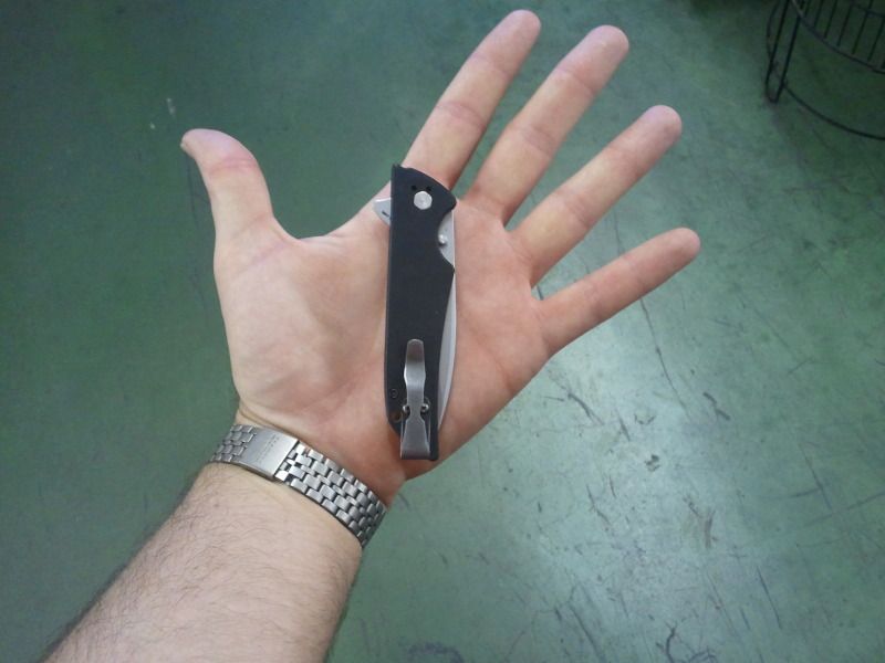

The inspiration, my "Legal EDC" Model. This is the template I keep to scribe from.

.25" thick. I like it.
I prefer S7 or D2.
.155 mega thick frames. Sounds good.
Super heavy duty construction. I'm in.

Why such a thick blade? Thinner blades cut much better.
Because I rule! :D

I like the idea. It would need a 5" + handle with my design ideas, I want to keep it sleek and ergonomic. Less hardware can easily give you a longer blade but I don't want to do it that way. ...maybe though, this design is pure overkill.
I noticed blades with a lot of hardware (great for strength) either sit out far in a large handle (Strider) or have a ton of drop at the butt (Hinderer). I like the clean lines and great in the pocket feel of Chris Reeves Knives, Hinderer ergos without the big pocket outline and I also wanted the heavy duty Strider thing going on but without lots of stuff going on. This design will sit well in the pocket because of that and still be tough as can be.
Thanks very much for the feedback, if you guys want a bigger knife I will do that first. I'm deep into this folder thing and expect to have 3 sizes out eventually... to me this is a perfect EDC size, a bigger one is just cool (and useful too) and a smaller one is great as well, not too many people make a heavy duty smaller folder.
5+ inch handle is fine by me, I have pretty large paws anyways. Just for an idea, I can hide my skyline in my fist...
I discovered something pretty cool on accident the other night sharpening my skyline, the thumb studs are th correct length to set the bevel for the edge! Just lay on the stone so the edge and stud are both touching and it is the same angle! I put one layer of e-tape over the studs so it didn't load up the stone with softer steel and it really helped me freehand by haveing a reference point for angle, just like my straight razors. I don't know if you can pull that off within reason on a thick blade, but for the thickness-height ratio of my knife it worked!
I think if you did a swedge on the forward half of the knife the stabbing resistance would go down without compromising strength. Hand lapping for flatness on the pivot is a good idea but I don't like it polished mirror smooth. You need a certain amount of "roughness" to hold oil anyways. I assume your going to use PB washers? Seems the PB and teflon washer combonation allows just a tiny amount of blade play. A thought on back spacers, stand off are great but as Kevin and I found out on a couple of RAT1's can cause all sorts of alignment issues with blade centering when disassembled and reassembled. I think if you did a G10 one for a portion of the back with stand off on the butt to allow debris removal would accomplish you rigidity goal, reduce cost and eliminate complications.

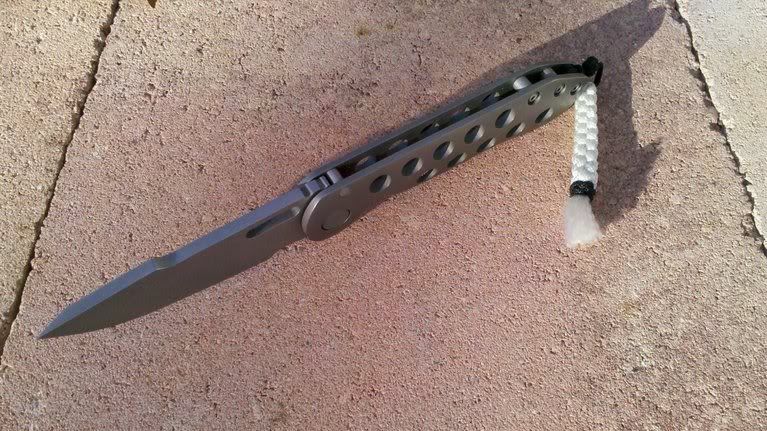

Thick blades can cut well, it's just a matter of having the right blade geometry which I know Daniel has a good handle on. Jeremy Horton also understands how it works, here's some edge shots of the TAC-4:
It really is as sweet as it looks. Bring on the beefiness DF!
