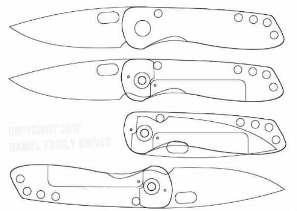

I've been working on a frame lock design!

Improved lock geometry, possible lock bar just drawn up, changed up standoffs

Lock geometry, what fun! ;) :p
I've been researching lock geometry the past few days, it's amazing how involved it is.
Am I correct to assume that the closer the lock cutout is to the center axis of the pivot the stronger the lock is going to be?
Yes. There are about 5 major aspects to lock geometry that all effect each other. I'd have to write a book to really explain it well but that is correct.
The lock should be "under" the pivot as much as possible; of course this can not really be done (other stuff plays in) but you want to get it close. Having the lock interface closer to 6:00 pushes the lock bar back as opposed to lifting it. The further you get to 3:00 the more the bar wants to lift; lock rock or blade play is the outcome.
Location is 1000 times more important that the contact area in the lock too; in fact a lot of contact closer (higher) up the pivot will also lead to rock or blade play.
The Triangel is key to lock geometry... so i'm told.
That is true in a lot of ways; triangles build strength. You could have a stop almost anywhere though so that is an exception to the rule.

Daniel- Have you considered a hidden blade stop?
Eventually I might try one. Right now I'm going with a 1/4" stop, mega heavy duty. I want a lot of contact area around the pivot fro lateral strength too; this design maximizes that.

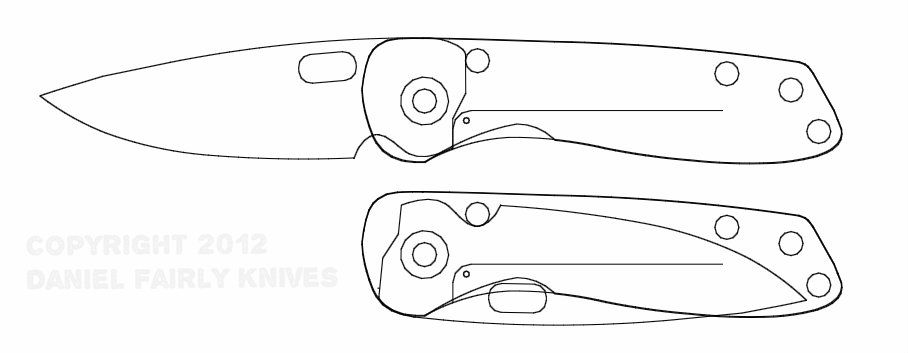

I have gotten some great feedback from some major knifemakers on the design and they say it looks great! I am going to tweak it a bit more and it will be on soon! I'm still hoping to have a prototype by the end of this year. :D

saw the new rendering on USN, looking good with the tweaks. if i can make a suggestion, it would be to have bigger washers.
Thanks! I will have the biggest washers that will fit in, it will all depend on my final lock bar placement. The non lock side will have a massive one. Phosphor Bronze or Nylatron for the washers...
I am very close to the final design now! I have changed it up some after uploading this, the blade is longer/taller and the lock is closer to being drawn in.
The pivot I am using is just massive and the .25" stop is as big as I have seen. It has taken me hours on end getting the massive stop to work with everything but it was worth it; I feel the geometry is as rock solid as it can be.
