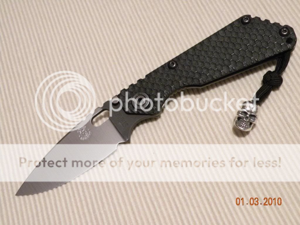

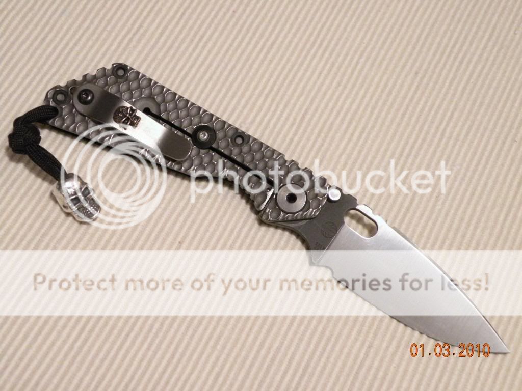

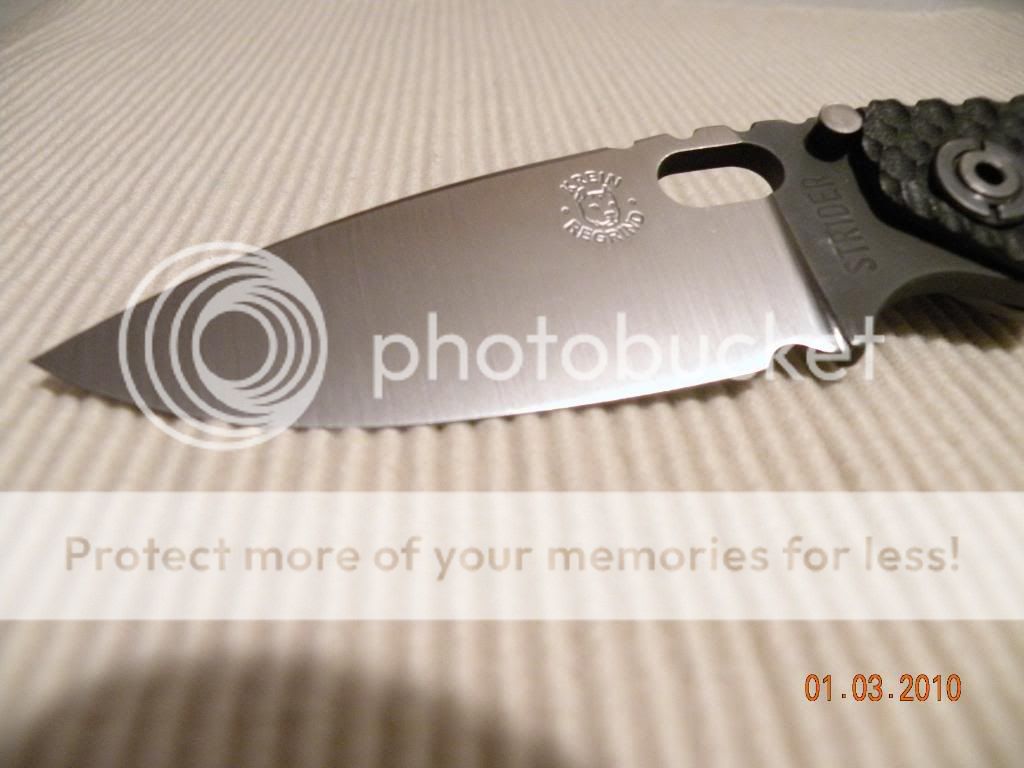

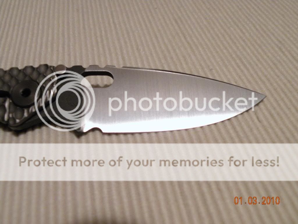

I wish i could take some better pics but it is dark outside right now and i dont have a light box/tent.
