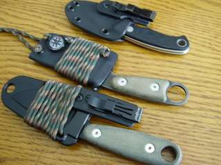

Recently I acquired the Izula II and it is rapidly achieving the same status as my original Izula...Makes it hard to choose at times which to carry;) I've always like front right pocket carry and even with the clip plate that came in my Izula II's kit I felt (for me) it rode to high for my liking. I made a mod to my Pocket Bowie a few weeks back and was really pleased with how it turned out that I turned my attention to my new Izula II:thumbup:

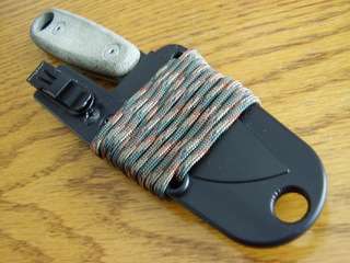

Here are the final results:D

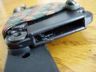

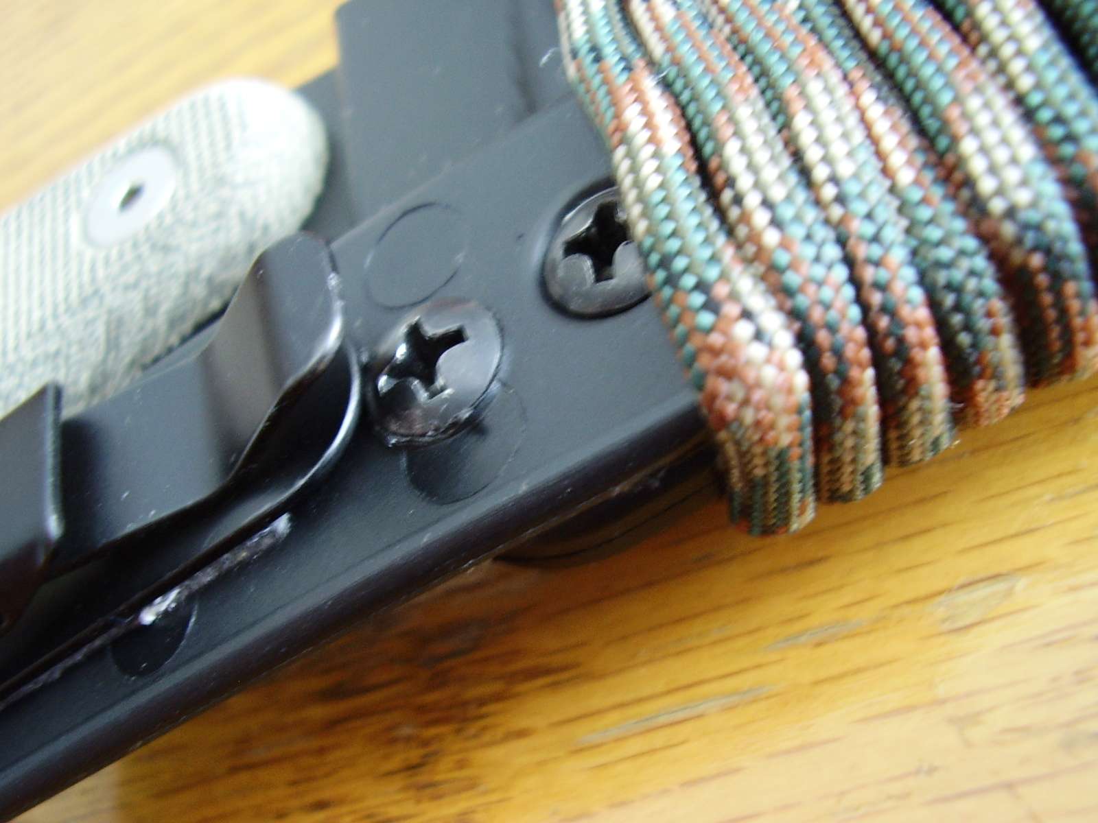

I used a Molle Lock and cut it down, sanded the ends, attached a Nite Ize self adhesive clip to it (they have held up very well for me on other applications) and therefore allows me to carry a little bit deeper in my pocket. Much more to my liking:thumbup:
The screw just under the clip allows me to adjust the tension when drawing the knife from the sheath---I like this feature alot and it really works;) Behind the (what I call the tension screw) is the rubber spacer that comes with the molle lock. This keeps the molle lock spaced evenly from the sheath.

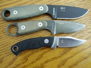

Heres my fixed blade trio shot.

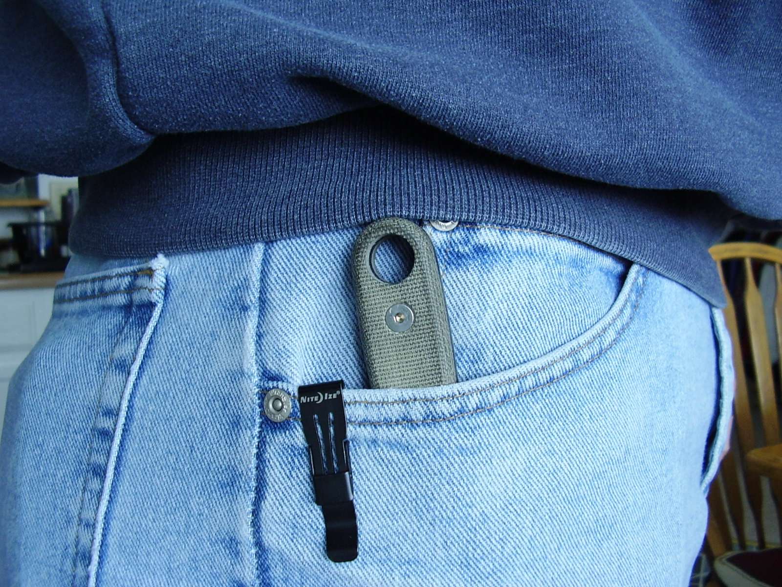

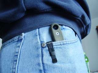

and the "in pocket" shot.

Umm. neat design.... what happens to the jeans on a quick draw.
re-sheathing the knife....... is it tricky...?
Striker, the nice thing with the clip is it has a little catch so it wont pull out of the pocket. That feature combined with the option of setting the tension of the knife pull with the screw I installed allows for just enough tension so the knife doesn't fall out, yet pulls easy. I actually got rid of the nubs that hold the knife in the sheath because it was difficult to pull out with them. The re-sheathing hasn't been a problem at all, it was a concern I had in the beginning---could it be a problem?---I'm sure it could if not thinking:o With one finger I simply open the pocket and am able to insert without incident:)
