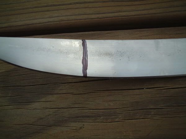

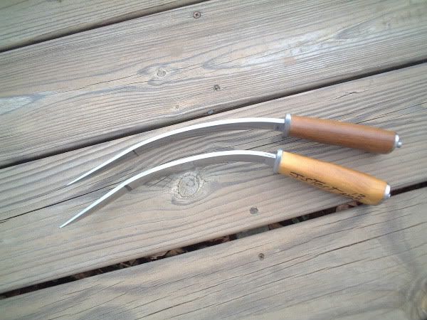

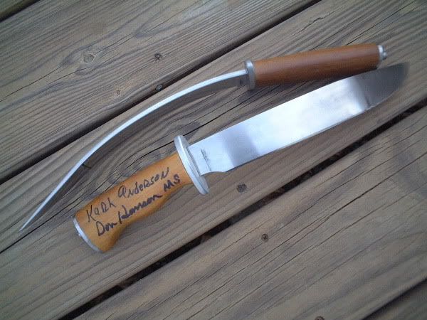

On my home-test-knife, I was amazed that it performed so well, but mostly, that when it came time to bend the blade, I couldnt even insult it! I only weigh 170 pounds, but I had my legs wrapped around the work bench, and still could hardly bend the knife.
Then, I put a 3 foot cheater bar on the handle, and bent it waaaaaaaay past 90 degrees. I never heard a crack! I kept waiting for a crack! Nothing. And, it went back to under 20 degrees from straight!
I thought it was a fluke.
Then, with my official test knife at Dons, the same thing happened! I could BARELY get the blade past, maybe 30 degrees by hand.
So, I used the cheater again.
No crack, not even at the fine cutting edge, and this one returned to exactly 20 degrees from straight.
Both knives cut - well -, stayed razor sharp through abuse, and defied destruction.
So many times I have seen test knives that had this sharp kink right at the vise jaws, cracked ½ way through, and then stayed acutely bent!
These bent gradually all along the entire length of the spine without ANY cracking.
This tells me that there were NO weak links in these chains.
The blades were tough from point to butt.
