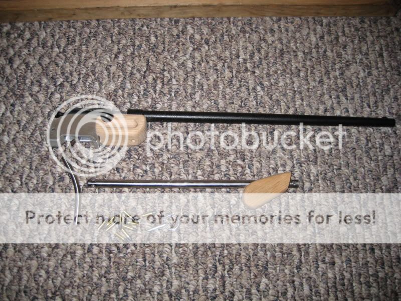

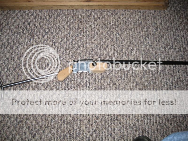

I have to say I missed Jeff's article BUT, I do dream of a survival rifle and it looks a little something like this. You could stash that thing anywhere.
Unfortunately this is not mine. Its another one of those "I wish" projects.
Here is the post from the guy who made it.
Welp, here it is. Ain't the prettiest thing out there, but neither is an AR7. Pretty is as pretty does I recon. I have a feeling it'll always be a work in progress, but it works and is pretty well all there. And yes, I did have too much time on my hands. It started life as a Cooey Ranger, 17" barrel single shot. It was a mess. Looked like it was painted by a blind 4yr old, the stock "embellished" with a pick axe or something. It worked fine, and a bead blasting and clean up took care of the gunge. The paint's bedliner, I'll prolly do the aluminum bits as well. The stock is 1/2" SS tubing and handily holds 13 lucky .22 rounds. I'm going to do a double layer of paracord wrap on the stock as soon as I find where I stashed it. The tee bit on the end is removable for space saving if need be. A wee hitch pin with a ball detent holds it together when assembled. Scrap oak kicking around the garage rounds it off. Eventually, I orta do up a proper trigger guard, but it's fine for now.
It's a great little project to finish...
looks liike an old stevens action, single shot, manual cocking. one single take down bolt close under the action. easy to clean and maintain needs good sights.

Would you mind posting a link to that? Looks like a sweet rifle! The angle on the stock looks to be a little much though...
