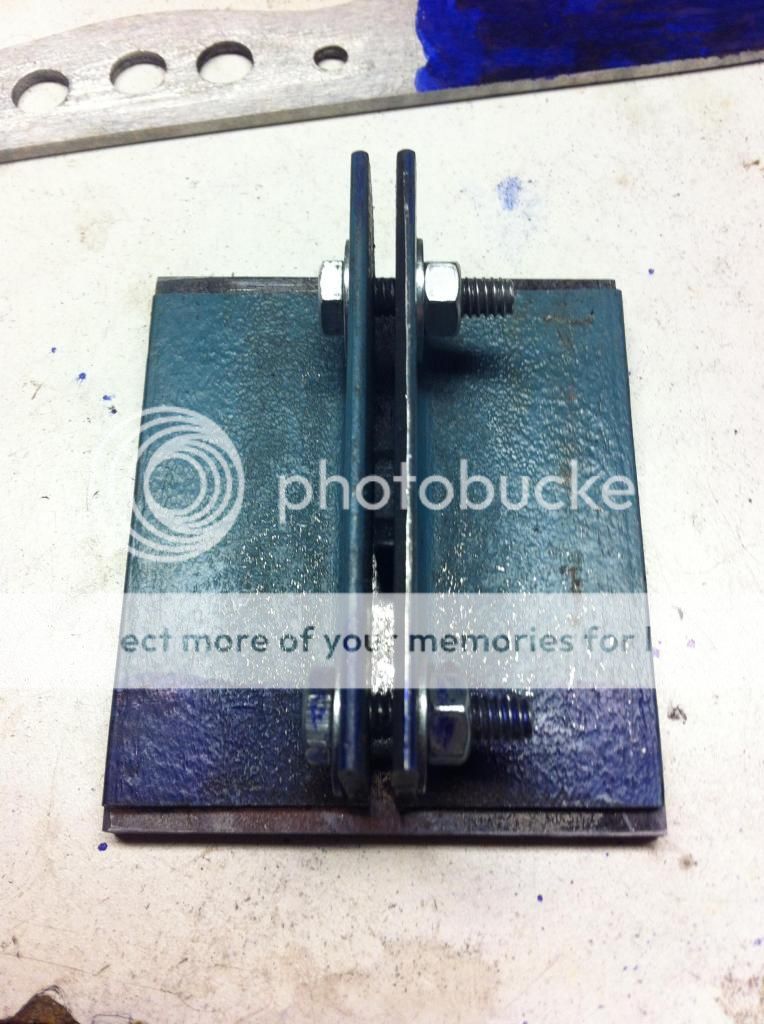

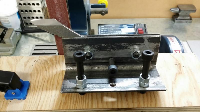

Here's the grinding jig I have been using for the last two years. I got it about 10 years ago from Clare Broeksma when I lived in alberta and I only started using it when I started trying to repeat designs. it's a pretty well thought out machine.

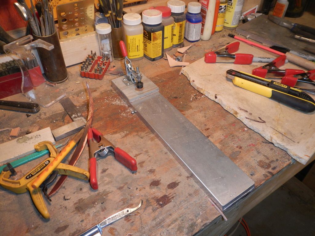

just made this one on the weekend. it's a clamp to hold sandpaper on a flat plate for ...sanding flats what else. quick clamps lock down an aluminum bar with leather glued on it to secure the paper.
cheers
Royce
Looks to me that you must remove the blade to grind from one side to the other. There are more simple ways to do that. Placing the blade in some micarta blocks and tipping the table works very well.
Frank
problem with tilting platens and tables instead of tilting the jig is I've pinned them so they are at 90 deg (ish) and I can't just tilt my platen anymore without removing the pin. The pin is easy to remove, but the problem with the Bee grinder I have is that the platen is held in place by one single bolt, mounted in the center and it always migrates on me ... sometimes fairly quickly. that's why I pinned it and just blew the dust off the jig and have started using it as it's set up in the pic.
The answer for that is to make another table set up that will allow you to remove the table that came with your Bee and install the tilting one as you wish.
Frank
thanks frank, i'll put that on the drawing board and see if that will work better than what I had in mind... I've been looking into machining another mount to be able to adjust and lock the flat platen in different positions with very minor adjustments, but that might be an easier fix. That is the one great thing about the knob on the jig I have is that it allows for very minute adjustments with minor turns with everything locked at 90, but

Remember, it's whatever works best for you. Many have gone to the computerized grinders, out of house parts cutting, ect..

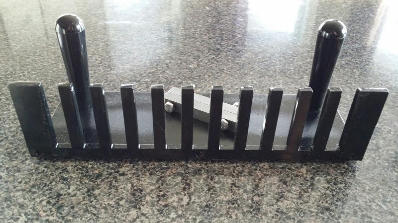

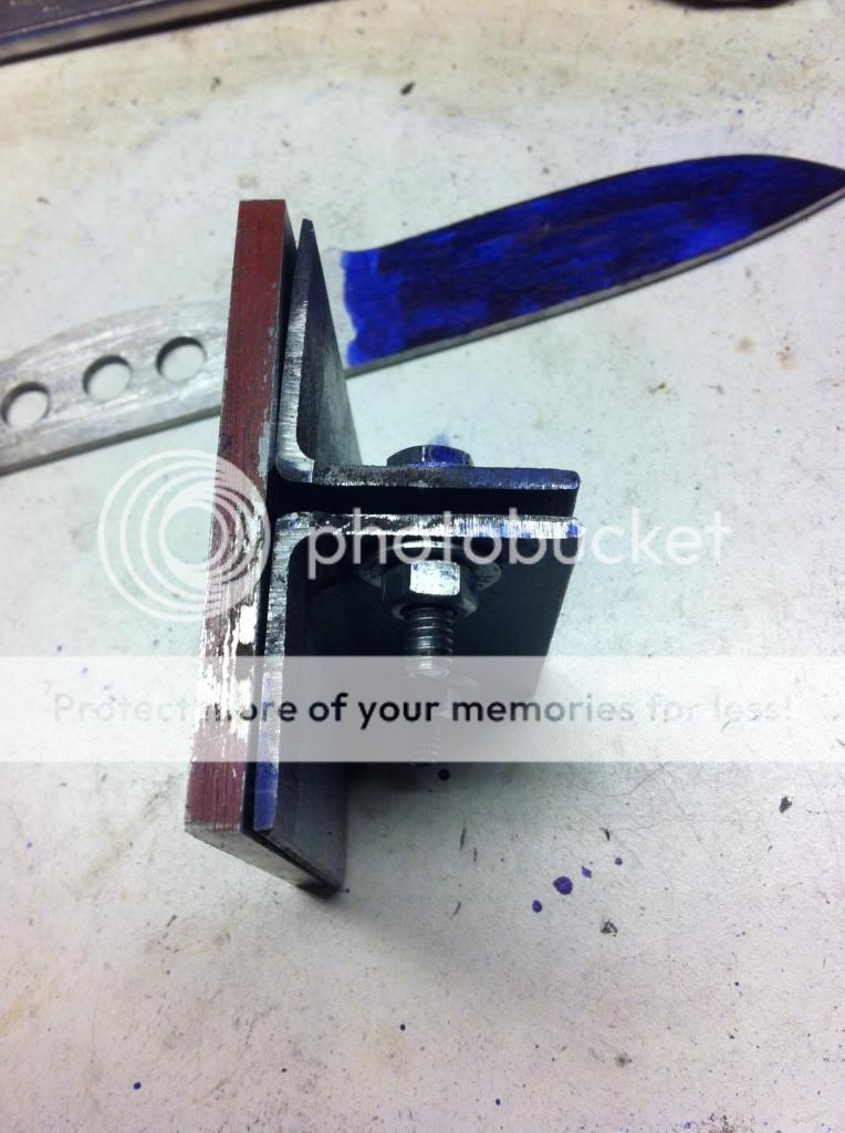

I made this one when I first started making knives.
I got this one from the guy who made my grinder.

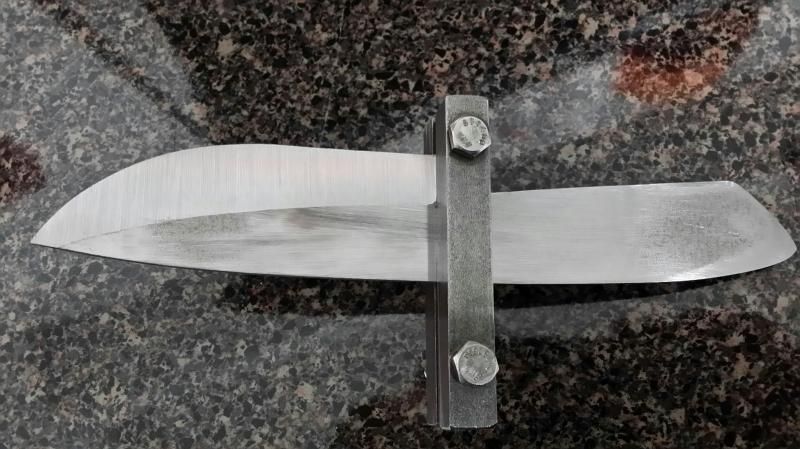

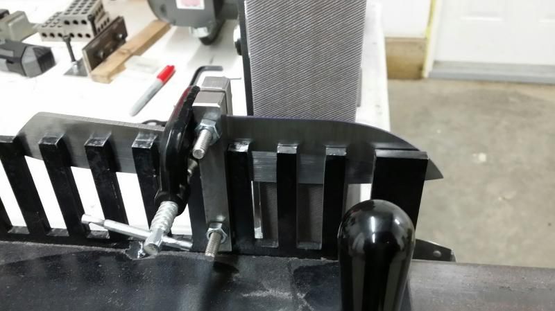

I tried using jigs early on and got some decent results. The problem was that the jigs limited me. I cannot grind in distal taper or a long sweeping hollow grind with a jig. I am by no means "anti-jig". I've been doing machine work for 25+ years and jigs and fixtures are a art unto themselves. I find this jig to be creative and possibly one of the most "idiot proof" of designs I've seen. I think this jig could have a completely unskilled person making decent blades in just a few minutes. Clever!

the long screws on the guide and the c clamp do not allow for the other side to be grind without dismantling the whole setup. this introduces variable and takes away done off the idiot proofness. :)
I disagree. All the jigs that allow grinding of both sides have two inherent problems; the blade is cantilevered out away from the base which creates the opportunity to have the friction of the belt pull the blade downward and if the knife is not mounted absolutely plumb to the base, the grind angles will not be equal. This jig may not be faster but, I think it is going to be harder to make a mistake using it.
Bob
You undo the C-clamp and flip the knife over to do the other side. The file jig is taken off the blade when the grinding is complete.

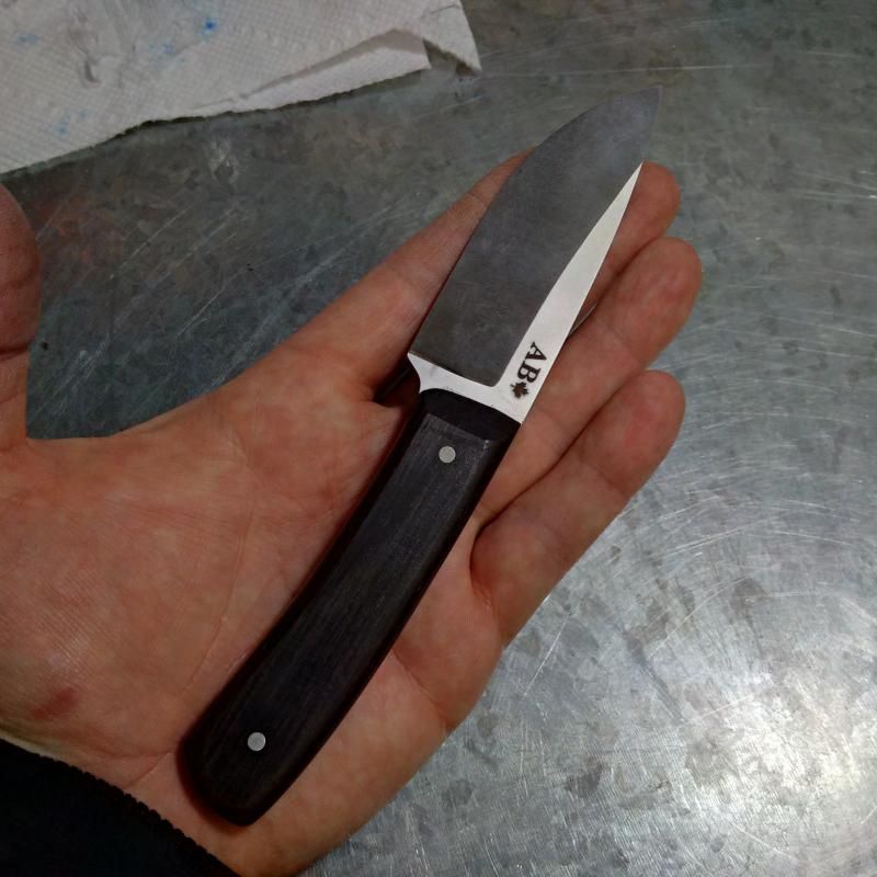

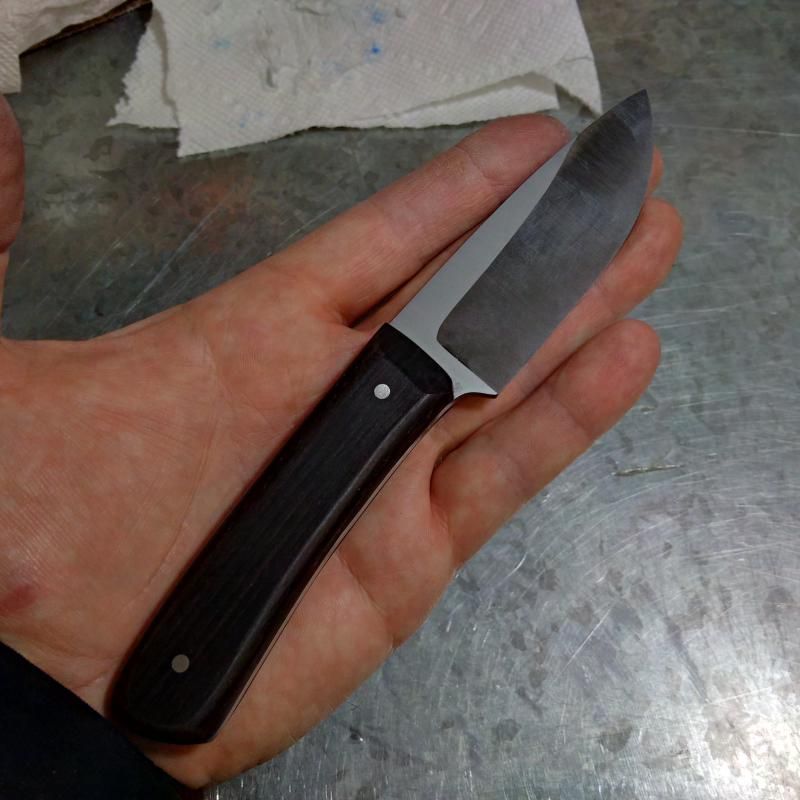

I'm still learning, but I think I'm getting the grinds fairly even.
