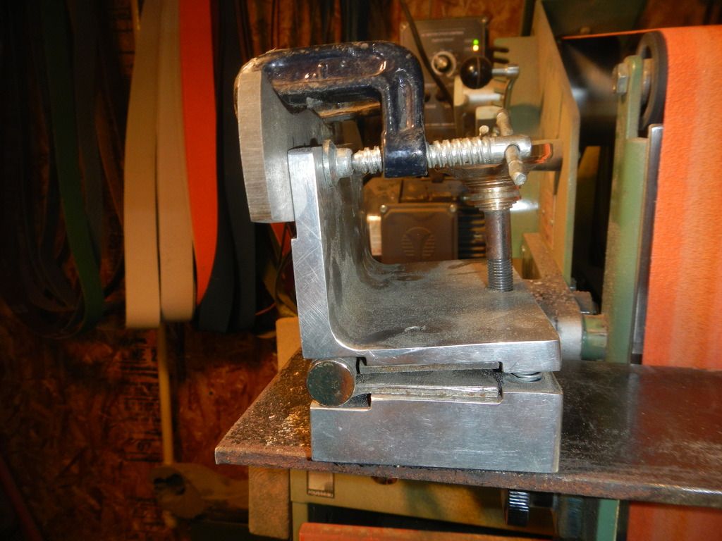

I disagree. All the jigs that allow grinding of both sides have two inherent problems; the blade is cantilevered out away from the base which creates the opportunity to have the friction of the belt pull the blade downward and if the knife is not mounted absolutely plumb to the base, the grind angles will not be equal. This jig may not be faster but, I think it is going to be harder to make a mistake using it.
Bob
this is how clare fixed the issue with the blade moving or being pulled out of place. it has a 1/8 "shelf" milled into the front of the jig for the spine of the blade to rest on, preventing the blade from being pulled down at all. I have never had a blade move when the C-clamps are on even lightly.
the adjustment is done by fine threaded bolt that pushes against the base. Since the base is secured firmly with a huge spring with no play it makes for little to no play at all. the only thing that allows any flex at all is the springs and if I am pushing that hard, I am likely putting way too much pressure on the blade. I'm not saying it is the perfect jig, but with it I have managed to crank out knives with accuracy and repeatability that I couldn't match otherwise.
Just finished a bevel grinding jig... simple design... my platen angle is adjustable, so why bother with a fancy setup to adjust the angle of the blade?
Case hardened the components... not perfect, but should extend the life a bit from wear against the side of the belt. I'll look for tool steel to do the next version.

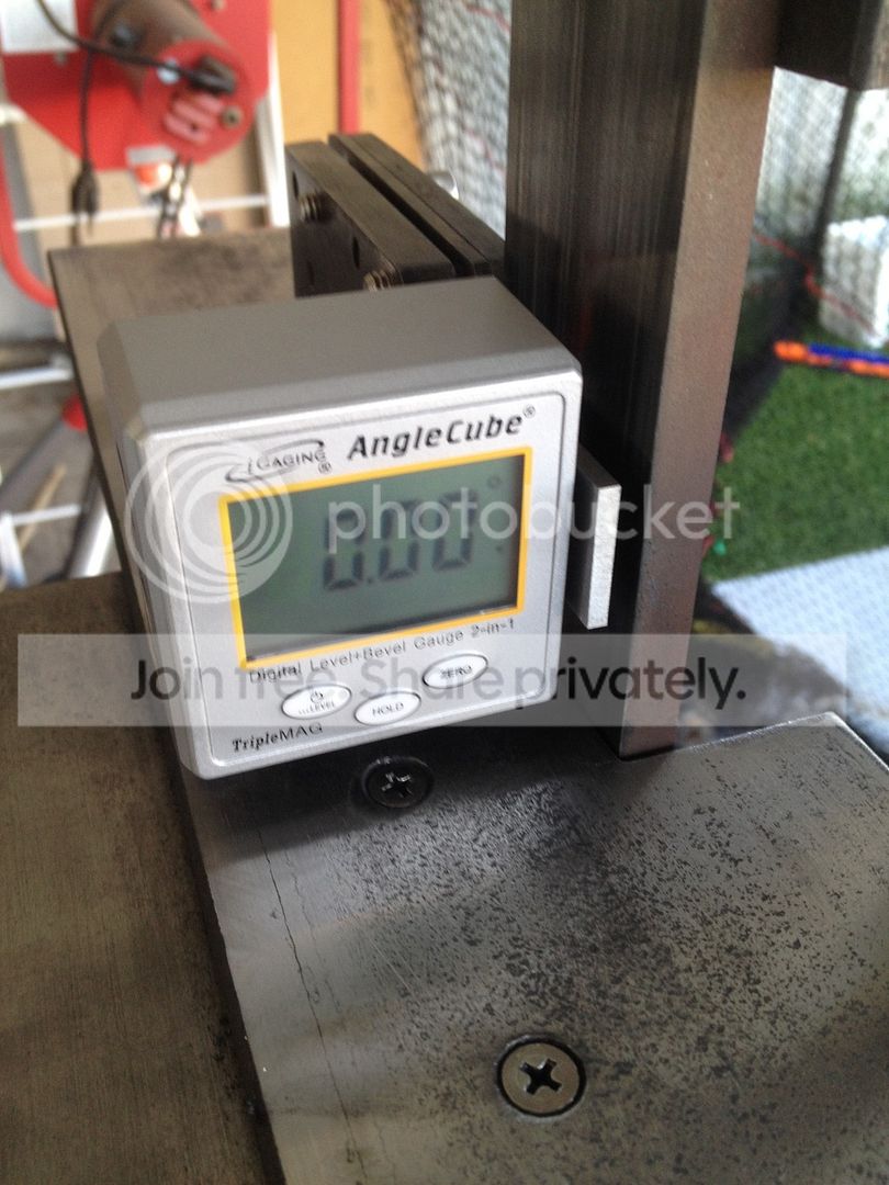

Just ordered an angle cube which makes it much easier to check that it's perfectly square, and to adjust the platen angle.

The photos show the jig with a parallel plate set up when I was grinding the base to get it square. Tested it out on a blank before I had it finally squared up, and while the bevels obviously weren't even, the grind was very easy to keep flat and the plunge line was nice and clean.
