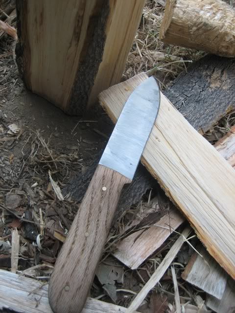

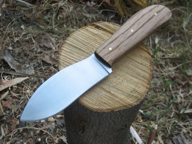

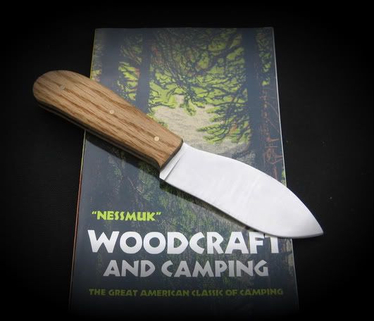

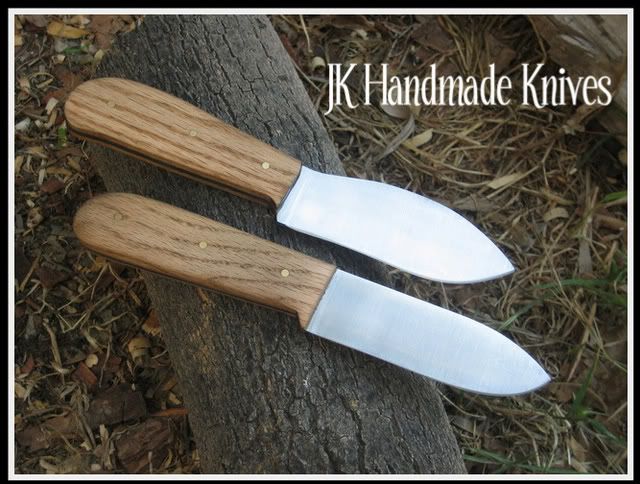

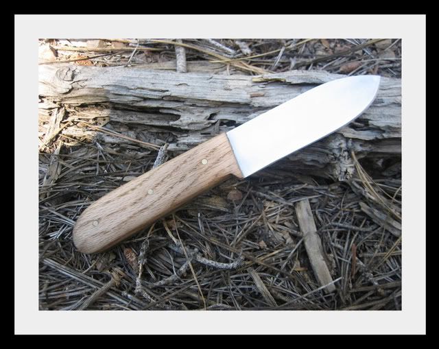

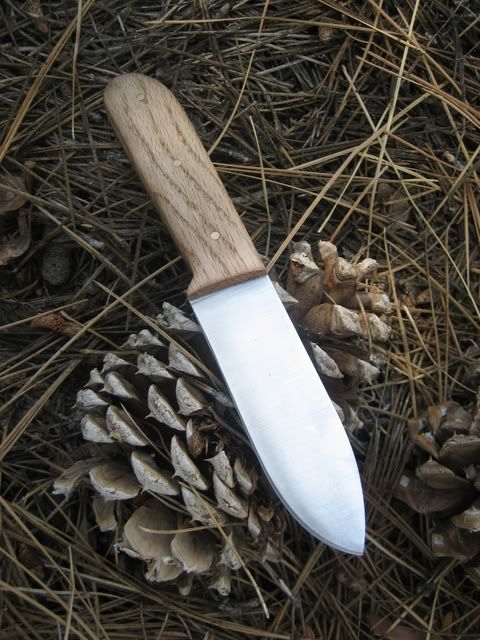

John’s package showed up just before I left town for some preparation hikes for Mount Whitney. Inside the package were a Kephart, Nessmuk, and Hiker. The Kephart and Nessmuk are the test pieces for this review. They are handsome knives built for real use. One thing I noticed about JK Handmade Knives is their Oak Handles. John will put whatever a person wants on them but his knives always caught my eye by the Oak. The Kephart and Nessmuk are made from 01 steel. Both are flat gound. John finishes his knives with a 400 grit satin look to them. I personally prefer this type of finish. It is easy to maintain and doesn’t look too, pretty. Blade length on the Kephart is 4-inches and 1/8-inch thick. Overall length is 8 ½-inches. JK Kephart weights in at 5 ½-ounces. Nessmuk has a 4 ¼-inch blade and is also 1/8-inch thick. Overall length, 8 ½-inches. Weight on the JK Nessmuk is 5 ¾-ounces.

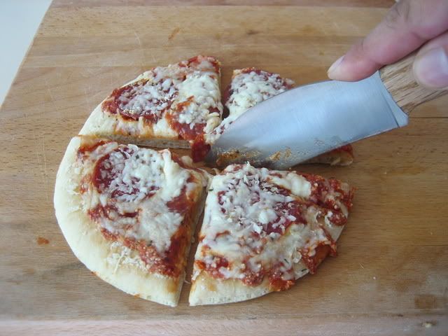

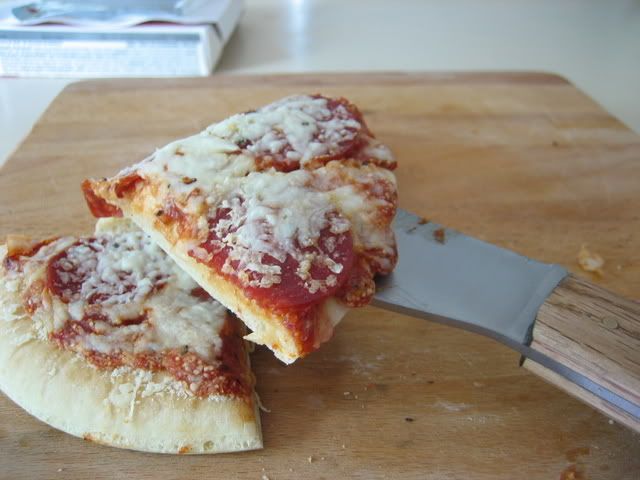

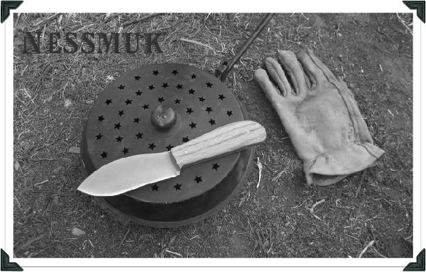

The Nessmuk was used for a week in the kitchen. This means slicing fruit, vegetables, cheese, salame, and all the other typical chores one could use a kitchen knife for. I did a few things with the Nessmuk that was a little more creative. One of those was slice pizza, not for me since I gave that up. It worked well as a slicer by simply using the belly of the Nessmuk with a rolling motion. This made short work of a small frozen pizza that needed to be cut. When the slices were cut the Nessmuk made a good server for the hot pie. This gave me another idea for later. I decided to eat some fish and rice with only the Nessmuk, no fork or spoon. The wide blade design did a good job scooping up rice as if it were a spoon. For a knife with an unorthodox design, compared to most kitchen knives, it sure did all the work of a conventional kitchen knife. I think every kitchen should have a Nessmuk!

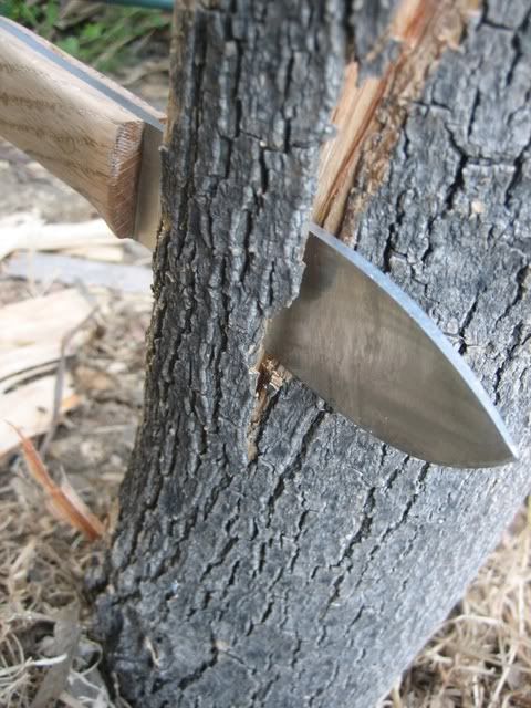

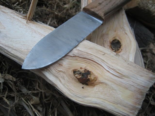

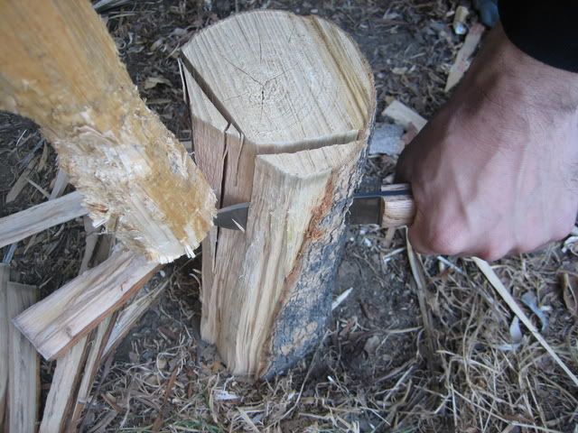

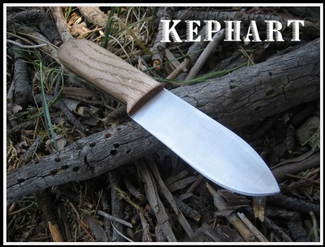

The Kephart was used to split a 4-inch wide log that was cut by the forestry. I did this with the help of a baton. This task is hard on a knife and some people consider it abuse. When attempting to split a log that’s diameter is the same or larger than the length of your blade, you don’t have much room to strike the tip of the blade with the baton. You must pick a spot on the outside of the round log to start your splits. Slowly work your way around making flatter corners. Get it as square as you can to make it easier to split. When there isn’t enough tip sticking out to strike with the baton try using the baton in an ice pick grip to get more pin point accuracy while striking the tip. Spear point designs are good for this, there is good energy transfer directed down through the wood, not back through the blade or handle. I split through a pretty hard knot that didn’t seem to want to give. The Kephart won.

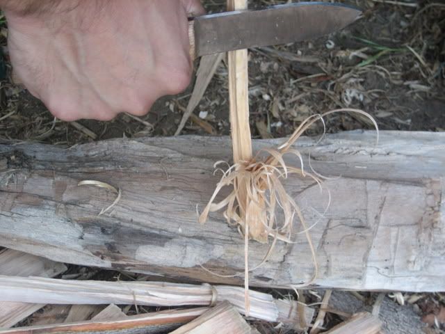

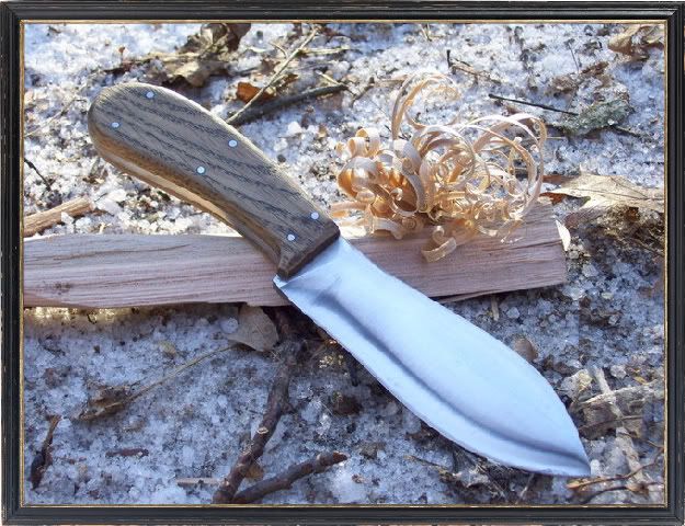

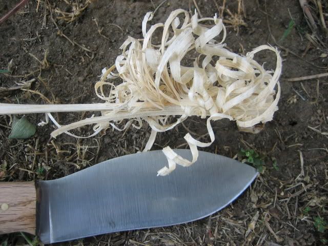

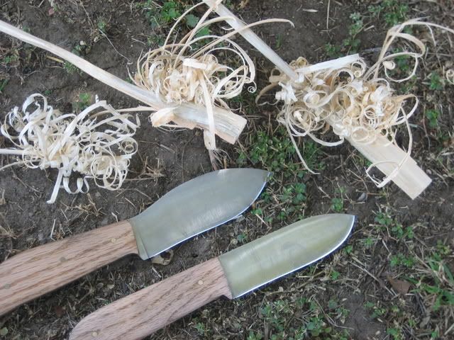

Whittling wood with both knives seemed to have different results between the pair. Whenever I make fuzz sticks with a knife that has some belly I usually get a nice curl out of the wood. The Nessmuk gives me that nice porky pig tail look to the curls. Both knives have handles treated with linseed oil; I had a confident grip without any real hot spots. I preferr the grip of the Kephart,and the curls from the Nessmuk.

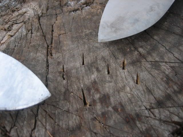

I don’t do too much stabbing with a knife but wanted to see what the tips were like as far as tip penetration. The Kephart had a better overall penetration with the spear point.
Kephart on left, Nessmuk on right.

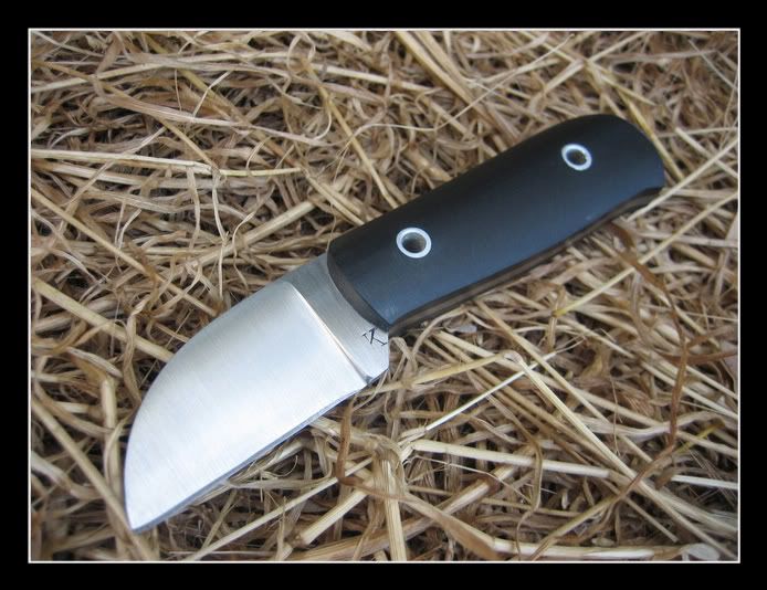

Hiker Wharncliffe
Hiker 4”/Utility/Hiker

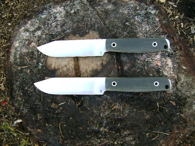

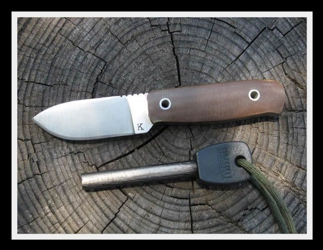

a 4 in. Hiker from John and it's a sweeet knife.I went with the 4in. blade with micarta grips.John took a firesteel I had and put micarta on it also.He then did me up a nice leather sheath with loop for firesteel and all this for under a $100.00!!!! I showed it to a friend of mine and he ordered 2 just like it.Quick turn-around time,quality and John loves making the customer happy...it won't be my last knide from him...:thumbup::D
Here are my two, ILBRUCHE took the pics as he made the pants for them.
Camp cook knife and EDC knife
[/QUOTE]
Tony you got the EDC? Nice you must post more of that bad boy! Something about the two tone micarta looks classic.
I will as soon as I get it, Ilbruche just finished the sheaths and shipped them out today. I will be mighty busy testing out knives this summer.
