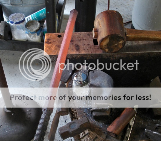

Here's a billet for the "stars" after the first weld, cut and stacked into 4
pieces, and two 13 layer billets tacked together for the first weld for the 13
"stripes." We'll have 13 stripes for Old Glory and the 13 colonies. I believe
we'll be able to count 'em on the blade,( if all goes well.)
A "stripes" billet in the forge just after the kerosene burned off. You can see
the carbon covering the billet, which protects the steel by oxidation-reduction
as it comes up to welding heat.
Welding the first 13 layer "stripes" billet under my little 25 lb hammer.
The billet for the "Stars" is welded a third time, giving 132 layers, and drawn
out to 9/16 x 9/16, cut into two 10 inch lengths, and welded to handles for
twisting.
Each bar is twisted "9 to the inch" or 20-360 degree turns, all at a welding
heat, one right hand, one left hand.
Each bar is then re-squared.
The 13 layer "Stripes" bars are cut to size, 1/2 x 9/16 x 10, and lightly etched
to see the orientation, and to check that we'll be able to see the layers in
the" flag." They are laid in place with the twisted "Stars" bars, in the way they'll
eventually be welded.
