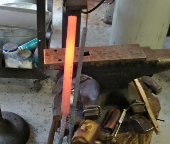

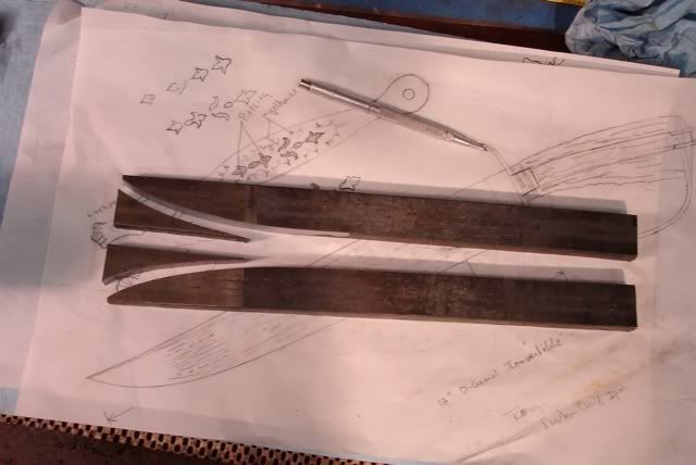

Welded the bars into two half-billets, 3 & 3, two stripes and one star in each:
When cooled, cut half the tip curve in the end of each bar, and saved the
cut-offs to make sacrificial anvils for welding the blade billet:

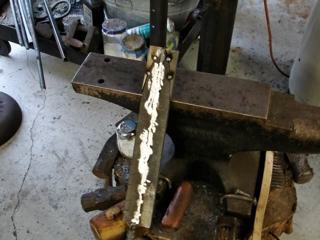

Heated each half up, forged the tips down straight. Then cleaned the center,
mating edges, lightly etched to check pattern mating, and MIG'd the two bars
together to make an air-tight "box" for forge welding, and tacked the tip
cut-offs in place:

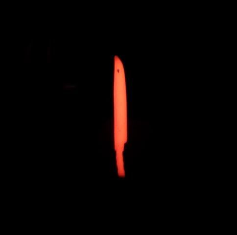

In one continuous operation, forge-welded the billet halves together, knocked
off the tip cut-offs, and forged the billet to profile:

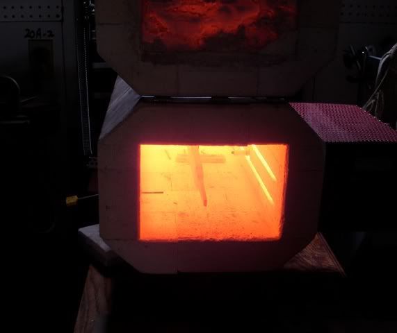

The forged-to-profile blade billet cooling in
still air after a 1600 F normalizing cycle. This cycle resolves most of the
residual stresses from the forging, evens out the grain size, and begins to
reduce grain size enlarged by the high heats of welding and subsequent forging
at a welding heat:
Damascus blade billet in digital oven-1600F
Following the initial normalizing cycle are three more, at descending
temperatures; 1500F,1450F, and 1425F. These cycles will further reduce stress,
and bring the grain size well into the the desired ranges for strength after
hardening.
Finally an hours' soak at 1200F, yields a semi-spheroidal, annealed state ready
for grinding and hardening.

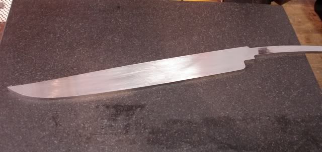

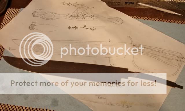

One thing I forgot to show earlier was the 1/16 " steel pattern, made from our drawing,
which I can lay against the billet as I forge, to get the profile just right, so I don't have to grind
away the pattern later.

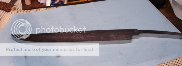

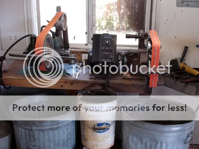

With the blade billet forged to profile, heat cycled, and annealed, I'll begin
by grinding the exact profile, using work rests , first on the wheel, then the
platen:
I want to have forged closely enough, using my pattern, so that only a bit less than 1/16, just
the decarb, gets ground off.
You'll note that the billet was forged at a constant thickness of 9/16." The
pattern in the "Stars" twists is in the center third, and all that extra
damascus gets ground away! Oh for a EDM machine and a surface grinder:

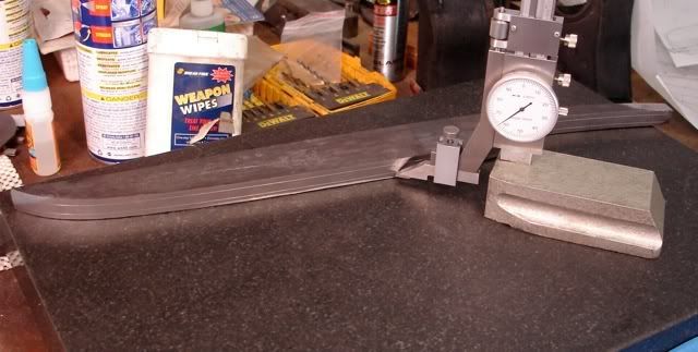

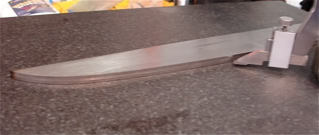

With the billet edge ground to exact profile, I can lay it on a granite plate,
and using a height carbide tipped height gage, scribe two parallel lines, 1/4
inch apart, centered on the edge of the blade billet, all the way around:

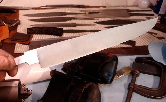

About 30 minutes, and two 50 grit belts later, here's a 1/4 inch thick blade
blank, ready for rough grinding to shape.

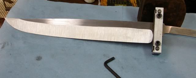

In preparation for rough grinding, the height gage is again useful, to scribe
lines .026" apart on the cutting edge, and guide lines near the tip for
pre-tapering:

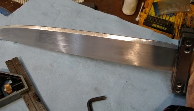

After "eyeball" grinding about half the distal taper into the blank, (the rest
will come automatically, due to the profile taper, as I grind the bevels) a
carbide faced shoulder filing clamp from Uncle Al is set where I want the grind lines.
I'll begin by grinding about a 45degree bevel on each side of the blade, down to the
two scribed cutting edge lines:
Grinding the 45 degree angles with a used belt removes the sharp corners from the cutting edge,
and saves the grit of the brand- new belt that I'll use now to grind the bevels.
I'll begin grinding the bevels, working with a new 50 grit Norton ceramic belt.
I'll grind side to side, alternately, working the grind upwards toward the spine.
At about this point, with the grind lines at the ricasso set evenly with the
shoulder-filing clamp, I remove the clamp, and finish the grind free-hand,
only because the clamp feels a bit clumsy in my hand, and I think I can tweak things out
a bit better without the clamp's weight.
After the 50 grit grind, I go over the blade with a new 120 grit, and another
new 220 grit, and clean the cutting edge and the spine with 220 grit, to remove any stress risers for hardening:

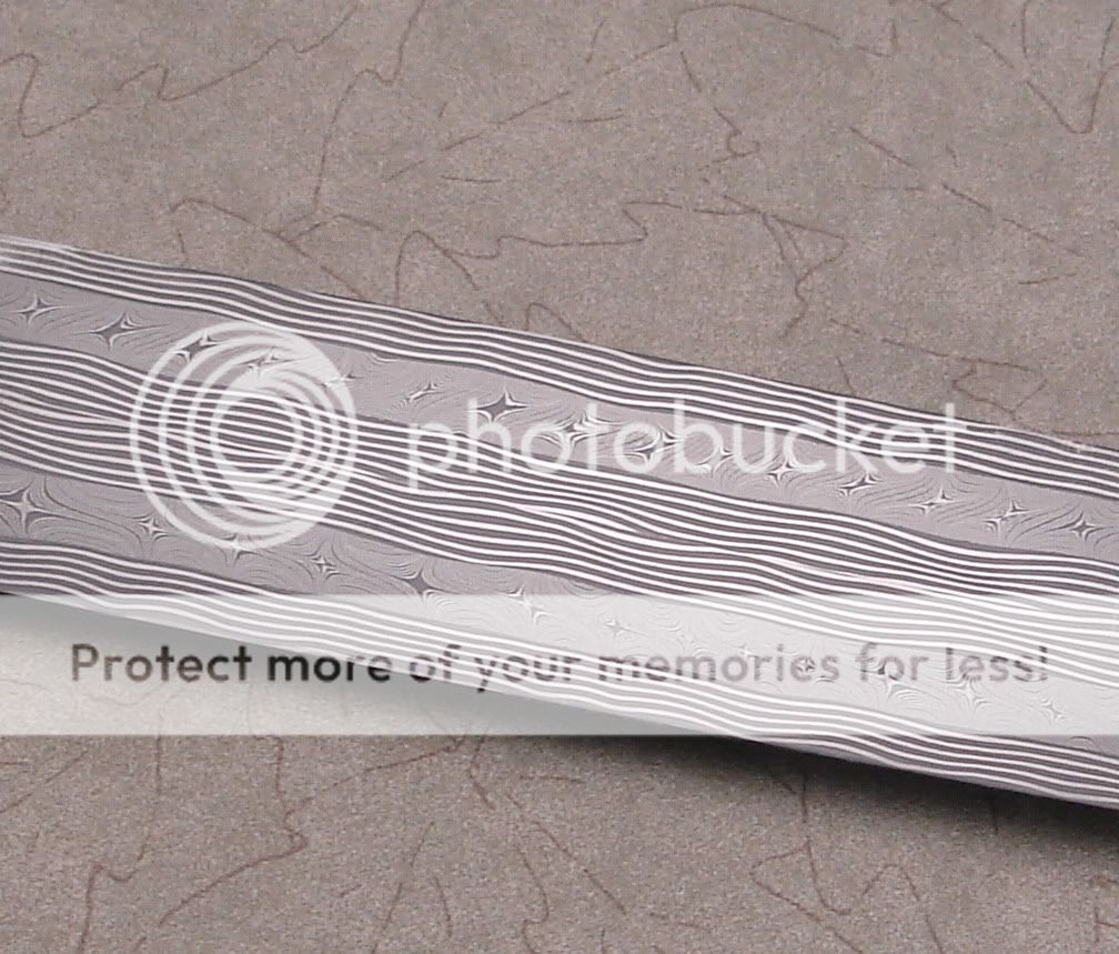

Here's a picture of the hardened blade with the quick etch. You can see what the pattern looks like clearly now.
This is, by the way, the area with the bad weld. You can't see it after the
etch, but I know it's there.
