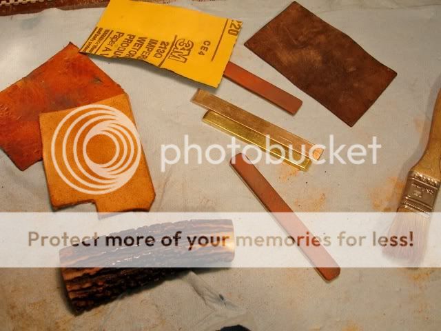

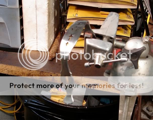

Next comes the sanding.
There's some file-work to clean up the ends, but the general shape is set.

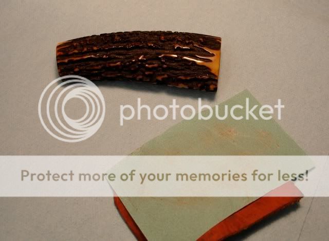

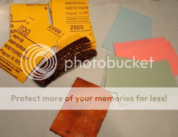

Now comes sanding, starting with 220 grit and ending with 6000 grit.
A word about sandpaper grits. 220 is still a shaping grit. It'll cut and remove
material. I'll use a brass strip, a rubber backed strip, and thick, stiff
leather as a backing, and finish out the shape.
320 cleans up the 220 marks , and still moves a bit of material, using the
leather backing.
400 and 600 clean up previous scratches, and at 800 I'll move out onto the
popcorn to begin highlighting.
1000, 1200, go quickly, and things begin to shine, 2000 and 2500 more so.
Then to the polishing papers, blue (roughly 2000 g) pink (4000) and green (6000)
These are the fun items. I wish you could see how the surface changes.
Sometimes folks are overly impressed with the work involved in going up to the
higher grits in finishing.
Really, the work is done below 600 grit. After that, things go very quickly, and
only a few minutes are taken at each higher grit.
I think it's hard to argue, though, that the extra time is wasted.
I'll finish cleaning up the bow, and do the nit-picking this week-end.

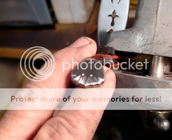

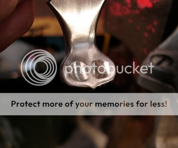

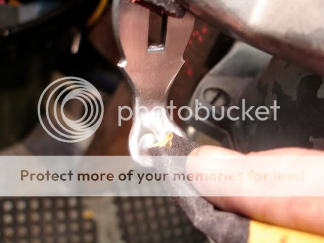

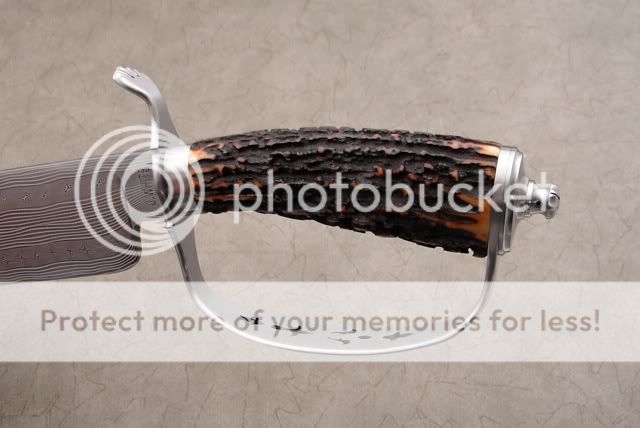

Construction is completed on the knife with the carving of the guard thumb rest.
The bow is sanded to 1000 grit.

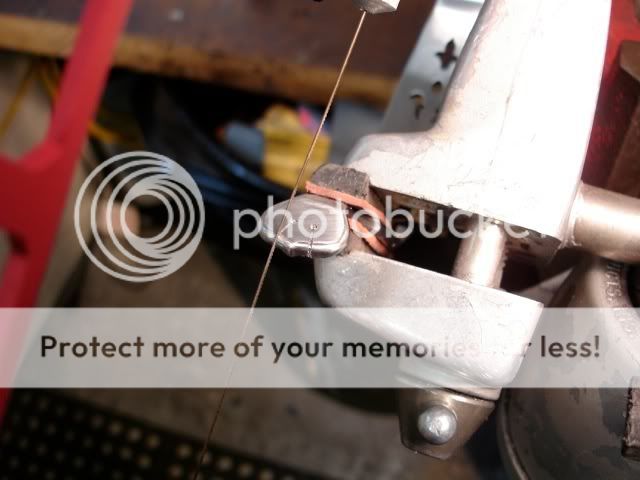

Tiny holes are drilled, and connected to the edge with the jewelry saw,
Opened with a knife-edge file,

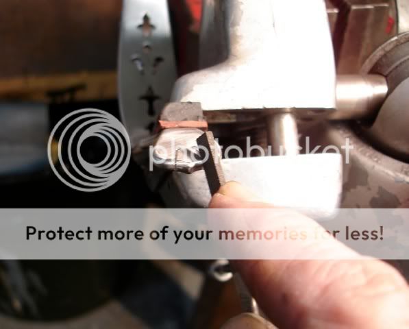

And the "paw" carved with chain-saw files,

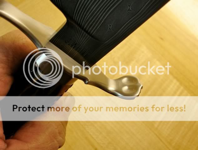

If we're going to call this a "lion's paw," let's grind out a couple reverse
"pads" with the dremel,
and sand them out with the corner of the rubber covered brass strip.
Here kitty!

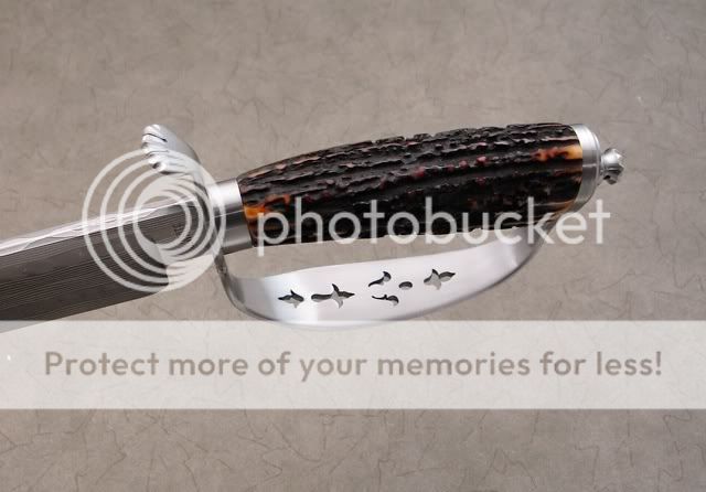

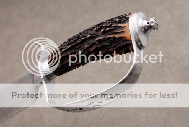

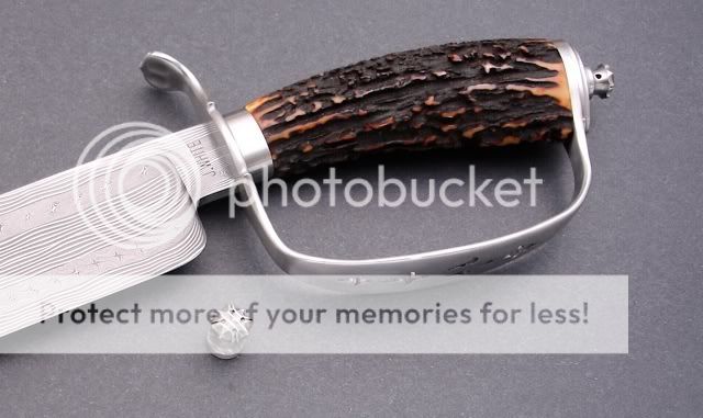

Here are some photos of the knife, construction complete, but with the fittings
not yet etched. We'll be etching the fittings after the gold wire inlay is
completed by Joe Mason.
I'll have to make up a sheath stud for Paul, to match the
finial, and a take-down tool, also with carved damascus head.

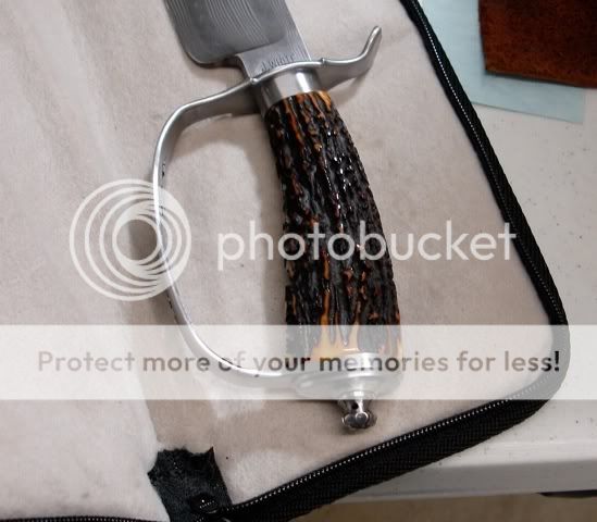

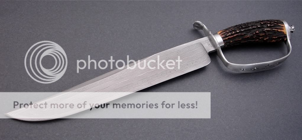

Here's the last two photos showing The sheath stud. (cool the way the strips carry through even this tiny piece of damascus).
And a full view of "Old Glory" before guard, collar, bow and butt-cap are etched and gold accents are added.
12-5/16" x 1-3/4" Blade of "Stars and Stripes" Damascus
D-Guard Bowie with Amber Stag handle and pierced guard bow.
There will be more photos after Joe, Paul and our professional photographer are finished.
