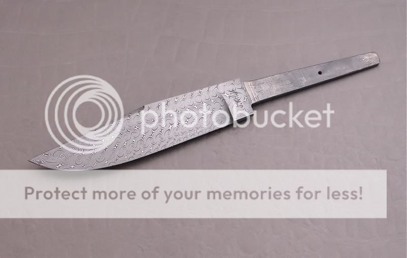

Update received from John today with two pics and the following descriptions in his words:
"I finish sanded the blade and fitted the guard today. Rough shaped the guard, and will sand out ready for JB Weld.
"I took photos of the blade before and after etching. In my opinion, one should not be able to tell a blade is damascus when finish sanded and before etch. That's when you can really tell if the welds are perfect:" (See photo in first post above)
"...The second photo shows the etched Turkish Twist 4-Bar Damascus blade, with matching weld lines, center weld running out the tip, and fair curve lines with no "hammer squiggles":
I'll post finished photos when done, but was so impressed with the etched blade thought I'd tack these pics on here for anyone who might like to see the blade prior to assembly.
Thanks to all for your interest,
Will

In the meantime, here's a slightly different version of the etched blade photo. The e-mail compression changes the looks enough to make me want to show an image a bit closer to what it looks like in person.
I'm hoping we can get a pro photo when this is finished.
John

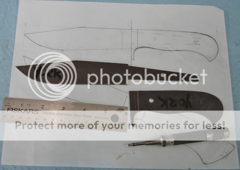

About a year and a half ago, Will posted up a hunter he'd designed, and had several makers create versions of.
I thought it was a neat design, and said so. Will contacted me and asked if I'd like to try my hand. Sure!

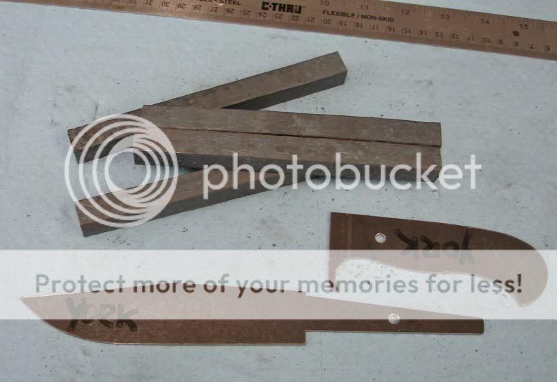

When the time came around, Will sent a full sized profile, and specifications.
I looked at this like the old boatbuilder that I am, as a commission to hew as closely as possible to the designer's intent.
The first step was to make 1/16 inch mild steel patterns of blade, including tang, and handle.

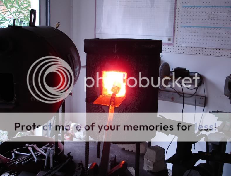

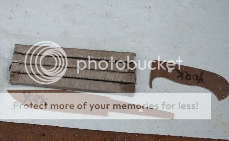

Into the forge went a 13 layer billet of 1084 and 15n20. Will had asked for a Turkish Twist Damascus blade.
With the billet welded and drawn out to 1/2 x 1 1/4 x (about) 12 inches, it was cut into thirds, for stacking and 2nd weld.
Since I want a bold pattern, I'll draw the low count 39 layer billet out to 9/16 x 9/16. and cut into only 4 pieces, for a bold 4-bar.
And twist to 12 "Threads" per inch, so the stars will stand out strongly, even for old tri-focal wearing geezers like me.
