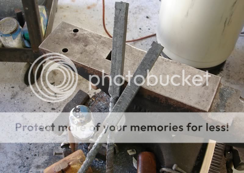

The bars were twisted two right-handed, and two left-handed, at a welding heat.
One right-hand bar is welded to one left-hand, and the other two similarly, to give two matching 2-bars.
Here's where we start the matching patterns, cleaning and etching the ends of the bars, to align the layers in each bar, matching the starts of the twists closely, and welding the bars as straight and evenly as possible.

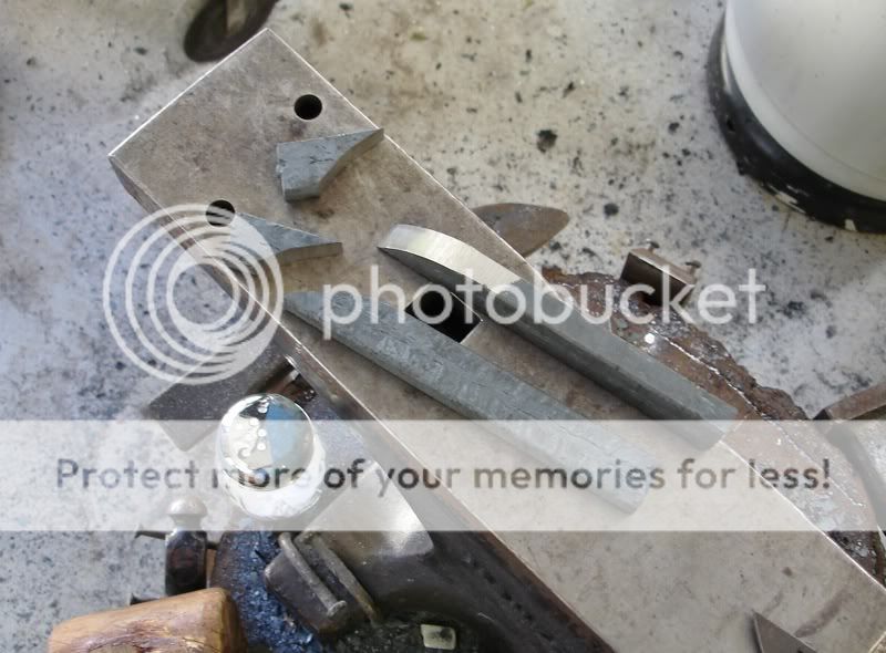

I come down the soon to be mating and welded edges of each of the double bars, the length of the tip taper of the blade.
Then I cut a curved triangle off the tip end of each bar.
This curved tip is then forged down straight, so that the weld lines of each bar will meet at the center line.

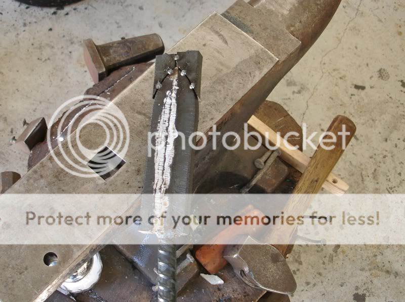

I'll grind the new mating edges clean, and quickly etch to be able to match the lines exactly.
Then I'll "zip up" the two bars with MIG welds to form an air-tight "box" for dry forge-welding.
The cut-off triangles are tack-welded to the new tip, so I can weld the bars together in a straight line.
Usually, I can knock the triangles off with the power hammer after welding. If not, I cut them loose with the side grinder.

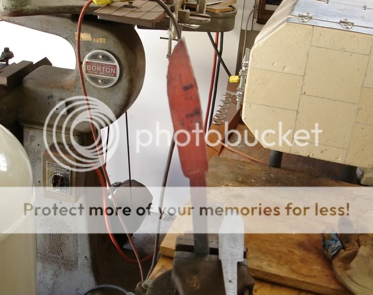

I now have a pointed, straight, 4-bar billet, with the center weld line coming out the center of the tip, and all other lines meeting in pairs.

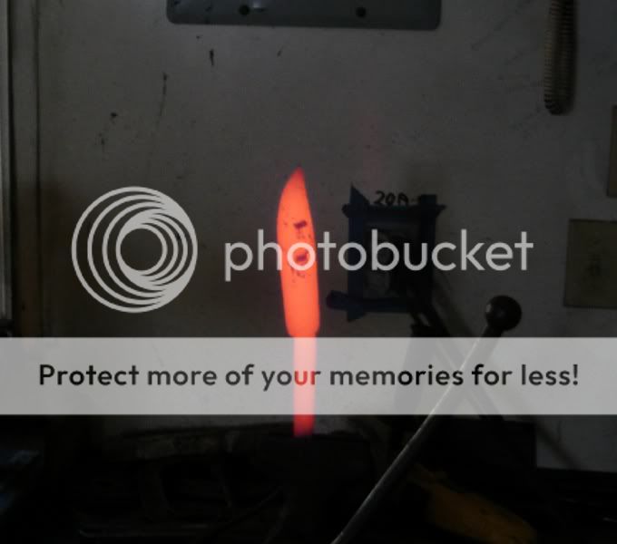

The billet is still 9/16 thick, and I can forge it down straight to the max width, in this case, about 1 1/4," of the blade.
The trick is to forge this billet to the profile of my pattern, placing the tip of the billet at the tip of the blade, without hitting the billet in any way that will distort the (unseen) pattern within, while maintaining an exact 9/16 thickness.
In this case, we have two straight, intersecting lines on the spine, a curved front cutting edge, and a straight taper for the back 40% of the cutting edge.
Here we go.

As I draw out the welded billet, I'm using spacers in my press to square up the bar, in this case to 9/16ths square. When I'm ready to twist, I'll set 5/8 spacers, and knock the corners, to "octagon" the cut bar to within a half inch of the ends. This lets the bar twist tight without the "threads" being too deep. I haven't seen any difference in the pattern from twisting square or octagon. Immediately after twisting, I'll re-square the bar to 9/16. Then, when ready to weld bars together, I'll grind the mating faces of the bars flat and straight on the platen. I'm taking pains to keep the bars straight and square at all times.
To allow a dry weld, I'll knock a tiny bevel along the clean edges, and with the feed turned up a bit on the MIG, I'll run a bead along the seams to seal the billet. Then I'll grind the bead flat to reduce the amount of weld metal that gets press into the billet as I keep pressing it back to 9/16ths during the weld. You can see this in the photo where the "triangles" are tacked on.
This mild steel MIG material will only extend a bit less than 1/16th into the billet, and since the pattern is in the center third of the billet, will be ground off entirely. I've found that this "dry"method not only gives a cleaner weld, but eliminates the penetration of the "threads" into the center of the billet. The billet welds "up to" the Mig, and is solid. ( Does this make any sense? )

The billet only has to be hammered lightly to make the weld itself. Since I'm after the pattern in the center third, and i'm going to lose about an eight of an inch in the Mig grind-off, I like to stay at least at 1/2 x 1/2 for the initial bar. Most of the patterns I like look better the more that is ground off the outside.
Starting here with 9/16 x 9/16, I ground the inside edges of the first (double bar) weld. That left the two double bars at about an inch x 9/16ths after welding , and squeezing back to 9/16 ths thickness. Grinding off the new mating edges, and welding up still left me at about 1 7/8ths wide x 9/16ths. I'm careful not to hammer heavily while welding, both because I may be after a wider blade, and because I don't want to distort the pattern. I do most of my welding along the long axis of the power hammer dies for this reason.
When the weld is set, I can then put spacers in the flat dies in the press, and squeeze down to my max blade width+ about an eighth. Since I wanted a blade max of 1 1/4, I squeezed the billet to 1 5/16ths exactly. The hand forging to profile loses a little, and I want to end up only enough wider than the blade to profile grind off decarb. The profile forging usually gets rid of most of the "thread" grooves.
Planning ahead on these low number bars has to take into account all the elongation and reducing that is planned. For example, knowing that I was starting with a wide billet that I'd elongate, I twisted the billet tighter( 12 to the inch) than I would have for the same Bowie blade from that same width billet (probably 9 to the inch.)
