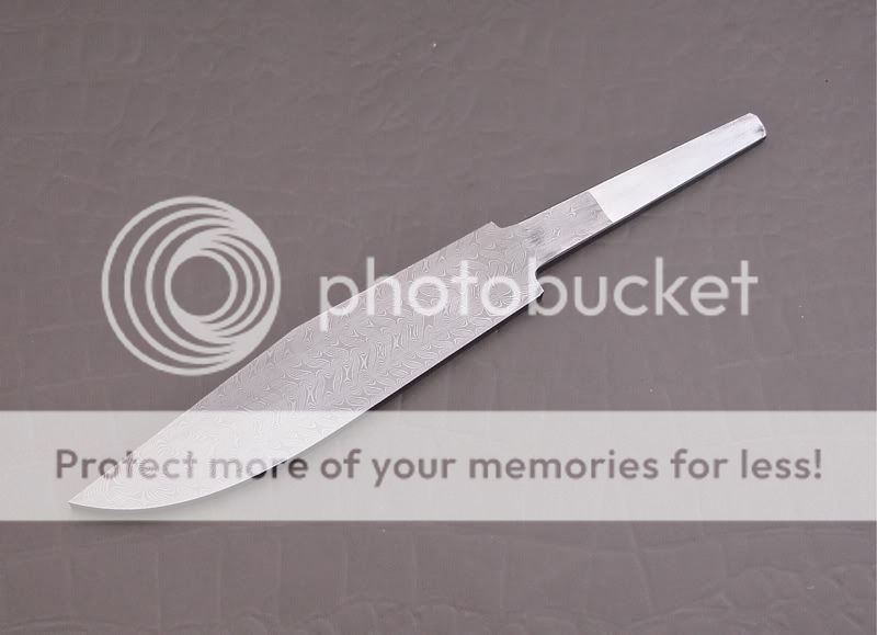

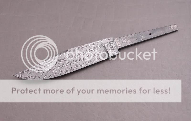

Here's the, let's call it a blade now, ground to .220, and given a quick etch. This is the first time I can get a look at the pattern. Sometimes this is when I get to add to the scrap bucket. I'll have nearly 15 hours into a Bowie billet at this point.

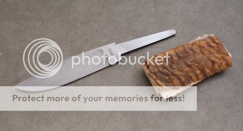

I sent this pic to Will, and asked about fine details such as exact thickness , taper, etc. Will wanted about 3/16ths at the ricasso, with a strong distal taper, and an essentially zero bevel final grind.

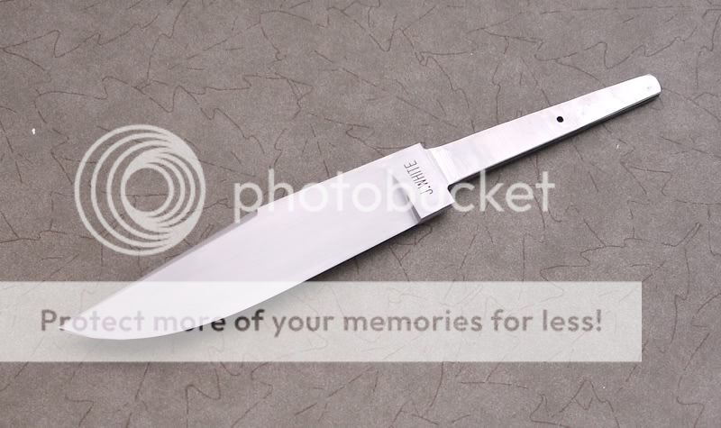

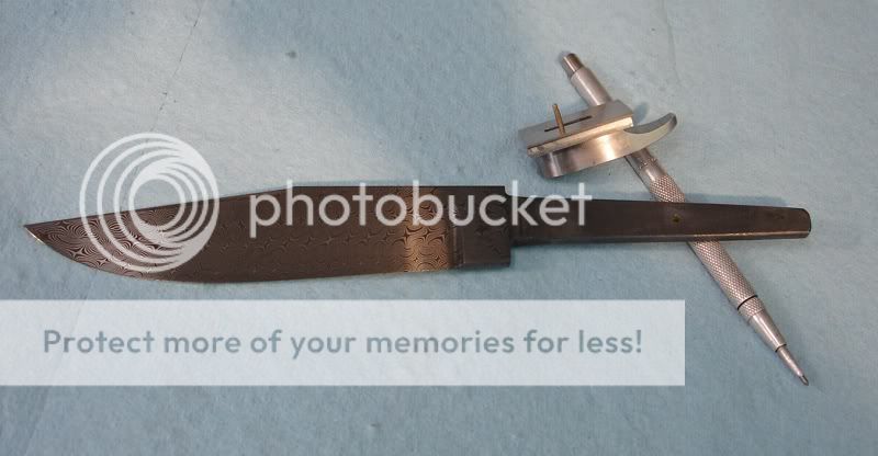

Here's the photo you saw at the beginning of this thread. The blade has been ground to .183 at the ricasso, distal tapered, and the edge ground to about .025 for hardening without warping. The stamps are on the ricasso, and I've done a final stress relieve soak at 1150 F for an hour. It's ready to harden and temper.
Here's it is, hardened, tempered at 420 F, the clip draw filed in, and sanded to 1000 grit.
And here we are up to date, the blade etched, and ready for guard, collar, and handle.

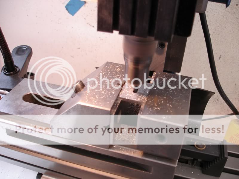

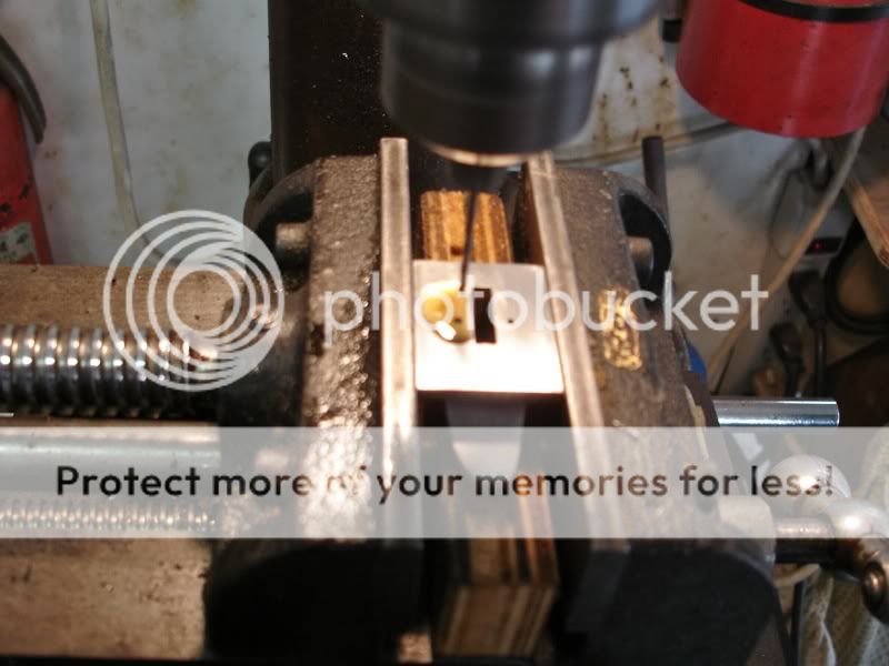

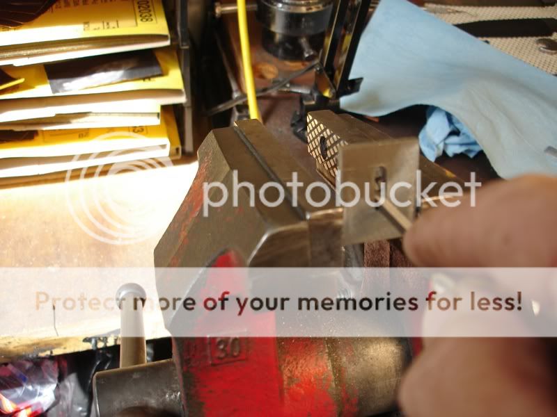

After slotting the collar on the Micro-mill,
and cutting the slot square on the ends with a "two-safe-sides" square needle file,

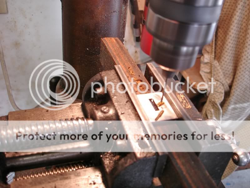

I can drill a pair of #52 holes for a press fit for 1/16" assembly pins.

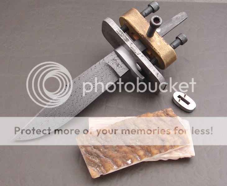

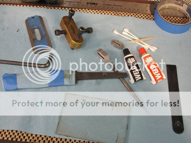

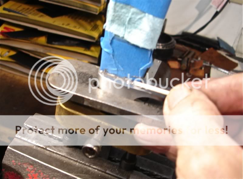

Here comes the fun part. Setting aside the collar and spacer for later, it's time to JB Weld the guard in place. The guard is 90% pre-shaped, and I can do the same for collar and spacer, but I like to do the final shaping of all three on the blade as a unit with the scales, so now's the time to glue up the guard. Here's all the necessary supplies.

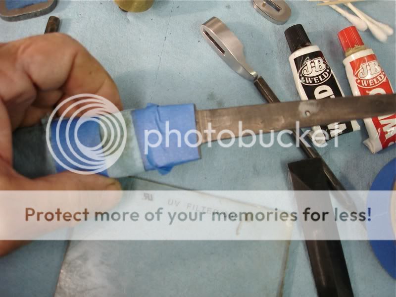

I'll tape off the ricasso, leaving only a 64th or so exposed next to where the guard will fit, then clean the tang and shoulders with acetone.

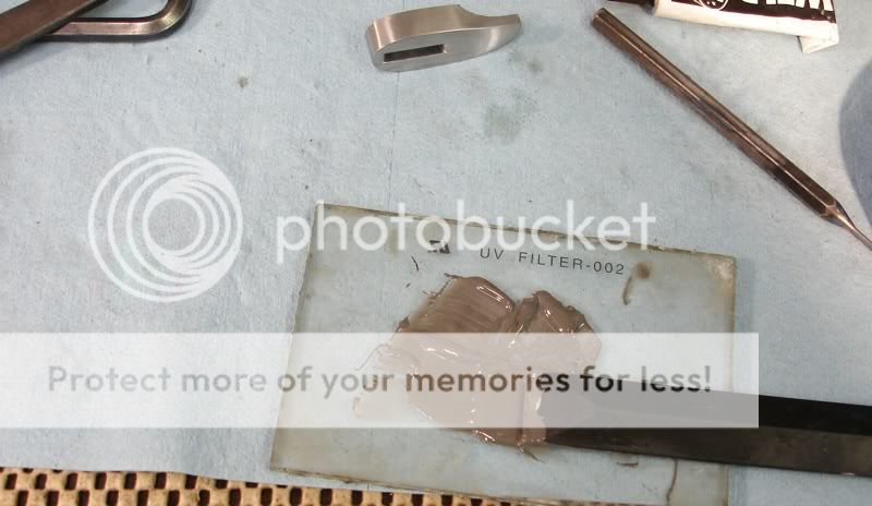

Mix up the JB Weld,

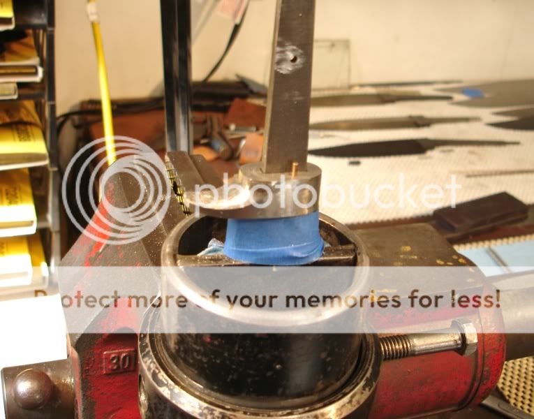

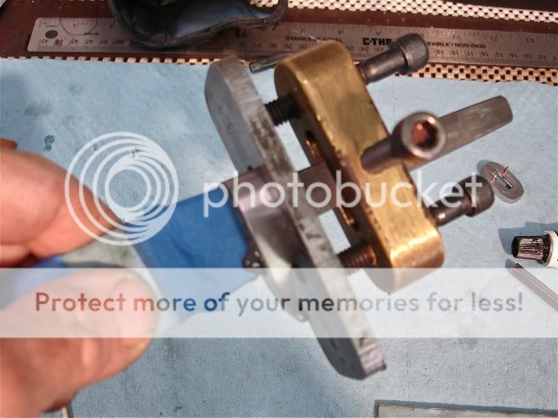

Apply to tang, shoulders , and guard slot, and press into place with this fixture. This is a massively sturdy version of a "Mike's Soldering Fixture" I bought from Uncle Al. It was useful as could be, but was designed to hold a guard firmly in place while soldering. I used it to press fit guards onto tangs, until I destroyed it, since it was made of aluminum. This one I made of bronze, with hardened screws, and a steel pressure plate. I can screw- press tight fitting guards down into place, applying a huge amount of pressure, without anything touching the blade.

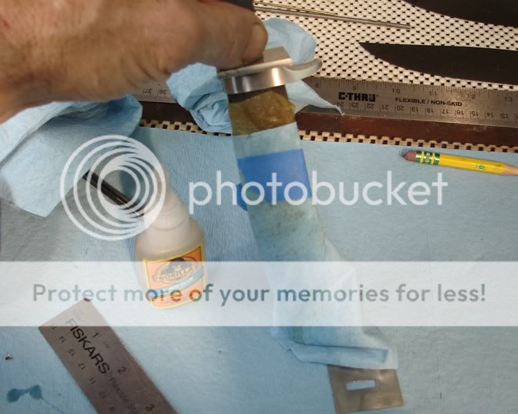

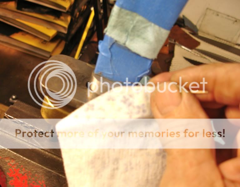

Grabbing the tang in a vise, I'll use a tiny wooden chisel made from a tooth-pick,
and a piece of flannel moistened with WD-40 to clean up the JB Weld. The tape keeps the gritty JB Weld from marring the ricasso. WD -40 is a good solvent and rust preventative while I work.
With the JB Weld completely clean, this puppy can set up over-nite, and we'll be ready to final shape the guard/collar intersection, and install the sheep-horn scales.

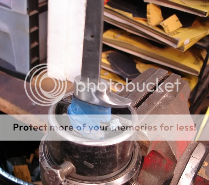

The guard was 90% shaped before installation, and now that it's solidly in place, it's time to finish out the guard/ collar/ spacer unit.
Holding the blade in a padded Moran vise from Uncle Al, I can shape with a chain-saw file.
and sand out to 800 grit.

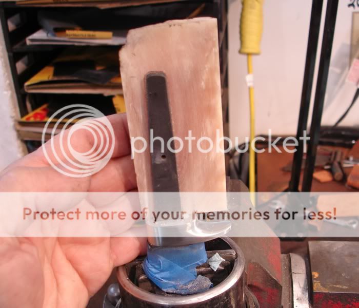

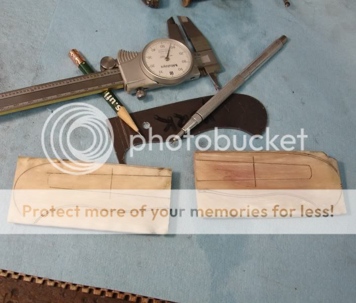

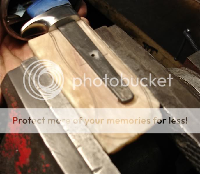

With the guard/ collar unit finalized, I can hold one scale, already cut and flattened to thickness, in place for scribing to the tang. I can also mark where the front meets the spacer.

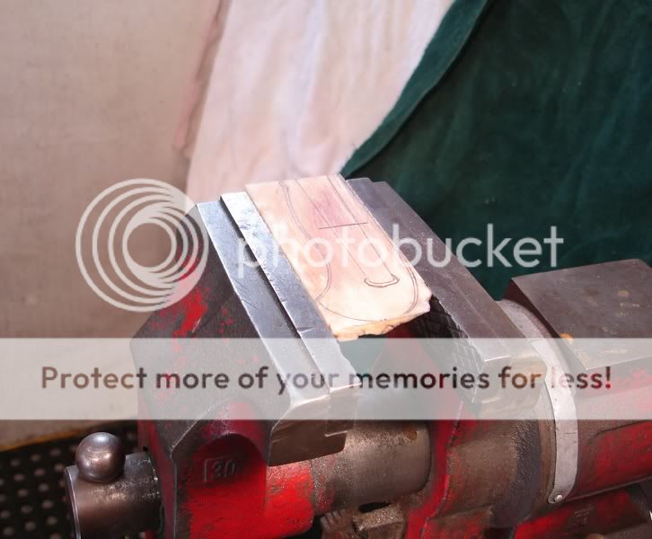

Using my handle pattern and the scribe marks, I can mark out the handle and tang on both scales. I've also cut the scales to parallel, so I can grip them in a vise for routing and drilling.

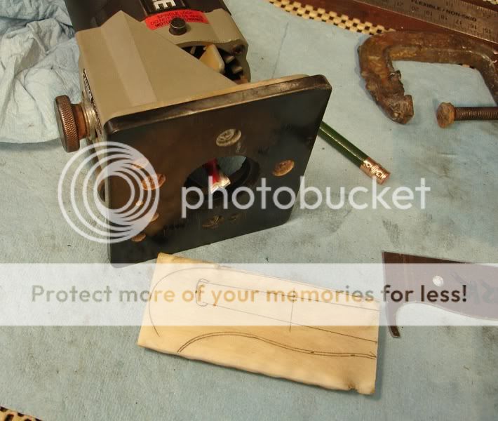

To route out recesses for the tang, I use a Porter-Cable laminate trimmer, with a 3/8 carbide tip, 60 degree dovetail bit. The P-C is easier to handle for small work than my big router, and the dovetail bit cuts easily, and leaves a small under-cut to grab the epoxy. Note that I'll cut the sides of the tang rabbet exactly, but cut extra at the end, so it won't bottom out when I press the handle on.
I'll set the scale up in the vise, and free-hand the rabbet. With a good router and sharp bit, it is easy to cut right up to the line.
Note that with a tapered tang, by setting the router depth to half the thickness of the tang at the ricasso, and then, in a second cut, to half the tang thickness half way up, you can have the tang contact the scale rabbet at two points. Also note the undercut.
With the rabbet complete, the tang fits tightly, and is recessed half-way into each scale.

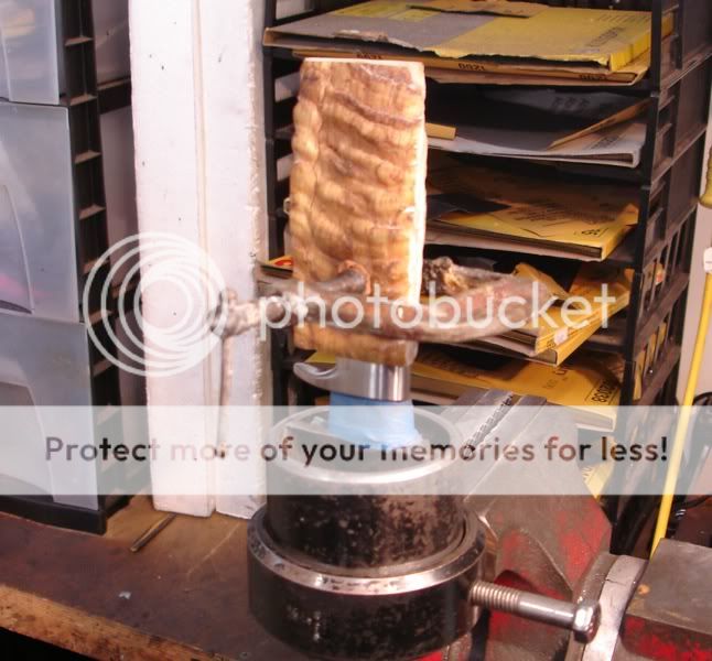

Now, I can hold the scales together lightly with a c-clamp, and, having put some SuperGlue on the spacer, slide the scales down on the tang and capture the spacer for back-drilling.

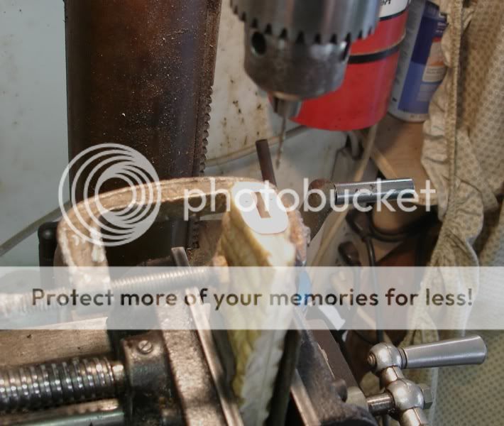

Back-drilling the spacer holes into the scales will re-locate everything for glue-up.
the next step in prepping the scales for glue-up is to drill a series of matching holes in each mating scale face, to capture epoxy as "blind epoxy pins" to help bond the scales.

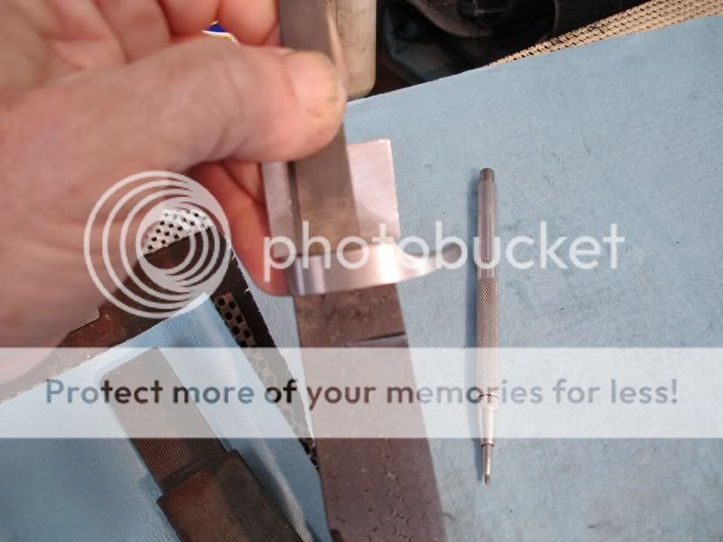

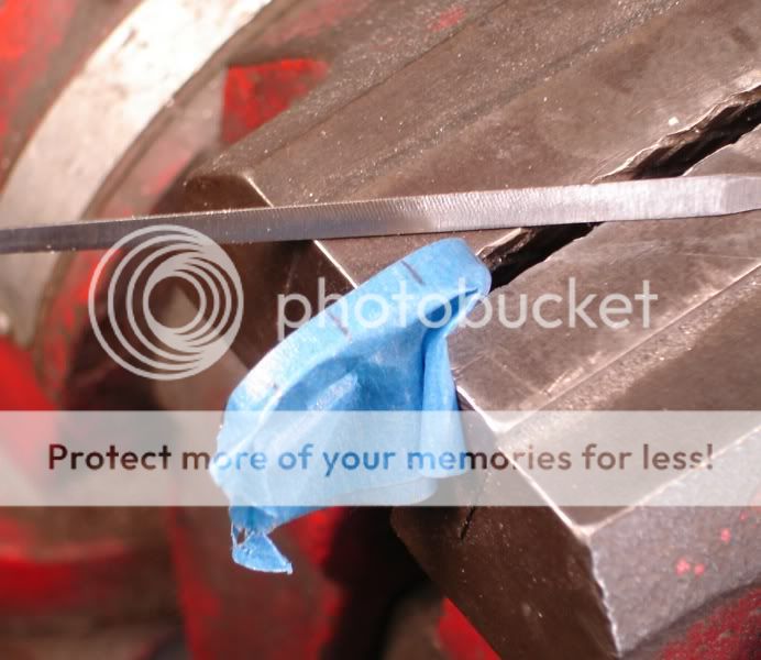

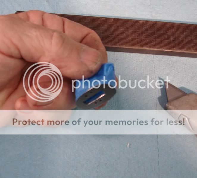

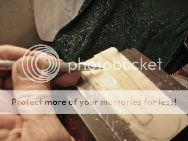

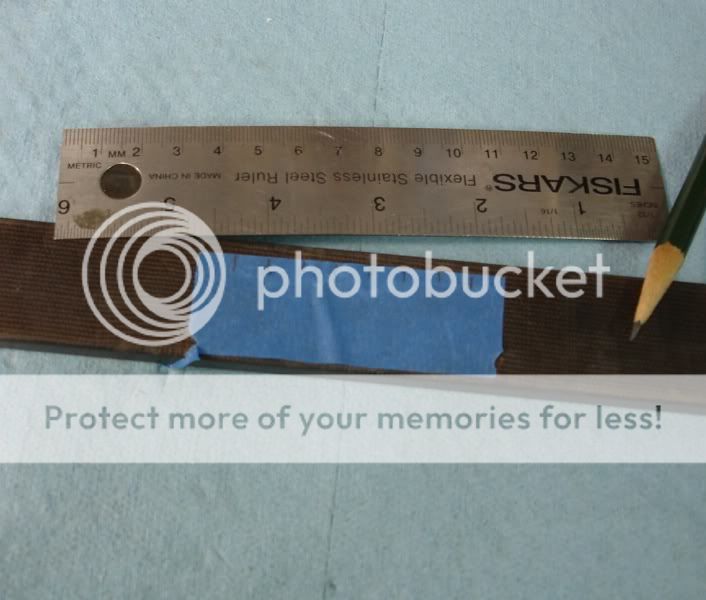

Will asked me to include a file-worked collar as sort of a "Trademark." Now's the time to do the file-work. In my own compulsive way, I like to mark off the collar evenly, and an easy way to mark off something with a complex shape is to wrap a piece of blue tape around it , and cut the overlap with a razor knife. ( Did they make knives before blue tape?)
Then the tape can be laid flat, marked,
and the marks transferred with a triangle file.
