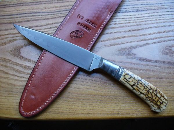

Is there a place to find pictures of MS and JS knives that have passed the tests? I would like to print them out as inspiration when I am working in my basement as to what to look for in terms of flow, finish and design. I have found a couple here but would like to add as many as I can. If you have a pic of yours that you would like to add to this thread please do and I would love to hear WHY you picked the designs that you did.

These pics are of Bruce Bumps JS and MS test knives.
Bruce's dagger is one of my all time favorite MS test knives, but do you think the judges would look askance at that sawback knife today? Jim Jackson told me that someone commented on a hollow ground knife that he submitted...but it passed anyway:D

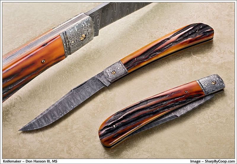

Don used this folder for his MS (2007)

One of Don's Hanson's MS fixed blades:
And another Hanson MS test folder:
