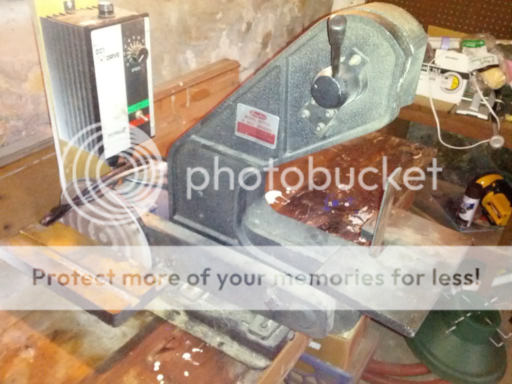

Just bought an old dayton sander
Jan 30, 2010
493
its a 2x42 belt, 9" disc, 3/4 HP
Paid $60, think I did ok?

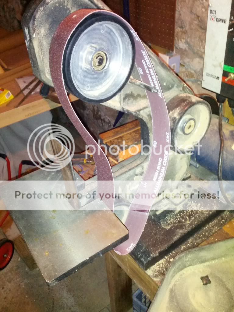

When I looked up the model it stated 2x42 belts. it's actually not 2x42.. its something else. I used a string to measure around the wheels where a belt would fit, and it came to around 52" would that mean i need exactly a 52 belt? not sure how belt sizing works.
here's a picture of it with a 42:

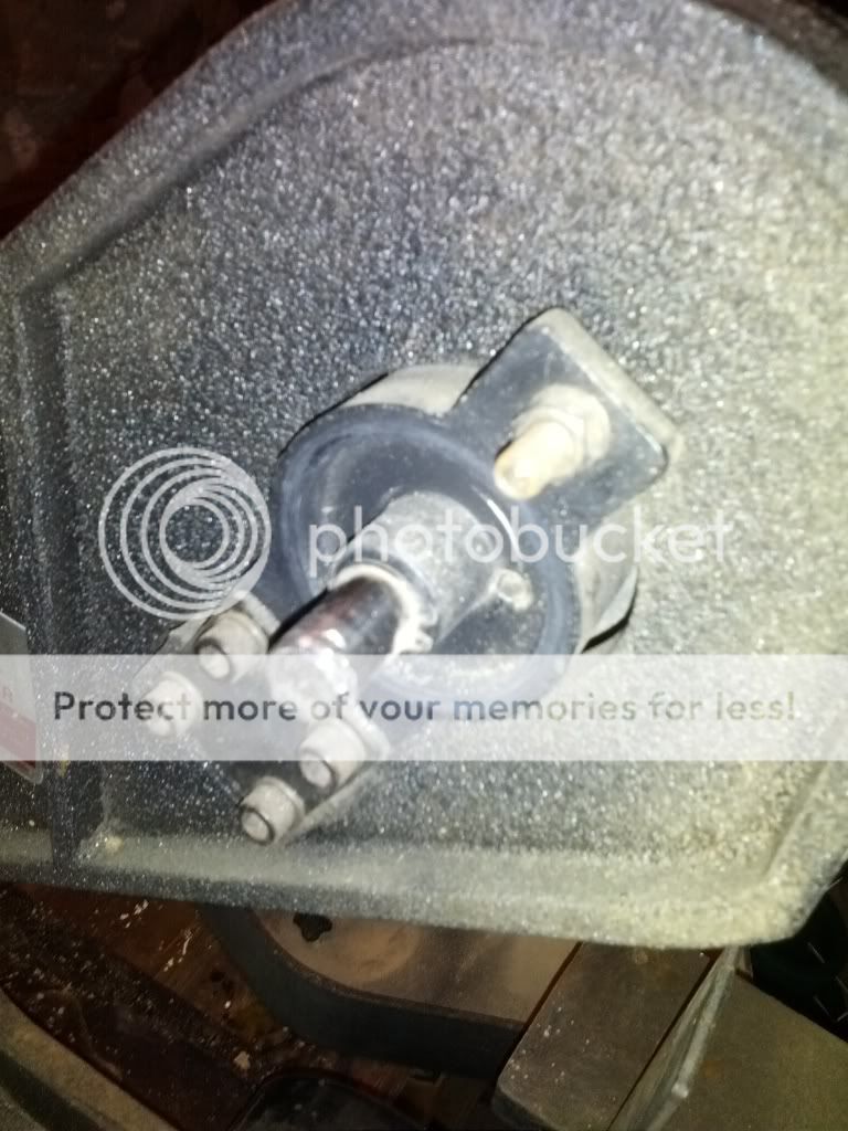

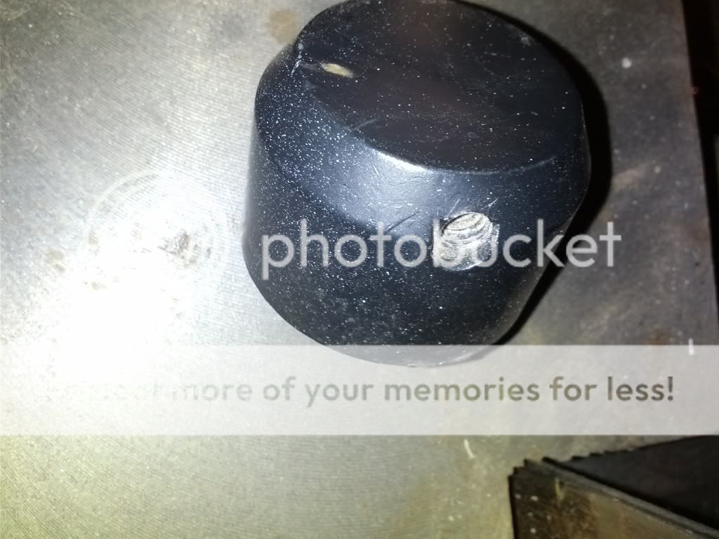

also the belt tensioning lever needs some work: the screw that tightens the lever down broke off and it's stick inside. might have to drill a bigger hole for a new one or find another way to secure the lever.
here's where it goes

Theres a little tool called an easyout that should get you going with the broken screw thing
if you set your tension pulley to minimum what does it measure then, I would think that would be your belt size, rounding up to the next whole number
fixed the screw issue. the belt is ~53".. looks like I'm screwed, lol.

Check to see if you could use a 60" belt that would get you back to a more common
size. You may or may not have enough take up on your tensioning.
Ken.
I measured where a belt would go with a string, it's about 53 so both 60 and 48 are too far. a 48 would never fit, and a 60 will be too big.
it was comical with the 42" cant even get around 2 of the 3 wheels
I'd start with the name plate on the side.
what's the model number, goggle it and find a manual.
sometimes the belt size is right there in the model name.
More than likely, one or more of the wheels has been replaced with a larger size. Is the platen waaaaay forward, or is that an illusion?
-Mark
-Mark
Yeah, now that you mention it that top wheel looks a lot newer than the rest of the machine. Not sure if it's big enough to cause that much of a change in belt length but who knows....
