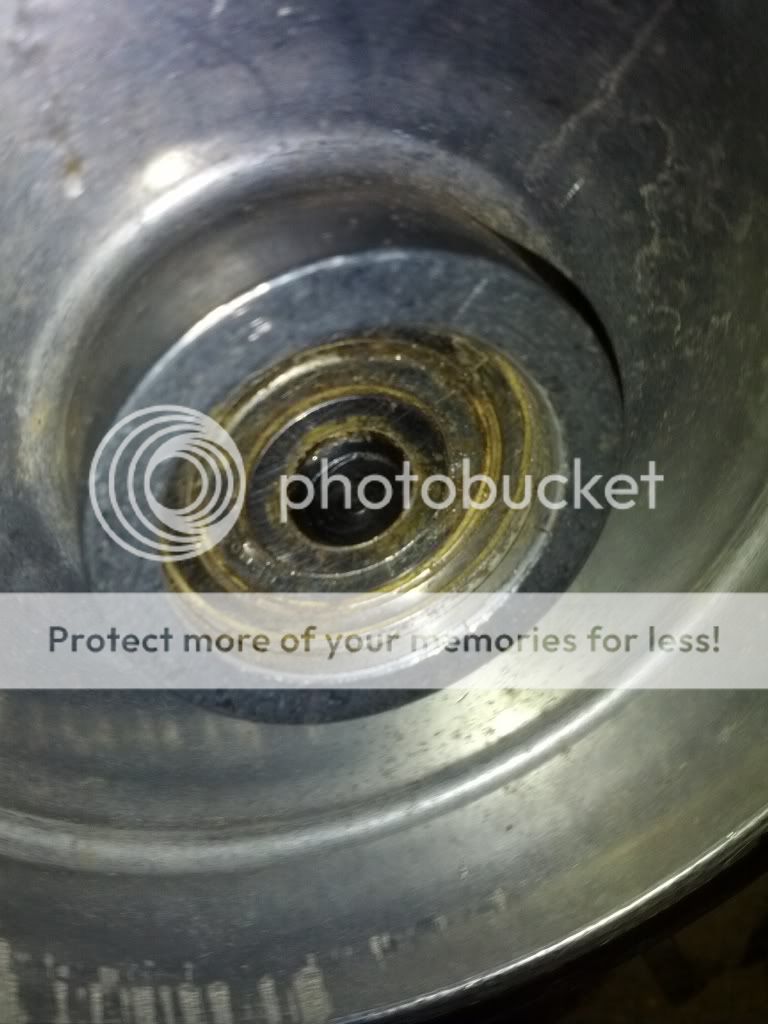

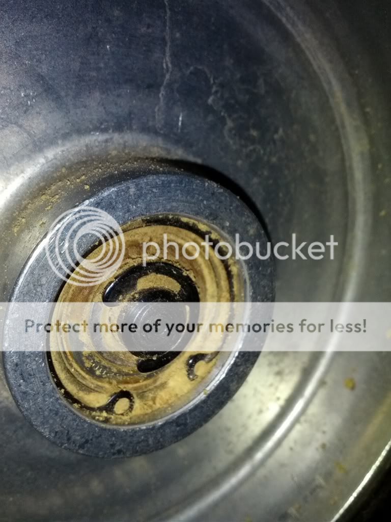

any idea how to get this type of wheel off? there's a small screw on the other side but taking it out didn't seem to phase it... I really don't want to break it.
Get a screwdriver and pry off the e-clip, and a snap-ring plier or thin-tipped needlenose plier to remove the ring...wheel should slide right off.
looks like you only need to remove the center snap ring, I would guess if you remove the outer ring the bearing will slid out

The black outer ring or the one under the eclip?

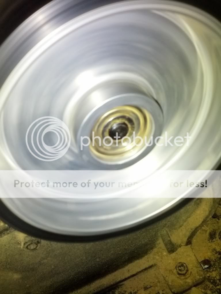

Got the two clips off. Still won't come off.. there's a washer type bearing under the e clip that's keeping it on. Any idea how to remove it?
I would take a brass rod and have someone lift on the pulley and drive it through, if you don't have a brass driver then carefully use a 3/8 or 1/2 inch ratchet extension, there is probably gunk in there from age a little wd40 wont hurt
at this point it should just slide off though if it were new? I did pull on the wheel hard enough for it to move the whole machine
ya thats what I am thinking, it looks like it has moved enough to cover up the groove that the e-clip was resting in
edit- it takes a surprisingly small amount of dirt to stop a bearing from sliding off the shaft
