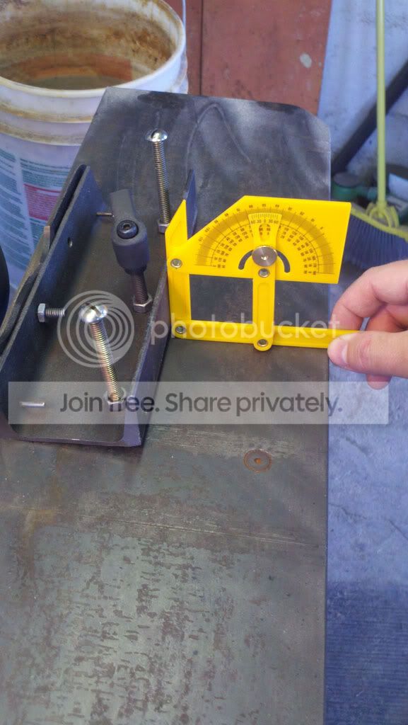

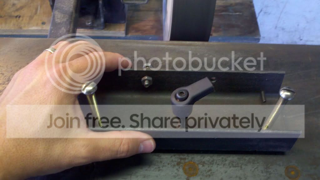

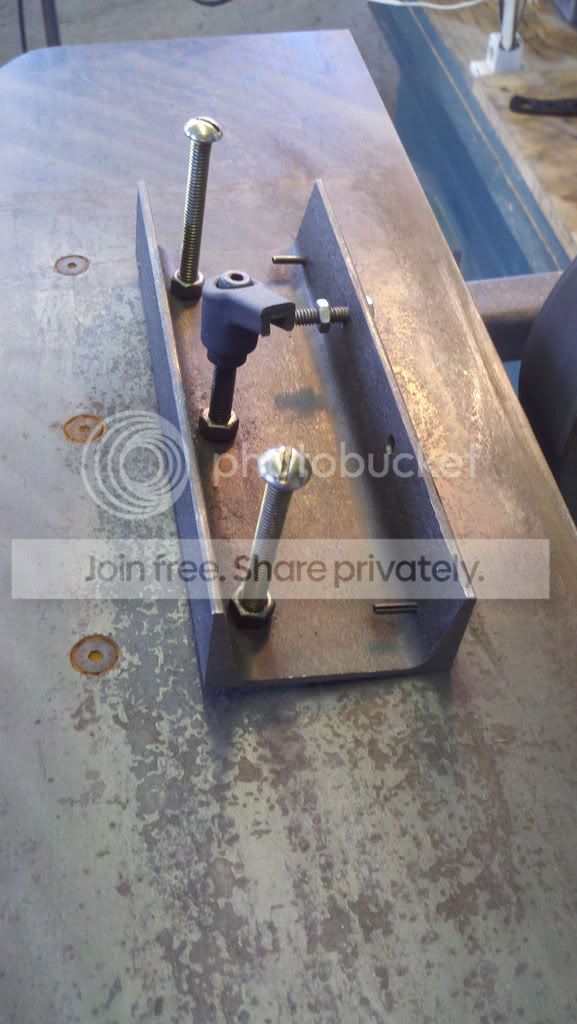

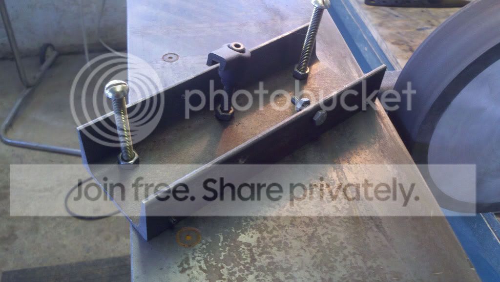

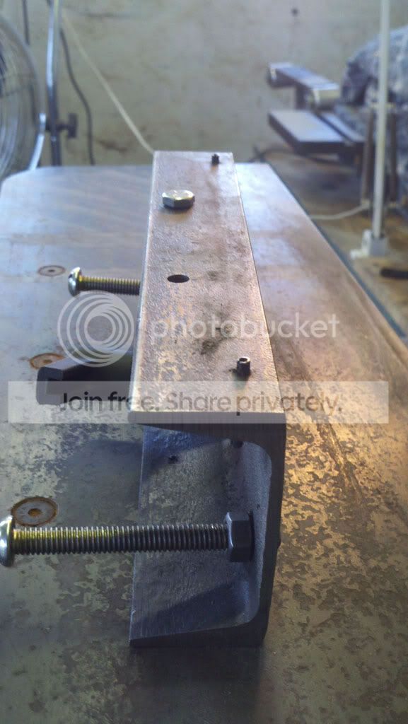

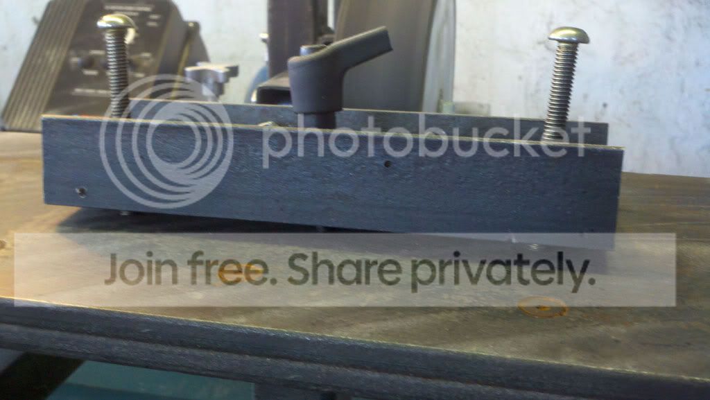

Are those grinds freehand? They look very clean!!

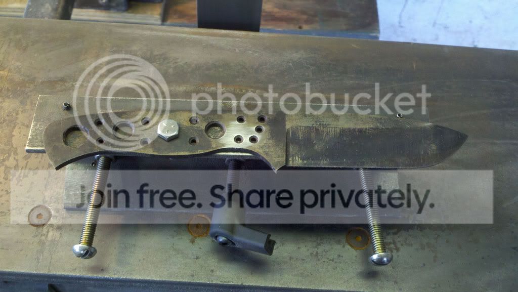

I wish they were, and I hope to get to that point someday, but for now I built a jig out of 3" C channel to help keep the lines straight. I've practiced freehanding a bit and I'm sure it is quite comical to watch :D

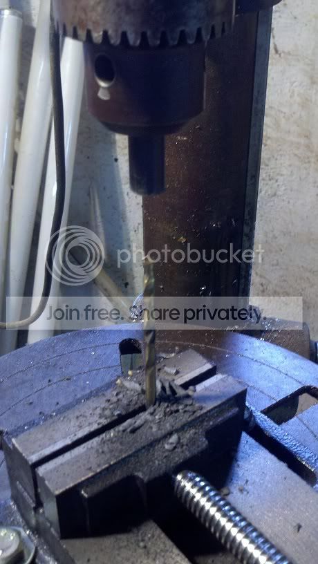

Very nice work! I like your unique pin/tube layout. What is the pin/tube material?
Thanks! The pin and tube material are carbon fiber (1/8" and 1/2") purchased online from DragonPlate in New York. The 1/2" tube was a solid piece. I loosely chucked a 3/16" bit upside down and lowered it into a drill press vice. I then chucked the 1/2" carbon fiber rod and drilled it that way.
Hopefully, this picture will make sense:
