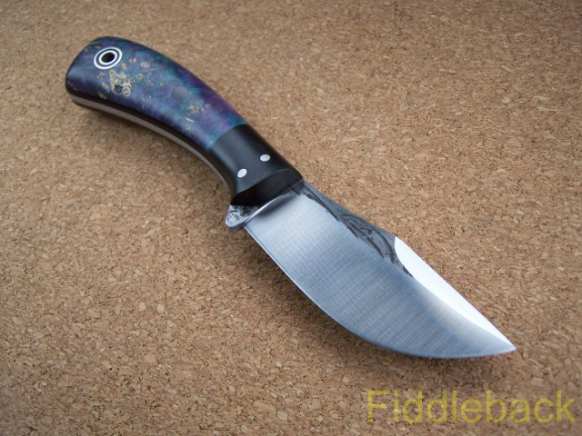

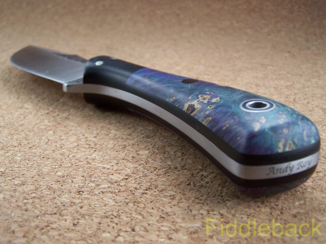

Just thought I'd post pics of this one here. Came out nice I think. The design is by Kismet, a freind of mine, and poster here. He calls it the Practical Hunter. Pretty double dyed Box Elder burl. Black micarta liner and bolster. SS and black g-10 pins and a CF bullseye liner. Steel is 5/32" thick spalted 01 steel. Your thoughts appreciated. Edited to add that the grinds are all convex. Including the swedge/false edge.
I like it too! Definitely a Fiddleback and the gorgeous box elder is a great touch.
Lovely piece, Andy.... what is the pattern on the blade bevels? Is that 2-directional sanding or a reflection? It looks very uniform and intentional... I'm not doubting you grinding skills... I have seen what you can do, brother. Any close-ups avaiable?
Ha. Thats the damn oil on the blade. I guess I didn't wipe it off well enough.
