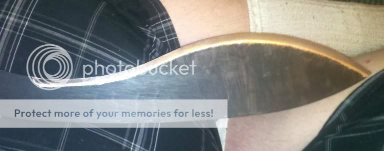

Just got a Cold Steel "Kukri Machete"... Are they all this dull?
That's not an edge, sir. It's a bonus spine! You got two, for the price of one! That's what we call "value".

Ah, Cold Steel's infamous utility edge. The only utility in it is if you need to practice sharpening. Yes, it comes dull, but put a back bevel on it then sharpen it and you'll have a fine cutting piece. I prefer a 4-5 degree per side (dps) back bevel with a 15-17 degree edge.
Wow that sounds like a lot of metal to remove, do you do it with motorized equipment or by hand?
Took me a while with a metal file to get the "utility" edge into a real edge, but it's still pretty obtuse and assyemetrical. Either I'll need to buy a round file/hone or send it to someone to get it done proper but it definitely works miles beyond what it came as.

Keep checking your edge for any rolling--the factory grind can be a little burnt because of how coarse of wheels they use to apply it, so it takes a few sharpenings (or one good careful grinding) to get past the burnt part into the good steel.
Will probably reprofile it once I can get a round file and a concave sharpening rod. Right now though it's doing pretty good, like I said I think it's more technique than the tool. I thought maybe it wasn't sharp enough to grab onto the soft greener vegetation, but I just took a swipe at a tomato and it went through it without even flinging it off the table top.
Didn't notice any rolling and I did quite a bit of chopping with it today too just basically trying to beat on the edge, held up fantastic. Was actually really surprised about the wear resistance since it's only 1055
I'm thinking maybe it needs to be a bit more of an accute edge, but it actually seems like it is between 18-20 degrees per side already. I think I just need to learn to strike at more of a diagonal better.
I sharpen my machete's with a belt sander from harbor freight. I bought several different grit belts. The final edge is polished convex and goes through wood like a butter. I haven't had a problem at all with chipping.
Way better now! Chops through thin stuff like it wasn't even there, and goes through thick stuff like a hatchet.

I'm going to have to respectfully disagree with you on the sharpness point, and for a couple of reasons.
Firstly, sharpness and edge angle should not be confused. An edge is chiefly make more durable by virtue of its angle. Thusly I can (and do) put a screaming sharp edge on splitting mauls and they see a large boost in performance even though they're still very THICK and they are not rendered any more prone towards damage because a dull edge is already damaged. Keeping a dull or rough edge on a cutting tool so it doesn't get damaged is sort of like buying designer jeans with the knees already torn out so you can't wear a hole in them. The edge angle needs to be matched to the task, but common machetes can be brought down to 15° per side with a hair-popping edge without issue.
Secondly, "field" or "working sharp" edges are as such not because they are the ideal for the tool but because in the incidence of damage during field use it is often more important to simply get the damage repaired to usable sharpness quickly so you can get back to work rather than taking the time to bring it all the way back up to ideal sharpness. When at home or at "base camp" is an appropriate time to then further refine the "working sharp" edge back up to ideal sharpness.
Cutting ability is all about geometry, and that's determined both by the refinement of the edge bevel apex (i.e. sharpness) and the geometry behind that apex (i.e. both edge and grind angles.) If one of those factors is lacking, so will cutting ability, and the work becomes harder. Rough edges will cut, but they do not cut as well as a sharper one does.
