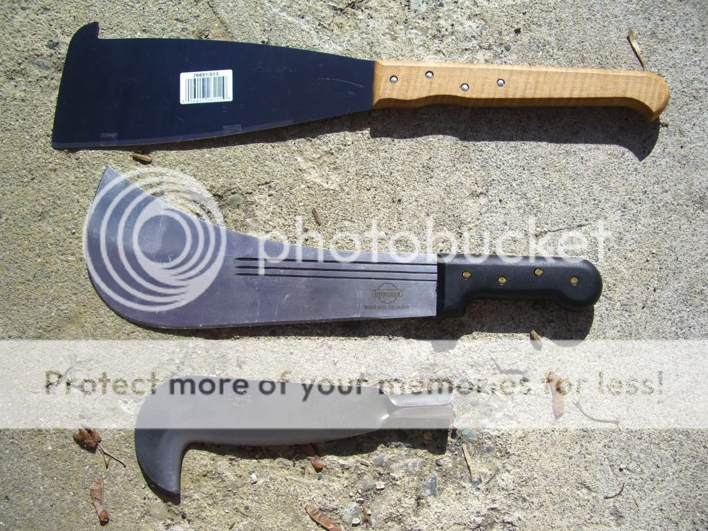

I think these ones will be even more fun to do than the last one. An Imacasa 10" Coa, Imacasa Burriquito, and a Tram two-handed cane machete.
So without further ado, here are the "before" pics! Hopefully I'll be able to get to actually modding them up sometime in the next few days. :cool:

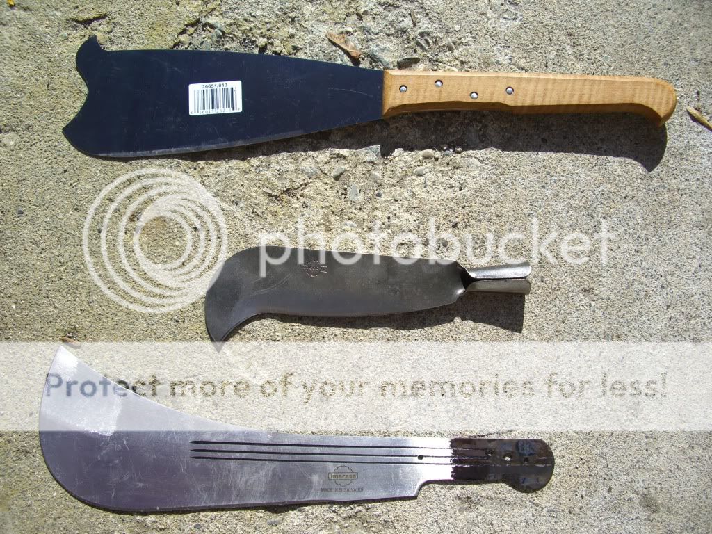

Group shot:

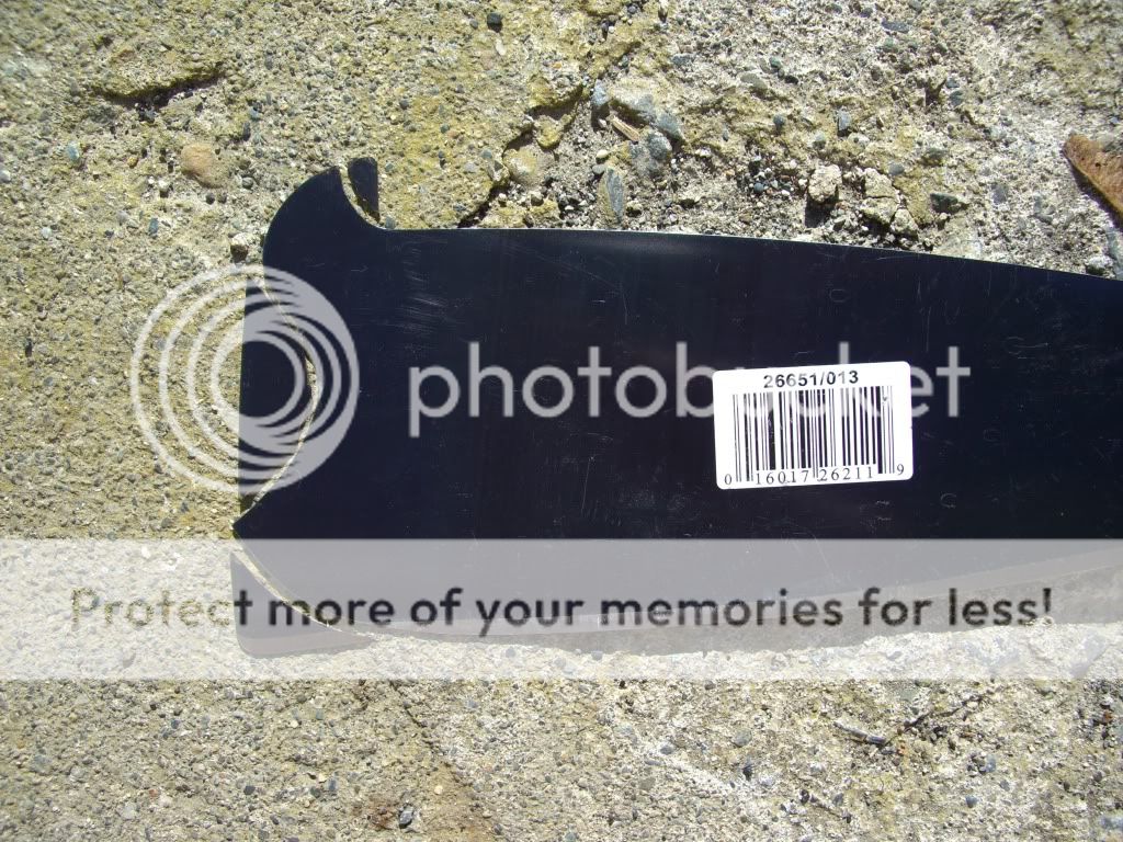

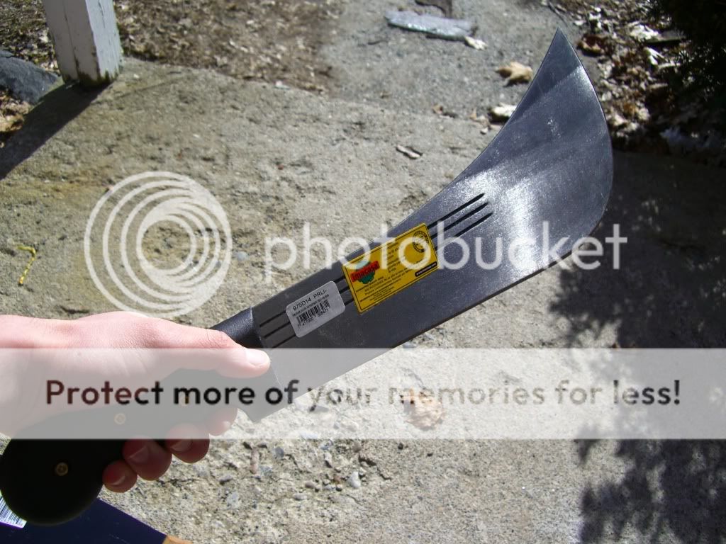

10" Coa:

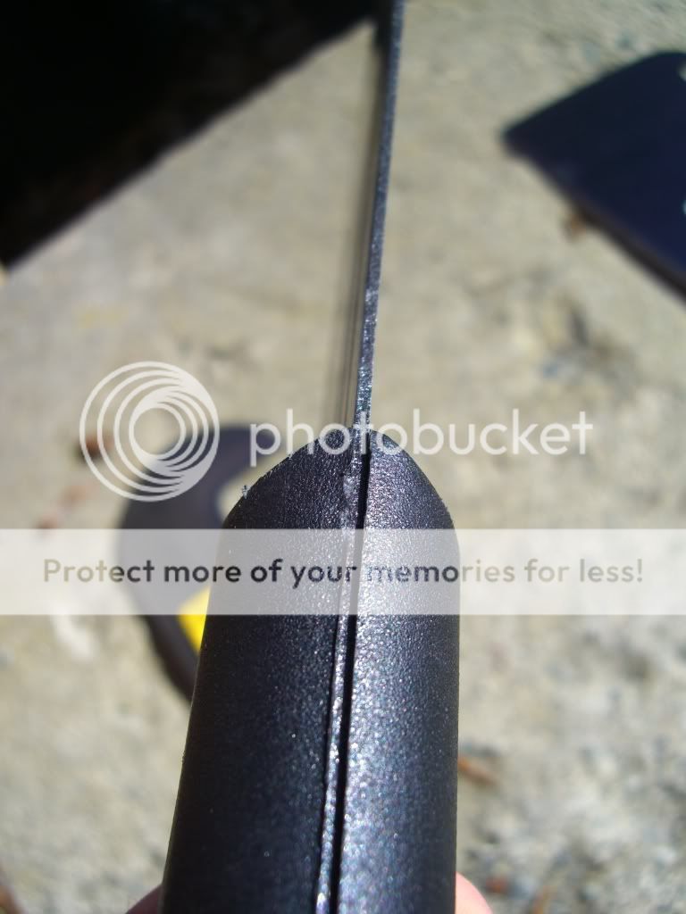

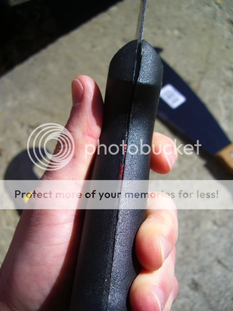

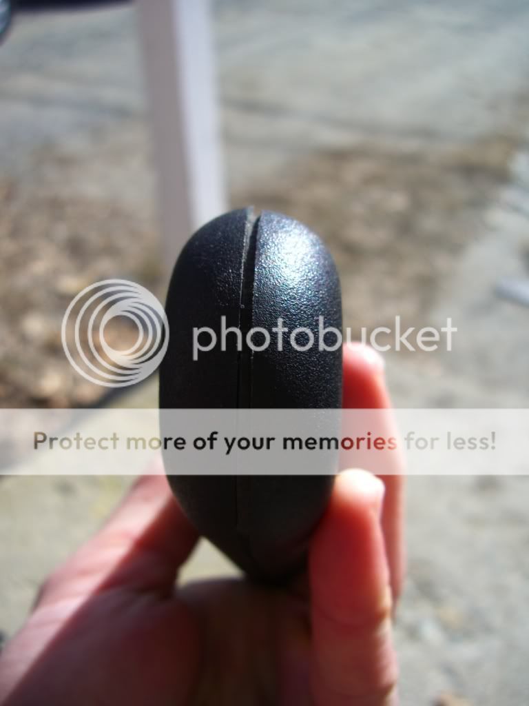

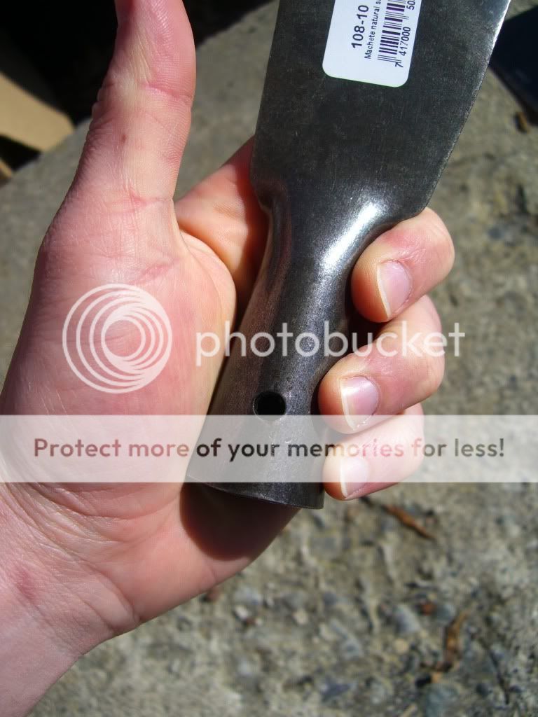

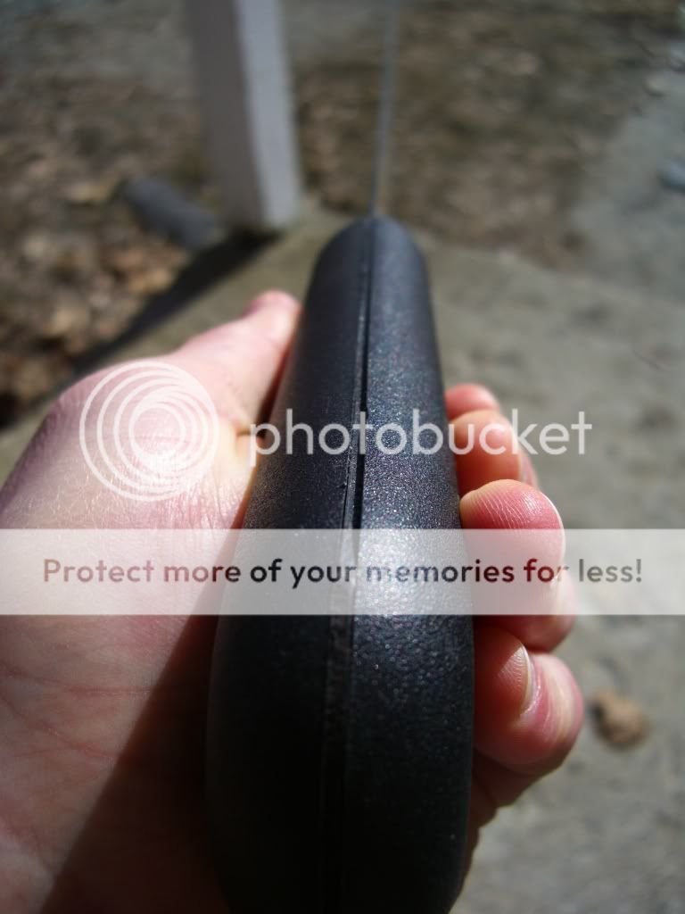

Burriquito--this thing has a REALLY chunky handle--gonna' have to fix that! :D:

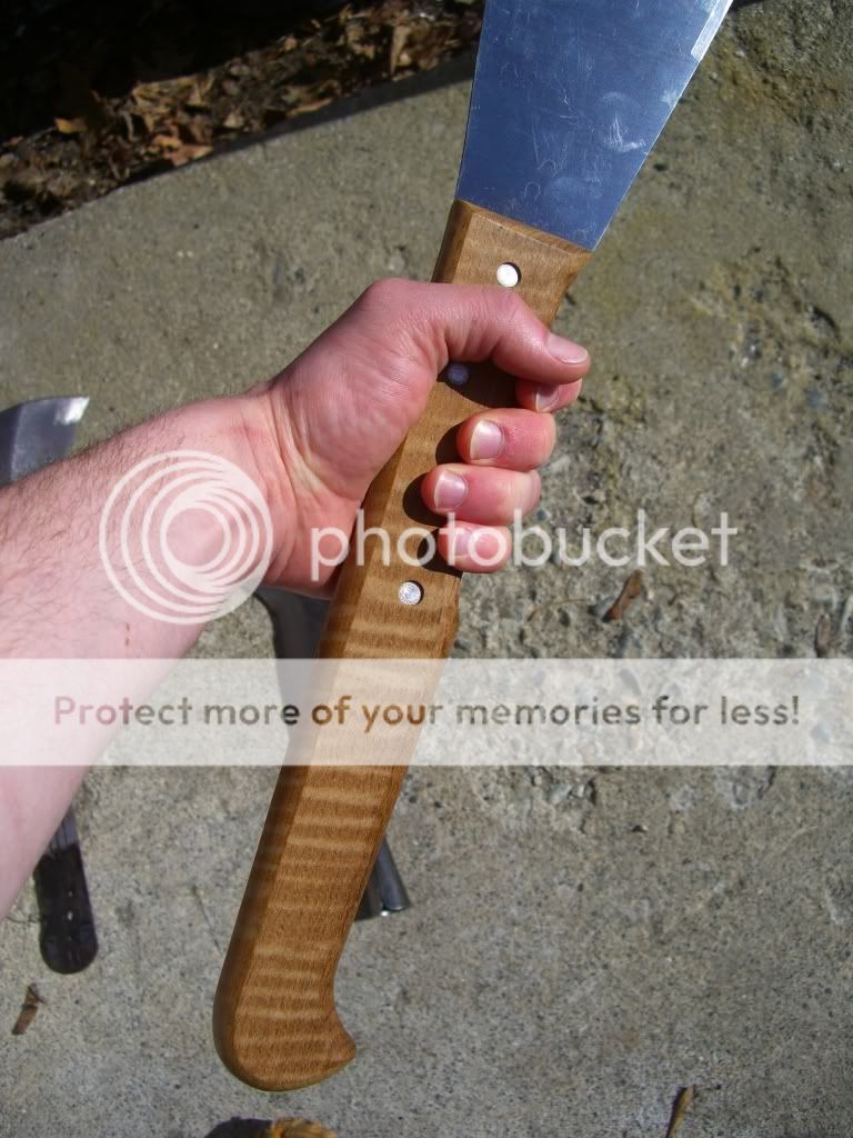

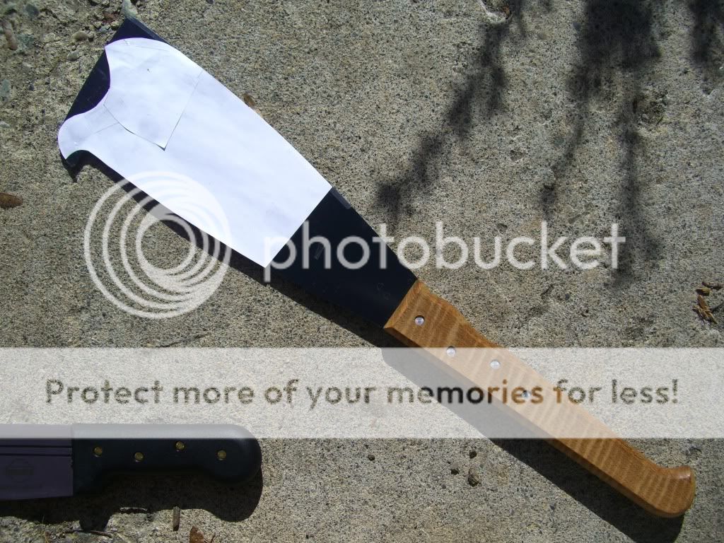

Now the Tramontina two-handed cane machete...This one will probably be the first to be modded. It has some real nice curly-grained wood for the haft. :cool::
Teaser alert! :D:

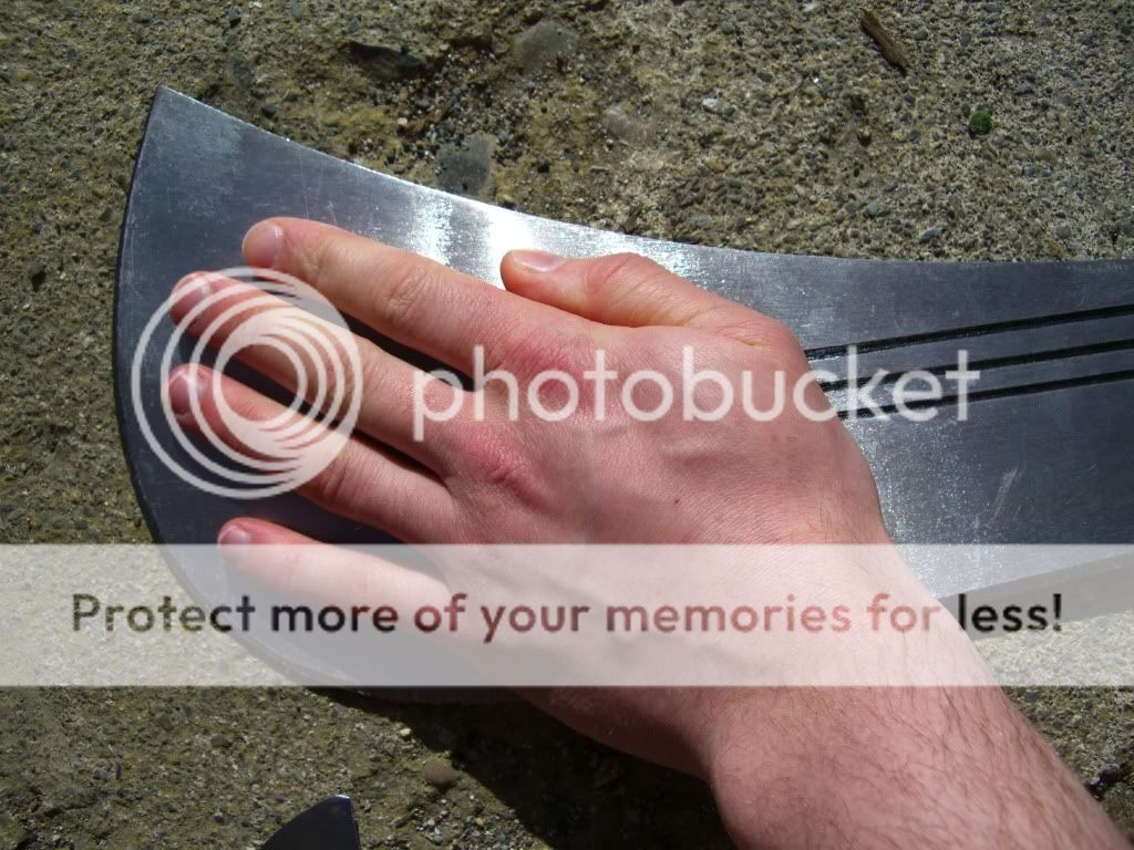

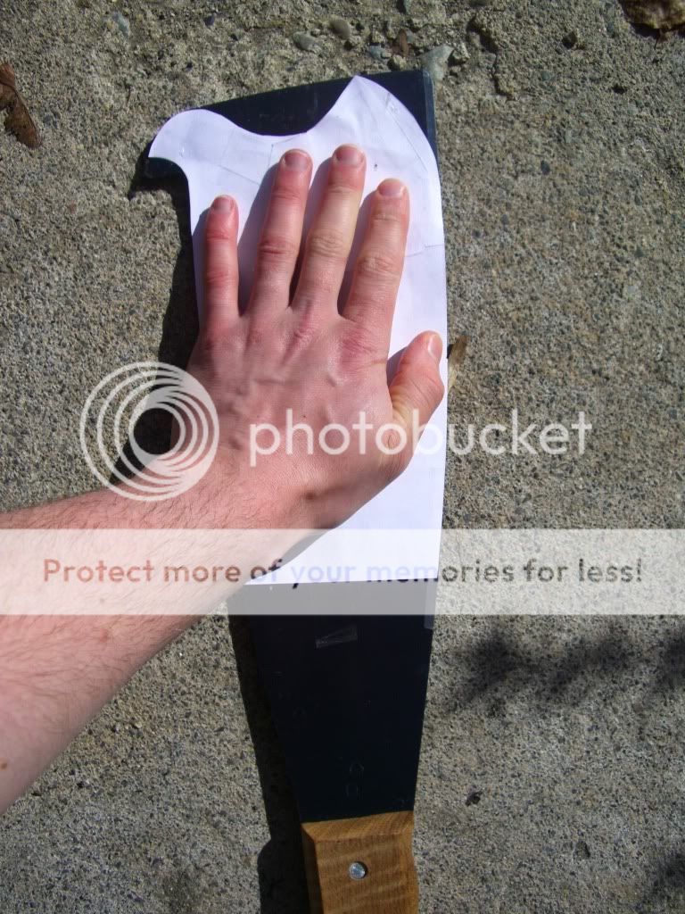

I like the broad blades of cane machetes as well. As you can see, one of the mods I plan on doing is a re-profiling of the blade shape, opening up the hook a little, and producing a functional point on the blade as well. Not only is the point handy, but there will be a crotch between the hook and the point that can be used for pushing brush out of the way without having to use your hand or bend over (particularly useful with thorny plants).

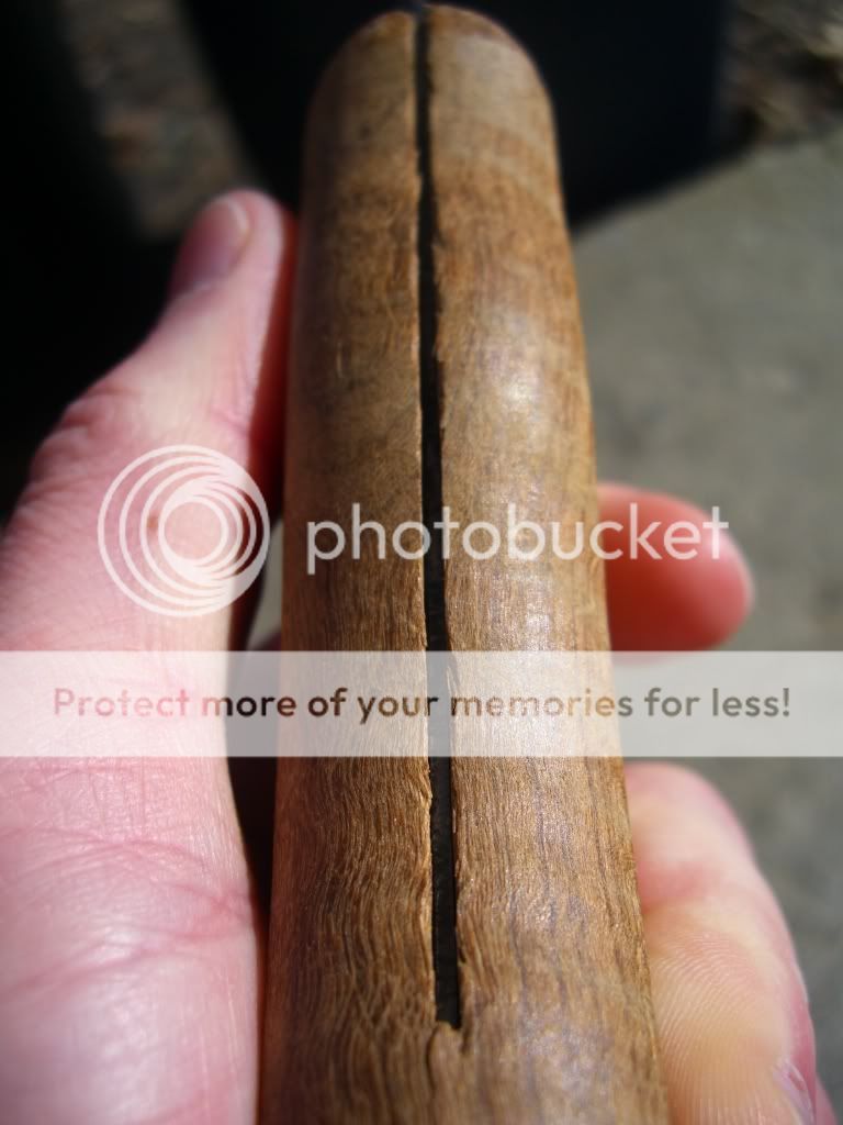

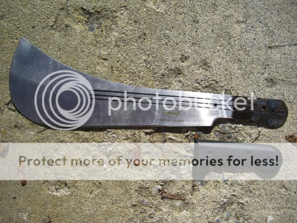

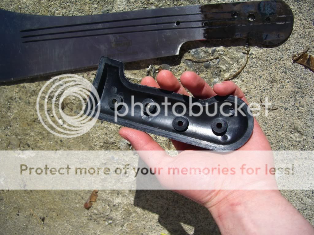

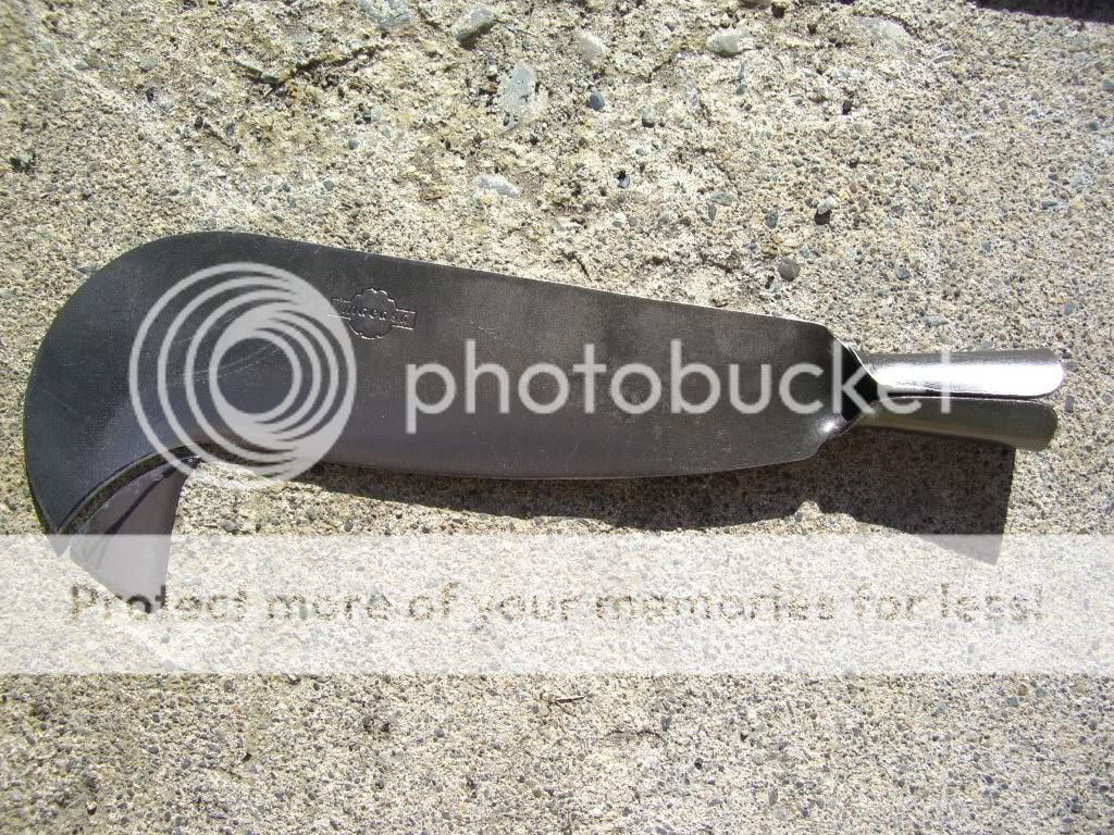

Imacasa Burriquito with scales removed:

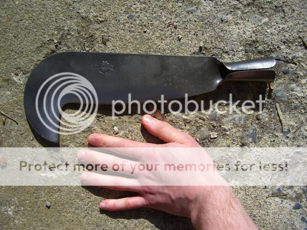

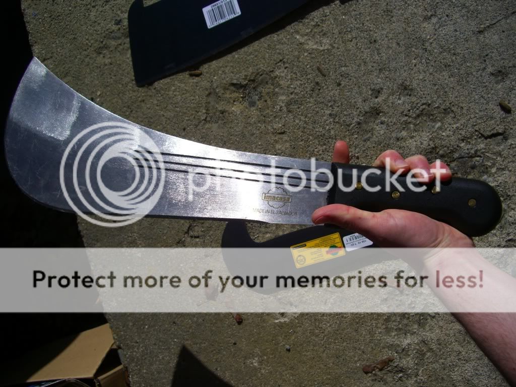

Imacasa 10" Coa with hook opened up for better clearance for general use (shown with removed section of hook for reference):

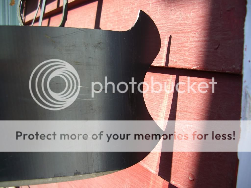

Tramontina Two-Handed Cane Machete (heaviest mods--so far--here) The hook has been opened, and a point and crotch made:

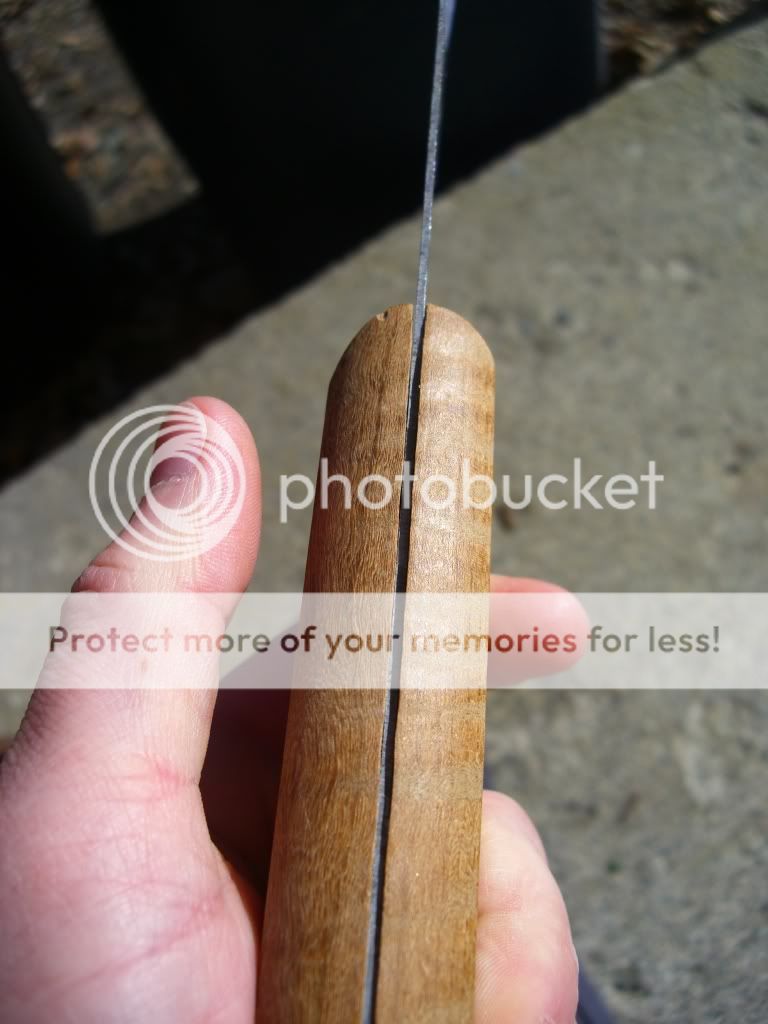

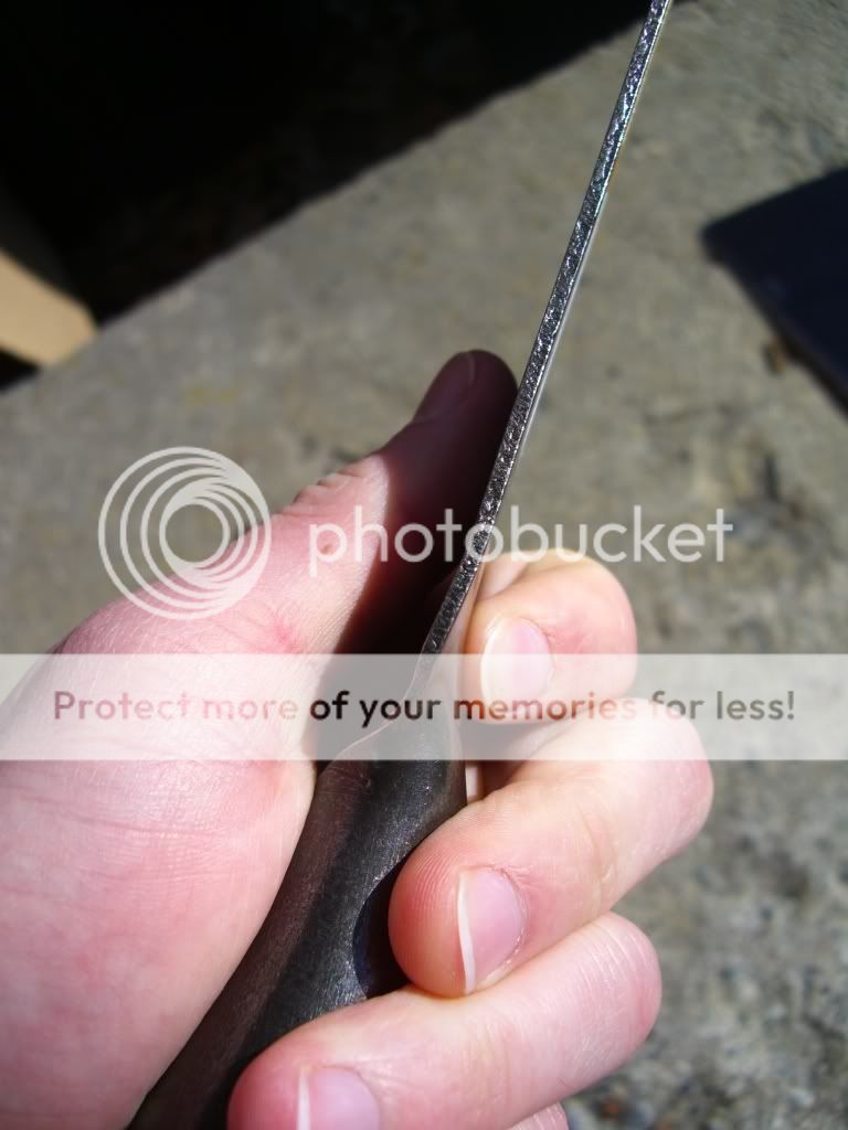

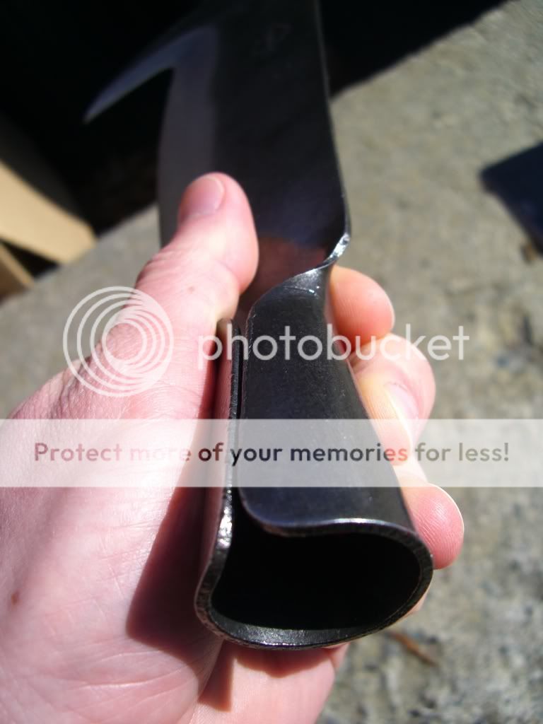

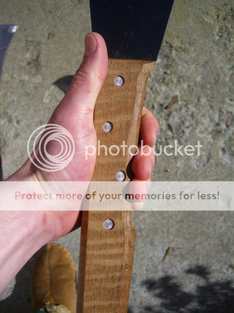

The handle reduced at the upper portion for greater ease of use in a choked-up grip:

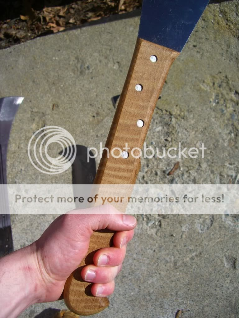

Grip shifted back for more reach or chopping power:

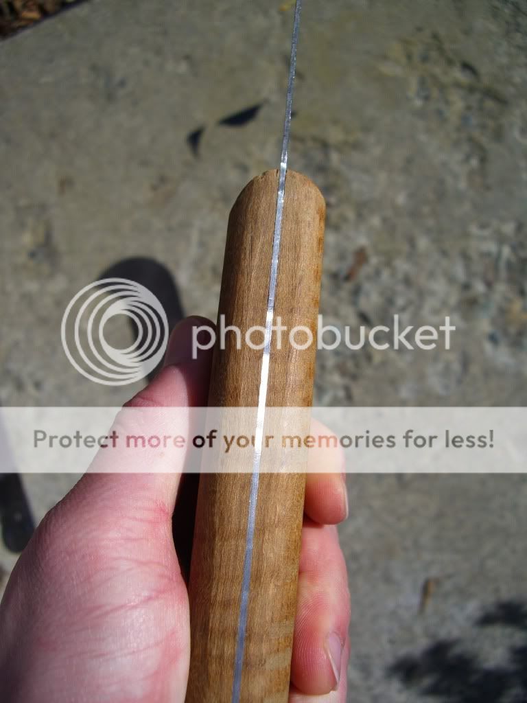

Choked up again, but showing the whole handle:

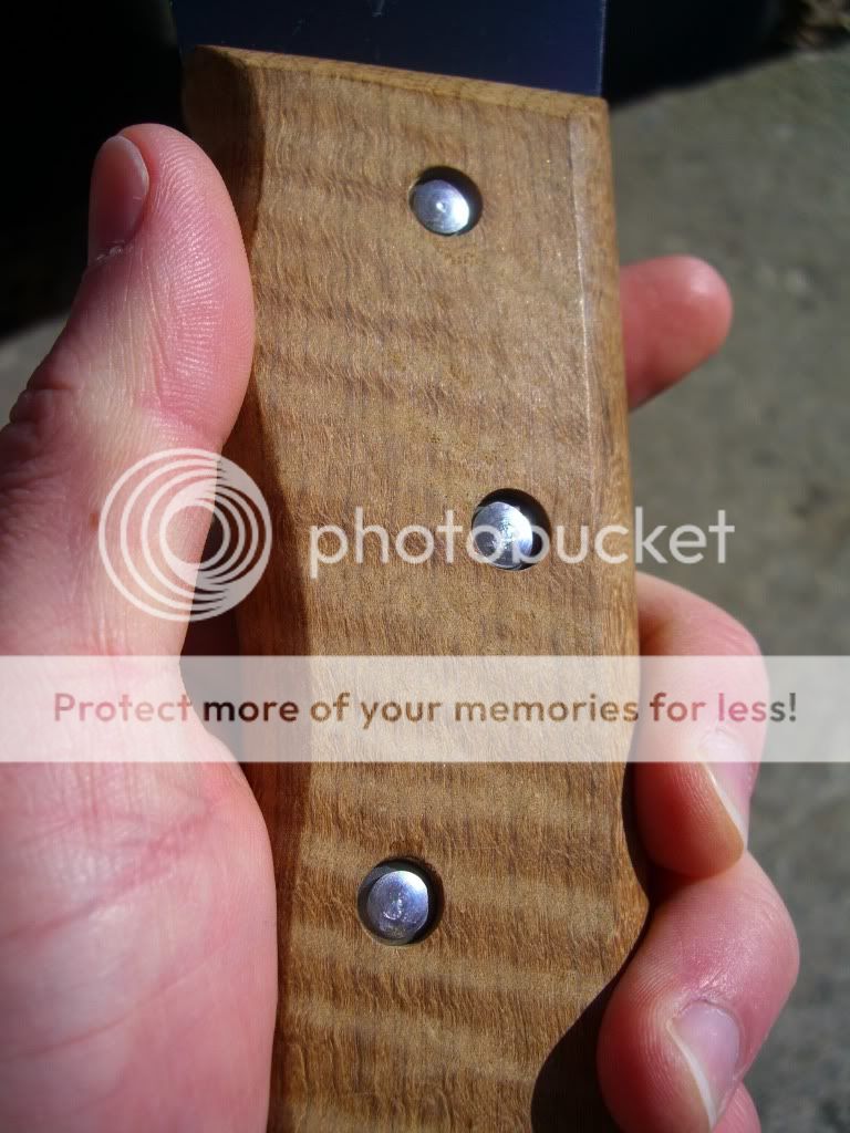

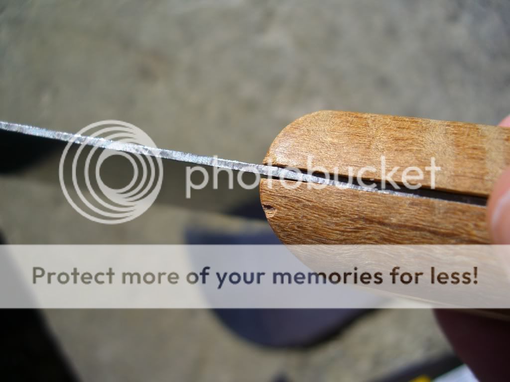

Flushed tang:

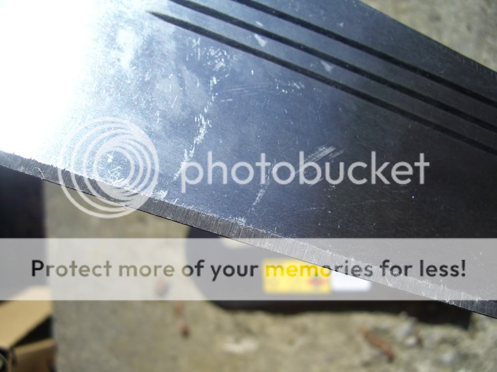

Yes! The point has clearance! You can cut, jab, or drill with it without having to angle the blade in weird ways. :)

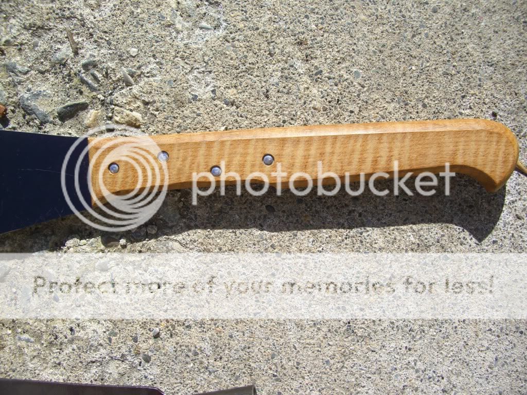

I sanded and oiled the handle on the cane machete the other night. I'll post pics later today. It's looking sweeeeeeeeet. :P
In all seriousness it's kind of turning into my dream woods chopper. I'm definitely going to get another one the next time I make an order so I can make one for myself. :thumbup:
