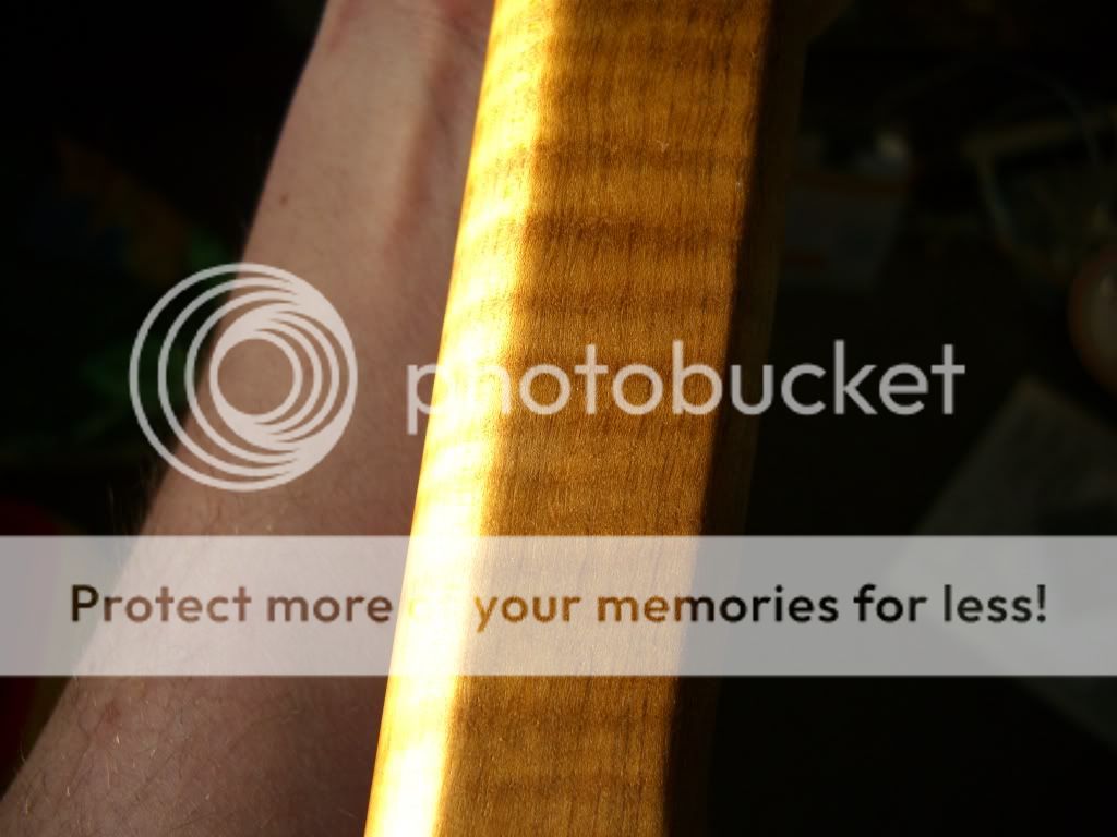

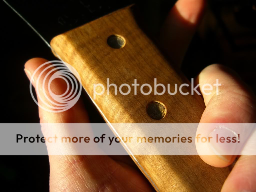

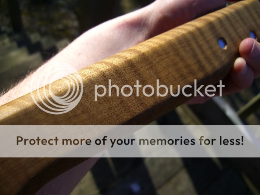

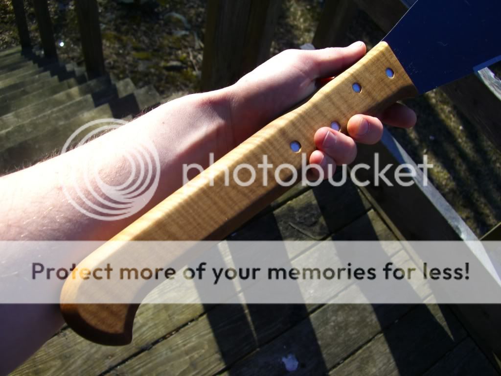

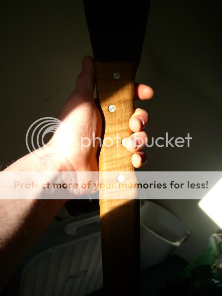

Ok--picture time! Here are a few glamor shots of the handle of the cane machete now that it's been sanded and oiled. It's really hard to capture just how gorgeous this thing looks!
It's coming along nicely! I ought to be able to get some significant work done on it on Saturday.

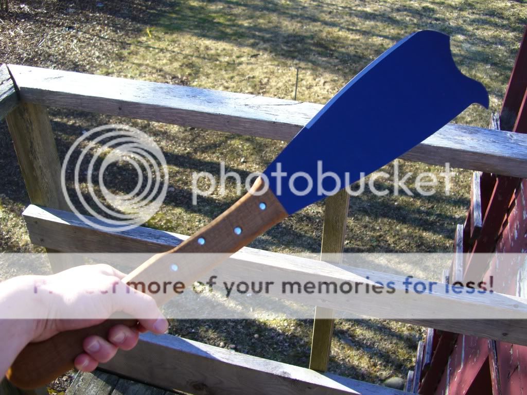

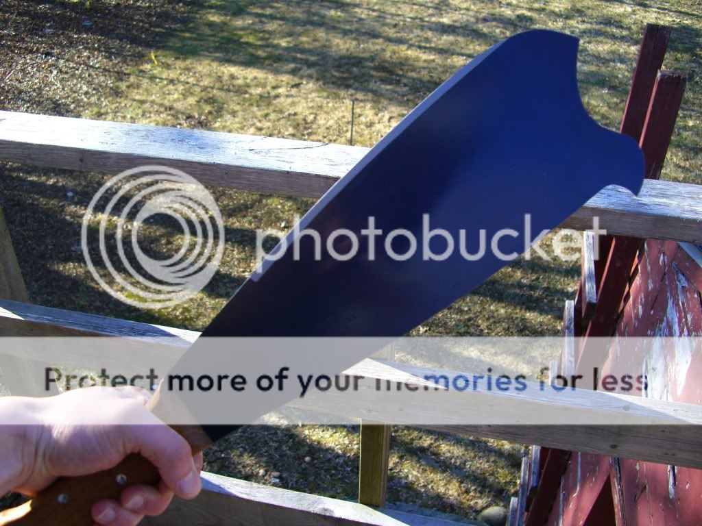

It's finally done! I finished the Tramontina up, including a light convexing and Slip-Plate(tm) treatment. Lemme know what you think! :D
Wow! That looks awesome! I never looked at much machetes before, but this one is sure the best looking so far! Is it sharpened on both edges?
I got some machete projects goin on, got a 22 inch el salvador condor that's getting Wordanized, a 14 inch bolo that's getting the RAT logo and I have 2 trams I don't know what I'm going to do with.
It's sharpened on the entirety of the primary forward edge, and the region of the hook and about 3-4 inches below it are sharpened.

Looks awesome. I can't believe how little you are trying to make off these considering the work your putting in. But I guess it's not really work if your having fun doing it. Only question I have is about the the coating on the finished edge? I assume with a blade that big your not really worried about it being super sharp?
I sharpen the edge to above working-sharpness, but not to hair-shaving sharpness. The coating on the edge regions is then lightly sanded to remove the bulk of it so it won't clog a file during sharpening. The coating wears off of the edge region quickly enough, though, so it's kind of a moot point. The coating is quite durable on the actual body of the blade, though, as it's not exposed to direct impact as much.
