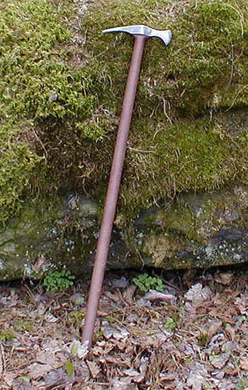

Cliff, it has only one correct spelling: fokos.
It is a Hungarian word, meaning 'backed' (axe), and it is pronounced "fo'-kosh" ("o" like in 'old').
In most cases the 'backing' tool is a spike, but historically can be a knob too. The following source has some images to illustrate this, however it is not a definitive archeological, historical web-site. It is more like a site promoting "historical" mythology.
http://www.geocities.com/Kaganate/axehung.html
Originally it was a horseman's weapon, but eventually turned into a walking/self-defence "cane".
In some 19th-20th century examples the spike is omitted,
http://therionarms.com/sold/ttoy417.html
and it resembles the Polish highlanders' 'ciupaga':
http://www.polskiinternet.com/english/info/ciupaga.html

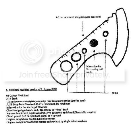

Well, does anyone own a JUST? It would be nice if someone had some experience with it and actually owned one. I am wondering as a last resort alternative. It would be nice to have a physical model so I might be able to commission one being made. That is NOT ideal and I would definately prefer an original JEB. I definately like the design. However, if the original maker is unable to supply his design, I am willing to try and commision someone else...with some minor modifications of my own specs.
I will attempt to post some pics/drawings of my ideas for the
JUST customized influenced by the recs of others in this discussion.
I would like to make the handle end have an edge shape similar to that on the end of the Floro knife handle while keeping the same rounded geometry.
Basically an edge like this...without the hole:D :
The following are what I consider very good ideas posted by Cliff on this topic:
Cliff Stamp said:
As a pure survival blade there are a few things you can add which are useful like a squared end cap for scraping and/or a similar section on the spine for a ferro rod, and a small indendation to use as a holder for a fire drill. You also might want to configure it for easy set up of micarta handle slabs, trying to do any cutting with bare tang knives get uncomfortable and slippery fast. However you best bet may be to get a fairly clean version first, do a bunch of work of various types and see what would be helpful.
-Cliff
I have been thinking about the micarta thing. The only problem I see is that part of why this would be useful is its thin profile. I could probably have ruler markings on the long straight edge too. I think a dent/pit/indendation for use in starting a fire by way of a bow and spindle is excellent and very easy....I guess this is all academic until I can get JEB to respond or find another maker willing to do it in place of JEB.

something like this:
Back of handle edge something like this (no hole):
I guess it is still an academic exercise until I can get JEB to respond (my first choice) or find another maker willing to do it in place of JEB.
The Uluchet ~ $130.00, not a neck carry.
The uluchet probably is an excellent idea. For right now, I am looking at this because of its simplicity, size, flat profile, neck carrying capacity...and ideally should be relatively inexpensive to make given its simplicity and minimal amount of steel...I could maybe go for two to start:D Besides, I hope to have my K5-tactical as my primary. This would be my easily portable back-up...leatherman in my pocket too.
Anyone got any insite on chisel vs V-ground in an application such as this?
