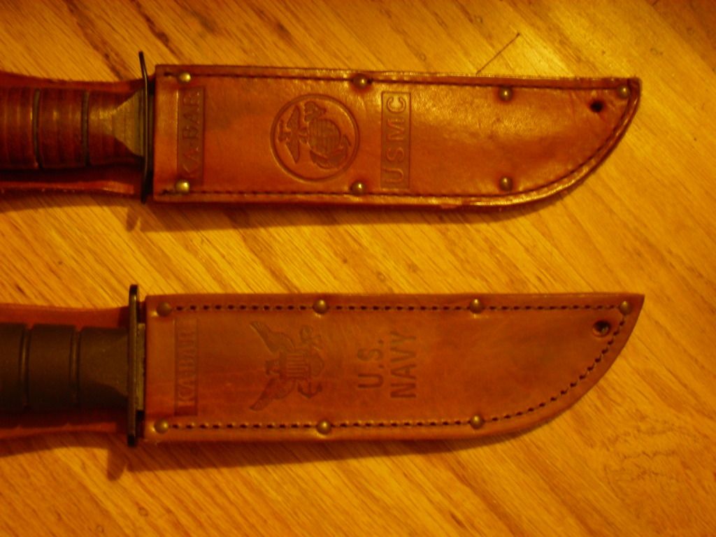

Moose: I hope this is the appropriate thread for a sheath question. I didn't see it mentioned before.
Toooj:
Let me start by saying that we love Kabar here. :thumbup: I recently got a #1217, and it's hands down still one of the best values in the knife industry today. (My son has decided that my #1217 will be his on his 18th birthday. Apparently I have no say in the matter.;))
So, on to my question.
Regarding the leather sheaths, does KABAR use more than one manufacturer? Are all the leather sheaths made in Mexico? Are the sellers who sell the sheaths by themselves getting them directly from KABAR, or from your OEM, or are they having them made by their own supplier?
Some background: I recently bought a sheath for the Kabar #1225 U.S. Navy knife. I was surprised at the difference in the way the sheath was made. The leather finish appears to have more of a matte finish; the "KABAR", emblem, and "U.S. NAVY" stampings are not as deep and defined as they are on the #1217 USMC sheath; the rivets are in different locations on the #1225 sheath; when you look at the lanyard hole at the bottom, the gusset doesn't line up - it's visible through the hole.
Pics:
I bought this sheath to use for my Kabar KBD1. The KBD1 fits the #1217 sheath just fine, and it fits the #1225 sheath as well.
I was originally planning on buying the #1225 to serve as a reminder of my navy days, but I love the KBD1 and figured I'd just get the sheath instead. A friend of mine who does leather work was going to stamp some information on it for me, but as you can see, there's quite a finish difference between the two types. I bought the #1225 Navy sheath (made in Mexico) on ebay.
Is there a way to get a sheath finished the same way as my #1217 in the photo? It seems to me that the leather KABAR sheaths I've seen always matched the #1217 sheath I have. Before I have the sheath customized, I'd like to get one closer in appearance to the #1217 sheath in the pic.

Orca,
Part of the reason with the different sheath looks is that we had several sheath makers. We have since consolidated to Atcheson/Berger so that is no longer an issue. All of the buyers buy from us not our contractor. (That is verboten)
Yes, the sheaths are made in Mexico. Berger has a very good factory there and Mexico has a strong leather working tradition. I know that USA made products are a big plus for many of you, but sometimes it is a very problematic issue for us to keep pricing down. USA Made sheaths will be probably be 3x more (or higher) and drive the price on the product accordingly. It is always a balancing act.
Leather is a natural material and there will always be variations as far as look. You can redye/oil it to change the color. That is an easy thing to do.
Hope all of this helps.

Thanks Toooj, I really appreciate all the expertise you bring to our little community.
Thanks, Toooj. :thumbup:
Since this idea was to personalize my knife/sheath combo anyway, I'll try my hand at dying & refinishing the sheath myself.
~Chris
