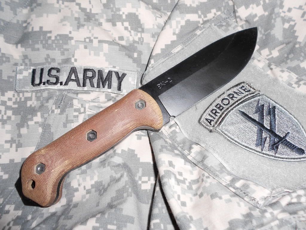

I was meaning some sort of military green grivory, OD, Coyote, Tan as for the micarta unless it has changed all mine have been tan or brown?
This one has darkened up with use.
