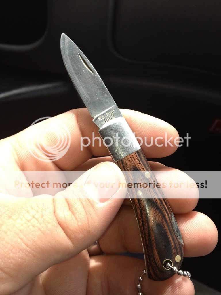

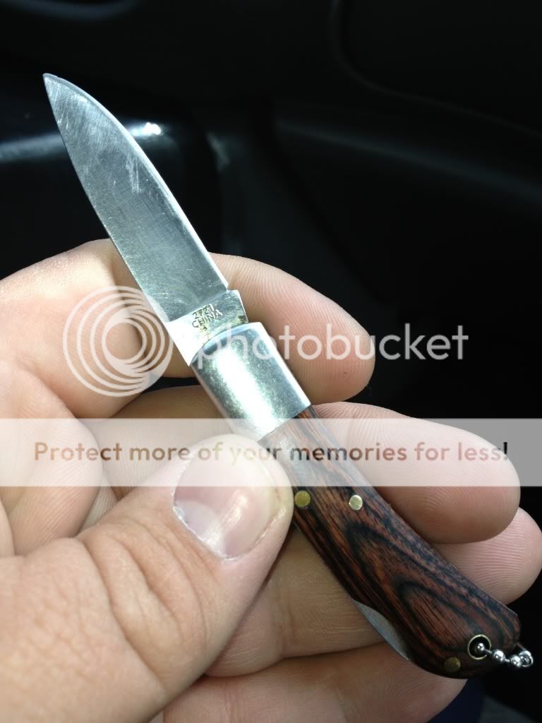

Disregard this first part - pictures posted above by Kymaedic45.

Okay all,
Sorry for not answering. I've been on the road quite a lot lately but now I'm back in the office and can take care of your questions:
1) kymedic45,
You have a model 2721.That was the Ka-BAR International line. We sold that from 1999-2006. Not one of our better moments but Alcas (now Cutco Corp) had just bought KA-BAR and we were trying to quickly expand the line with some fast product intros until we could get more designs into production.
