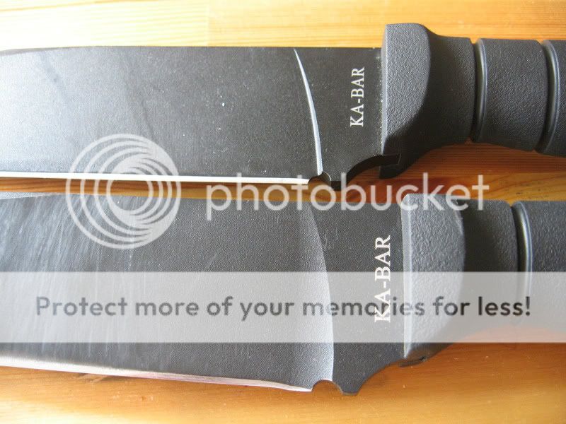

As for the new grind near the choil:
The upper grind is the new version, the lower one is the old version. In the new version the choil actually serves a purpose when sharpening the blade whereas the old one wouldn't allow that.

Okay...Yeah, The running shoulder. The contractor changed to a plunge grind to make the grinding operation easier. Running shoulders are difficult to grind consistently both side to side and also knife to knife. Also, as you mentioned. It's easier to sharpen the edge all the way to the choil. IIRC, we did that in 2008/9. I'm getting old so I need visuals to jog the memory.
