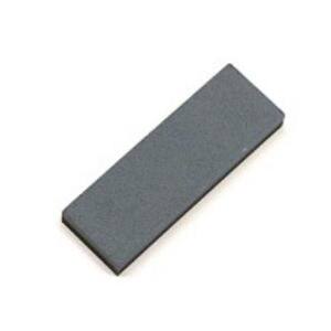

I actually wouldn't be surprised if the HD 'Norton Economy' stone is aluminum oxide. Most cheaper synthetic stones are made of it. And AlOx can be found in a variety of colors, some of which will look a lot like the black/grey SiC stones.
Looking at a .pdf copy of Norton's catalog (link below), the 'Economy Tool & Knife Bench Stone' in either 6" or 8" sizes, are both listed as aluminum oxide. These are Norton part #87933 (6") and #87934 (8"). Norton also lists a 'High Quality Tool & Knife Bench Stone' in similar packaging (shrink-wrapped card), part #87935, which is listed as a Crystolon (SiC). I'm assuming 'High Quality' also implies it's a little more expensive than the 'Economy' stone. Searching the web for the SiC stone, Norton part #87935, shows pricing in the $20-$25 range, in most places (compared to ~ $6 for the #87933 AlOx economy stone).

All of these stones are listed in the 'Retail Packaged Sharpening Products' section of the catalog, which is the very last page in the .pdf file. The pic below is a snip from that page, showing (from left to right) the 8" economy AlOx, 6" economy AlOx, and 6" SiC 'High Quality' stones, in their retail packaging (you can see how the SiC stone appears 'blacker' than the AlOx stones, which look more 'grey'):
And, looking at HD's site listing of the stone they sell, it's listed as MFG Part #87933, which jibes with the above-mentioned 6" economy stone in aluminum oxide. The corresponding HD store SKU# is 823691, for this stone (pic below, linked from HD's site description).
