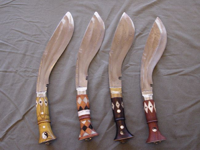

I saw the mention of Osage Orange for khuk handles, and I wanted to mention/humblebrag that it has been done, and works great. See the YCS on the left below. Around 2004 IIRC a forumite sent some special woods to HI in Nepal. I believe there were two of these Chiruwa YCS come back, and I was lucky enough to get one.
Oh.my.god...those YCSs!! :eek: EMS!!! Nah but for real, the second from the right is by far the best one I've ever layed eyes on
For what tiny bit it might be worth I'm partial to the Osage Orange one myself. I like a little natural wood to show through.
I still have a piece (getting smaller) of Osage somebody send me years ago to make pistol grips. I made a matching set for him and his son.
Enough left over for a few other projects as well.
Nice stuff.
That's a beautiful collection of YCS's. Love them all truth be told.
Thanks for posting those YCS's. I am partial to the Osage one myself but all are every nice. It does make some beautiful knife handles btw. I have a piece of limb I polished out for a flint knapping tool that is gorgeous. I thinking i may polish out my bow the same. Pretty stuff.
If you decide to rid of some of them seed pods let me know. Maybe we could trade something. I have the opposite problem. Plenty of land but no osage trees. They supposedly grow well around here. I just havent seen any in my area? Might help if I knew what they looked like tho:D
Well twist my arm to talk about YCSs :D
SingleGrind said:
Oh.my.god...those YCSs!! EMS!!! Nah but for real, the second from the right is by far the best one I've ever layed eyes on
That was one of the first two chiruwa-YCS to reach Uncle Bill, from October 2002. Made by Sher. The blade was a little bigger than the usual YCS at that time, but the chiruwa handle and the very dense wood made it stay in balance. I found the old sale post and remembered I was calling it the YCSi (i for "improved"). Wood is still a mystery, possible rosewood. Soon after those came in, HI stopped making the YCS for a while because the kamis were making the blades too thin and there were some failures.
Those are beautiful!! Nice grain on far left, my favorite would be with larger inlays on right.
The far right was the first one I got, my wife bought it for me after our engagement in 2001. Sanu was the kami. Dan Fletcher later worked on it for me and took out some of the ripples in the blade, and built a really nice kydex scabbard. It's now my favorite user. Most of these I feel bad using since they are so nice.
The two on the left were from the great YCS special order which was 2004(?). Forumites paid in advance for the YCS production to be started up again, with blades made to Yvsa's spec so they would be good. There was maybe 24 coming in two batches. I ordered two, and was lucky enough to snag the osage orange one in the first batch, by Kumar. The others were heavy versions similar to the 2002 chiruwa one, with heavy dark handles. I saved my second pick for the second batch since I would get to pick first, and I hoped there would be something as cool as the osage orange one. Sure enough, the second batch had the checkerboard inlay done by Sher. You would not believe how good all those inlays are fitted. I have that one marked as osage orange also in my inventory, but I'm not sure if that is correct.
