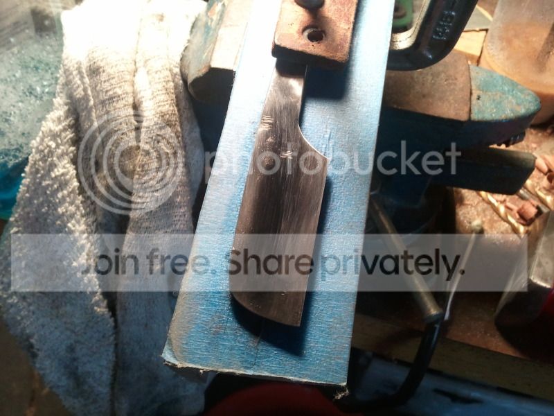

Well with a big heat wave headed my way, projected 6 days of 100+, I sure didn't feel like sitting in the shop hand sanding on the Dixie straight razor I'm restoring. So instead I decide to sit in the shop at the grinder. I just recently learned about Japanese straights, Kamisori razors, and not having the money to even pay attention right now I figured I would try my hand at making one! They can't be all that difficult, right?! So I grab my last 10" bar of 1084 steel, look up what some typical dimensions for these things are and scribble out two razors on this one bar. Since I didn't feel like hand sanding I guess using a hand hack saw to cut these out was a better idea, NOT! My bandsaw is down right now so I guess that's the way its gonna be.

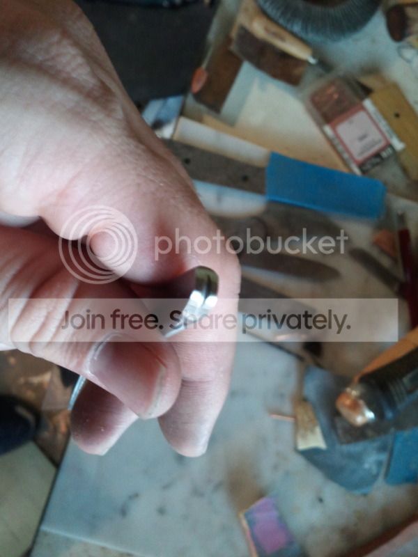

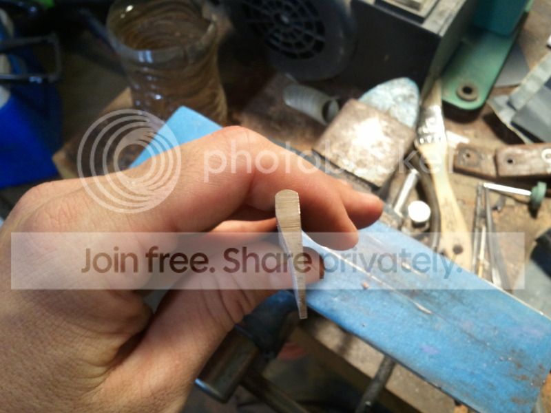

I did some quick math to determine the height of my grind for this thickness of steel, 0.188" and 15* edge equals a 0.7" high grind. Mark the blade portion and start rough profiling. Then go to the 2" wheel and a #40 blue Zirc belt and start making sparks! That's where I'm at now, I haven't done the Ura side yet, but while my hands regain feeling I am getting ready to. I hope I have my terminology correct, the Omate is the short ground side and th Ura is the large shallow hollow grind, right?
Well, here are the pics. Please do comment good, bad or otherwise. No one ever learned from continual 'atta boys'!
All comments welcomed.
-Xander
Don't worry there is still plenty of time for me to screw this thing up! I puckered at both ends as I started to grind the Ura in and ended up going up over the spine a bit and thinned it out more than I would have liked. I think I salvaged it for now, but like I said, I got two blanks from my last bar of steel. The other one waiting patiently for its turn.
Pics!
Again, all comments and critiques are encouraged! I'm a big boy, I can take it.
-Xander

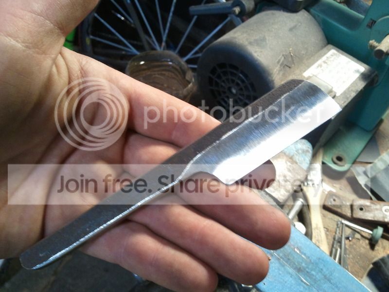

Your rough hollow in the first pic looks good. I'm not familiar with these type of razors, so this should be educational. I shave with a straight, maybe one day I'll follow this wip and make myself a Japanese style razor to try. Keep it up!
Thanx Salem! I must confess, this is my first ever hollow grind and I am doing this on a stock HF 1x30 grinder! Just some things a disc grinder can't do. I have yet to shave with a straight, but I do use DE razors and traditional wet shave. I just restored an old beat up W.R. Case straight, got it shave ready and am now polishing up the ol' brass balls before I can muster up the nerves to try it!

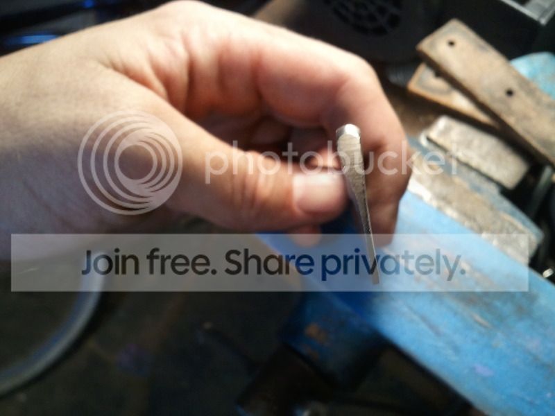

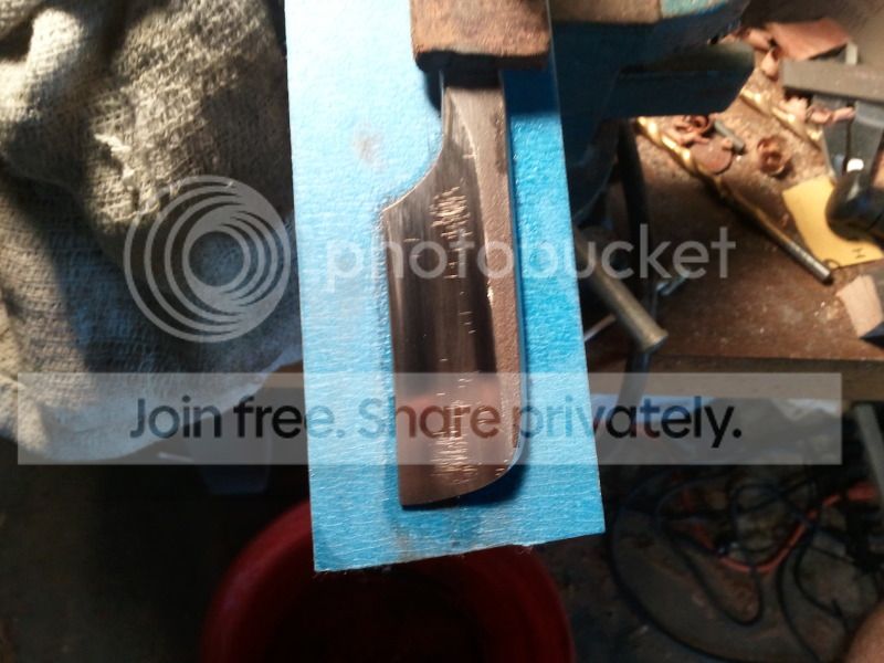

I did fix the Ura and the spine which now looks MUCH better now. It also thinned out and brought the edge down close to my target pre HT thickness of .030". I also did a little massaging to the profile for some syle, the straight spine was just too harsh and I tapered the tang a little.
-Xander
Well I have finally gotten back around to this little project. Getting ready for heat treat now.
This side will be ground post heat treat so I didn't do too much work on it, just a quick 320# finish
Still sanding this side to 400#, getting close...
Got the edge/spine geometry pretty much finalized for honing...
I added just a small groove to the end of the handle for some detail, I may do some more file work...
So its pretty close to heat treat, I will mark it cold before heat treat as well. Again, comments and critiques are encouraged.

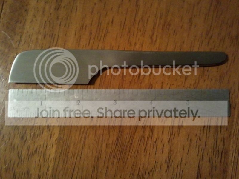

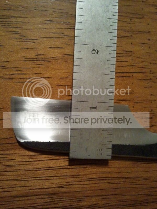

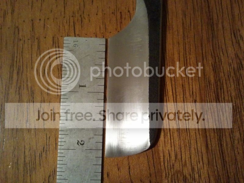

Here are the measurments as it sits now...
6" (152mm) overall
2.125" (53mm) edge
6/8 grind 15/16 avg. blade height

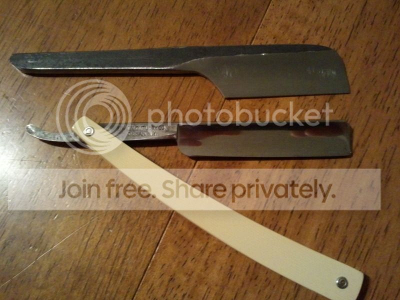

Compared to a Union cutlery Spike razor for size reference.
It balances right on the thumb in a comfortable grip, right about in the middle. It does not feel weighted on either end and handles rather neutral.
-Xander

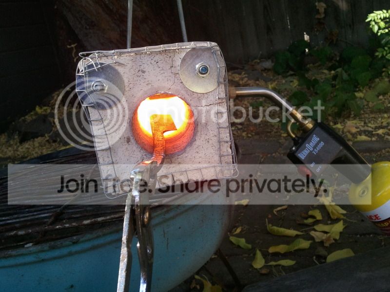

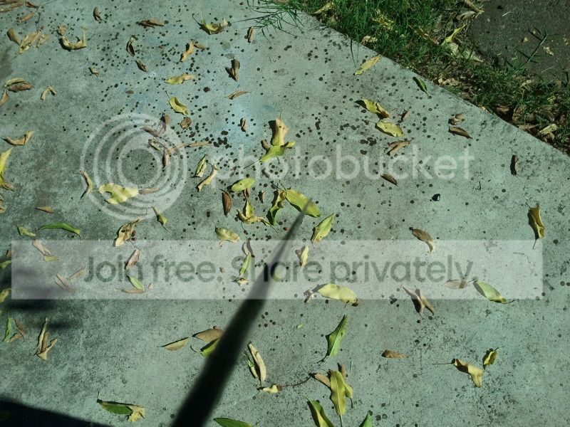

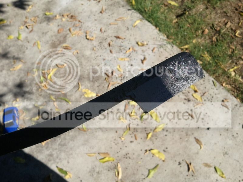

Well today I had set aside to heat treat this kamisori. I tweaked the grind and geometry a little bit and kept playin with it, but said enough is enough. If I didn't do it today I was just going to keep putting it off.
PICS!
Here is the final shape before heat treat, rough ground to 150#.

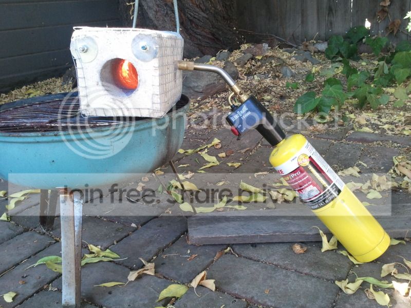

My little two brick forge.

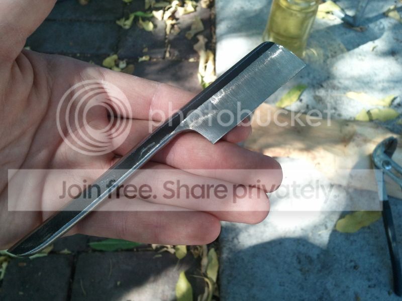

After letting the forge warm up I put the razor in and watch the edge to keep from overheating it. The beauty of 1084 is that it is the eutectoid steel, get it non magnetic plus a litte bit more and quench. No soak times, no temperature ramps.
I also did a couple runs to forging temps so I could bend the handle up a litte bit. I ground a small hump back into it which after bending flows real nice.
You can see the humpback from the first pic is now nicely blended in to the curve of the handle, this is fresh from quench in 135* canola oil.

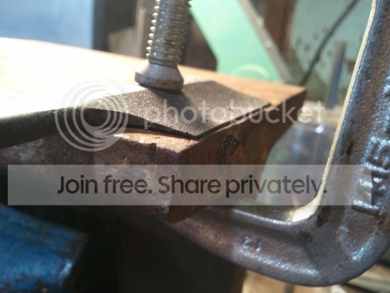

I got a slight bit of warp in the blade, fortunately it wasn't just the edge so that is easy to take care of.
To get rid of the warp I clamp it to something flat and temper it. It will come out during the temper.

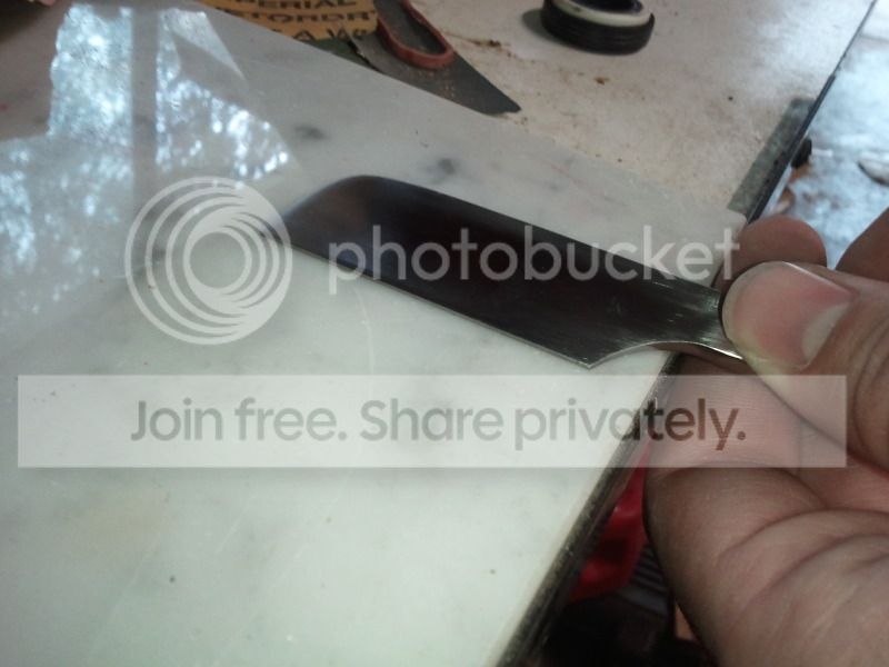

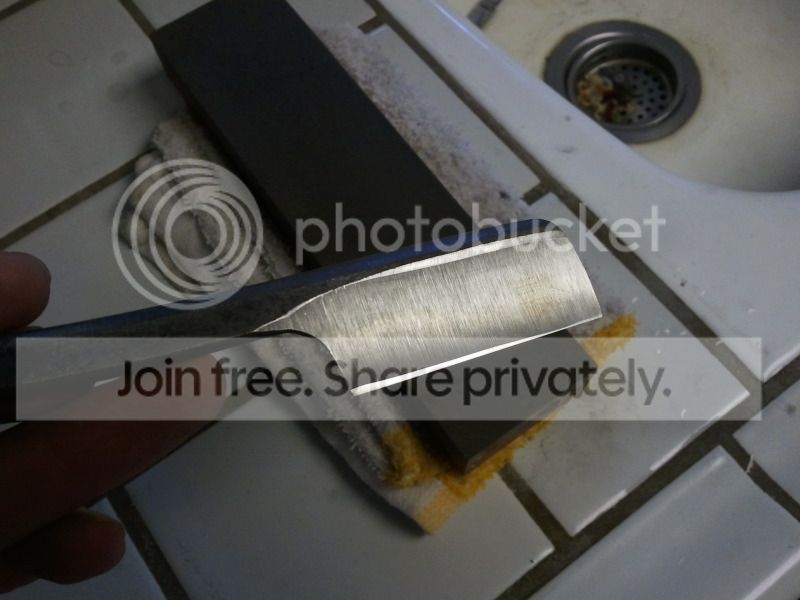

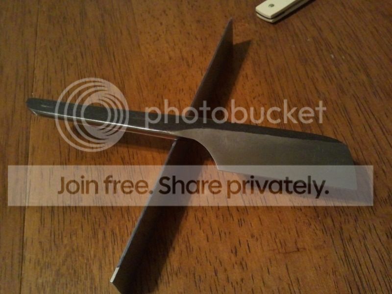

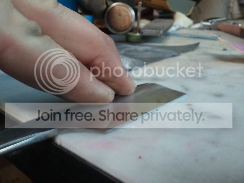

Ok, so I convinced the wife to let me sneak out to the shop for a bit more this afternoon. I got some post HT grinding done, still have some more to go.
Preliminary grind...

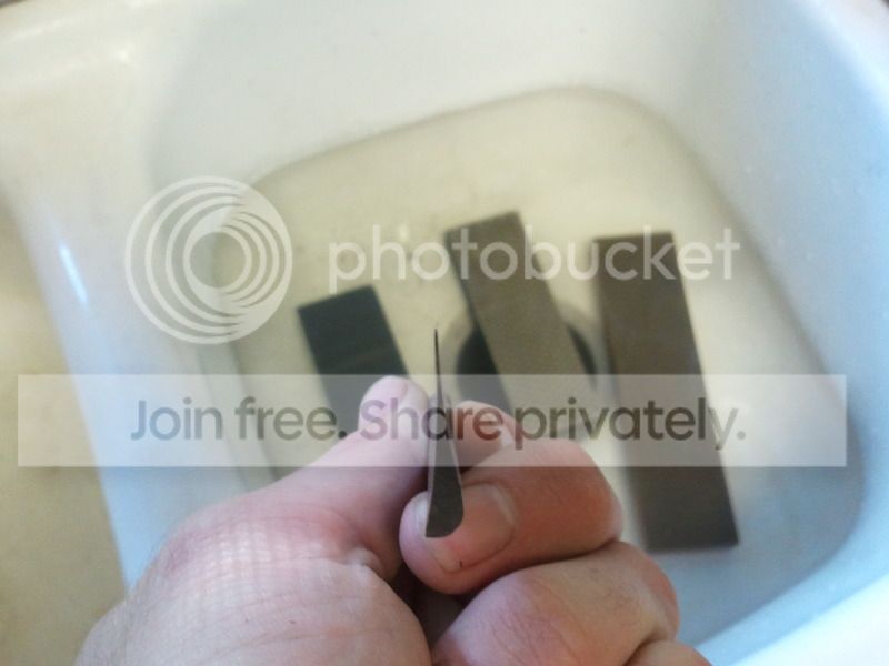

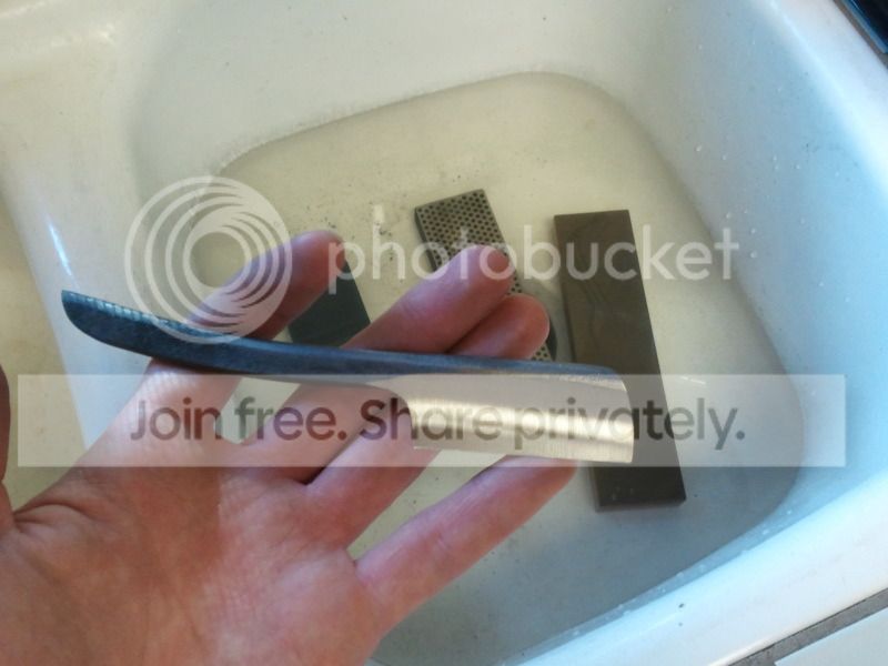

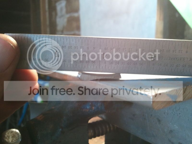

Edge thickness after preliminary grinding...

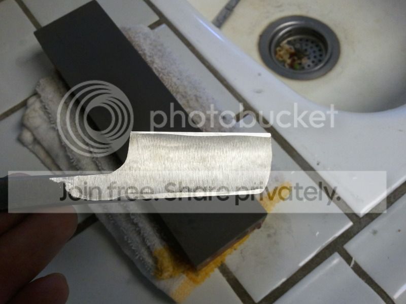

I put it to a stone to check my grinding and how straight it is. Looks like the center was a bit high on the spine and my edge is twisted just a bit.
The other side is looking pretty good right now, it will need a touch of grinding to even it out but looks good for now.
Hopefully I can get back to grinding tonight after the boy goes to bed. With the edge getting this thin I litterally can only grind for 2 seconds before I have to dunk it in ice water. Maybe if I utilize my shop time efficiently I can shave with it tomorrow morning!
