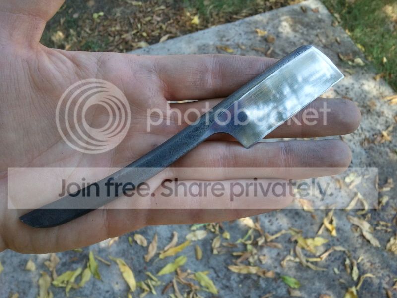

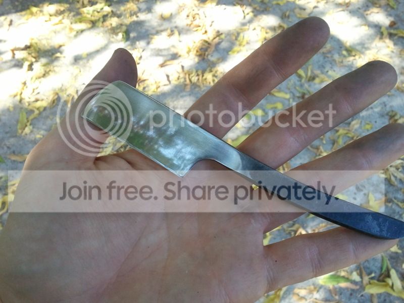

Thanx! I figured out real quick, the hardest part about a hollow grind is the first half dozen passes. Once ou get the initial channel cut in, the wheel just falls into place and you just keep it going back and forth. I also found I have to grind on top of the wheel so I can see if I have the blade at parallel to the weels axis. That's how's I ended up with a twisted edge, I was grinding low on the wheel so I could see the edge and I had it at an angle.

Ok, so ginding this thing is done in small increments, I really have to concentrate so once I begin to get distracted or the wife starts bugging me I just stop. Now that I have an actual kamisori to compare I realize that the edge angle is larger than I thought, the traditional comes in right at 21* inclusive. This one is right around 15* inclusive, I know this kamisori will have all the audible experiance a full hollow western straight has.
Update pic, its getting thin! 150# finish now, thinning out the edge and straightening it as well.

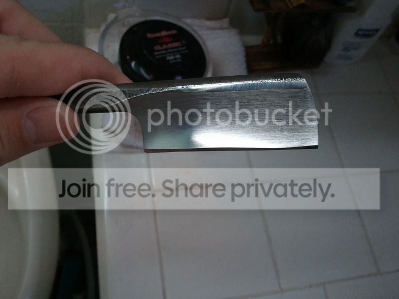

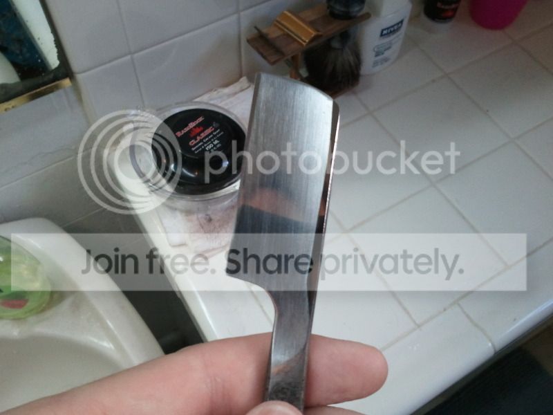

Well folks, I got the handsanding done, 220# finish and buffed with black compond on a loose wheel. I like the satin finish this leaves. I am sharpening it now, working on the final grits. Bevel was set with a Norton IB8 combo India stone just to the apex. Then I switched to films, 600, 800,1000, 1200, 2000, 4000, 6000, 12000 then to CrO2 loaded balsa strop and then on to leather and newspaper. I have a large granite slab I use as a surface plate for my sanding films to keep the edge flat.
This razor is closer to an asymmetrical grind western than a traditional Kamisori. I didn't realize that Kamisori are ground with a largr edge angle, so this one comes in at ~15* and is a half hollow grind done free hand. It is suprizingly noisy! Hopefully I can get a nice smooth edge on it, too. Honing this it isn't necessary to alternate 3:1 or 10:3 or whatever else, it is made of mono steel construction and fully hardened to about 58-59 Rc so spine wear will be like a western on both sides.
Ok, here is the edge! I still need to finalize the edge just a bit more, but I just completed a test shave with the razor! It was smooth but not as sharp as it could be. Hopefully the owner has better honing skills than I do! I will work on it a bit more before I box it up to send off.
