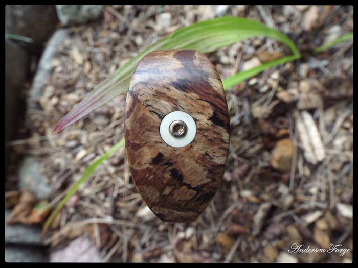

Is that finial seating against an internal step in the walnut handle?... or do you use some sort of washer in there?
Erin
I insert a steel "receiver" in the handle to which the finial shoulder seats.
The owner can disassemble and reassemble the knife while fully tightening the finial with no undue wearing of mating parts.
Erin
This is not that knife, obviously, but will give an idea what I did.
The finial itself is recessed into the handle material about 1/4" and the butt of it is threaded 2-56.
Then covered with ivory:
