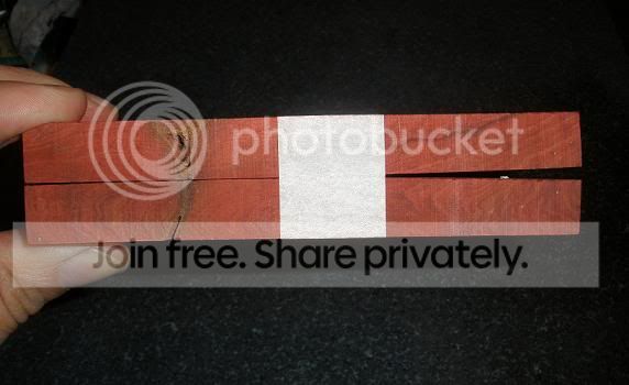

I just received a set of scales and am not sure if this problem is worth dealing with or not. The scales have a but of a curve in them. Now the only scales I've actually put on a knife so far have been micarta and they're naturally rather flat. I'm squeezing them together here so you can see the amount of bow that's in them. looking at them not squeezed the ends don't sit against each other so they're bowed in the middle basically. Is it worth trying to sand these flat? I was thinking if I did I don't know how thick they're gong to be by the time I'm finished. They're 3/8" now and I don't want them to be too thin to work with after I get them flat.
What say you guys? Keep them or return them for a refund?
You should be able to sand those flat and still have plenty of thickness.
Alot of scales don't come flat. Maybe they should but even then, they might not stay flat. I'd just flatten them and not deal with back and forth shipping. Just my opinion. Good luck which ever way you go.:thumbup:
if you have access to a mill you can do what i do. i put mine in a mill and take off the high ends and work my way close to the middle but not all the way. once i do that i flip them over and clean up that entire side which becomes the bottom side. final shaping takes care of the other side.
Quick pass on the sander will flatten those out, with plenty left over. Might be more concerned with those cracks, unless they're just on the side?

I don't have a mill so that's out. The voids are basically just on the sides I was just more concerned about the bowing.
Um.... turn them over.....
Matt, Bill gave some good advice here, at least the way I understood him. When you look at the scales and it is shaped like the letter U, turn them upside down and leave them sit for a while. A lot of the time they will even out on their own.
The scales moved because moisture was escaping from one side of the scale quicker than the other and the ends curved upward.
After they settle a bit flip them again and leave for several hours, then flip again. They should become flat enough that you will be able to true them up on a granite slab by hand with sandpaper. I would wait on truing them up until you are ready to use them. When you finish them be sure to give them a good finish sealing all exposed surfaces to prevent any more movement.

What kind of wood are they? Redheart?

Damn Mark you should get into the wood business as a profession ;). Yep Redheart they are. IT's a farily hard wood from what I understand so I can do something like a CA finish on them was what I was thinking.
Really... they will usually flatten out after a while? I know you are the man when it comes to this stuff, so I'll give it a shot. God knows I probably have enough wood to last me a few years so I can be patient with letting them sit.

That's not bowing at all. Bowing produces a radius type curvature. Could be the photo angle, but the spaced end just looks thinner than the tight end. What is the measurement exactly? Snipe happens, but should be flattened by the producer. Problem on very inexpensive wood is labor eats up all the profit. Comes under the heading of getting what you pay for and sometimes less.
If you're meaning the measurement between the gap at the other end it's 3/16"
No, I mean the actual wood thickness. It appears from the photo the end with the gap has thinner wood . If so it's called snipe. Bowed scales produce a curved gap in the center. Is the wood thickness the same at both ends?
I would just sand them flat. That's pretty easy to do. I wouldn't turn them around though. Turning them around would miss-match the grain and wouldn't look good, IMO.
Larry they're a 1/2 thick at all ends. Maybe it'm going crazy but I've had them turned over since I read the idea. They're still not perfectly flat but it appears to be a bit of an improvement.... Is it possible to have that happen in about 2 days?
